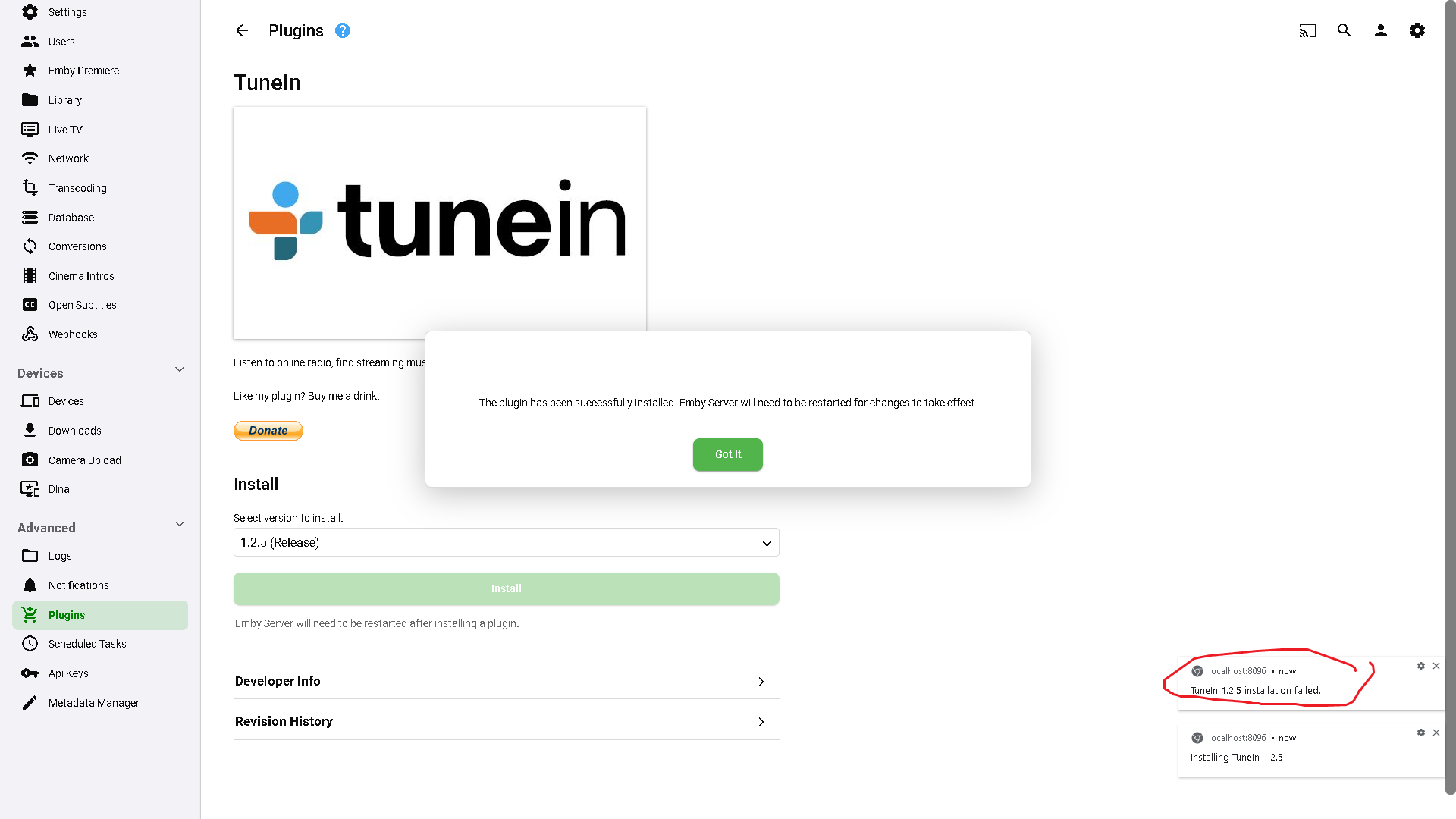

doppies 1 Posted January 11, 2023 Posted January 11, 2023 Good day, Running Emby Server 4.7.11.0 on Windows Server 2012. Emby working great except for when I install any plugin, it fails. Has anybody had this problem?

doppies 1 Posted January 12, 2023 Author Posted January 12, 2023 (edited) Please see attached server log embyserver.txt Tried installing plugins between 6:30 to 6:35. Also gave Emby-Server folder under Roaming full security permissions (everyone), restarted server but still nothing. Edited January 12, 2023 by doppies
ebr 16307 Posted January 12, 2023 Posted January 12, 2023 Hi. Looks like something in your network setup is not allowing your server to talk to ours. Proxy involved? System.Security.Authentication.AuthenticationException: Authentication failed because the remote party sent a TLS alert: 'HandshakeFailure'. 1
Happy2Play 9800 Posted January 12, 2023 Posted January 12, 2023 @doppies What version of Windows is that? It looks like 8.1. Might be the same/similar issue as Windows 7 TLS 1.2 issues but haven't done any testing on 8.1. 1
doppies 1 Posted January 13, 2023 Author Posted January 13, 2023 (edited) 7 hours ago, ebr said: Hi. Looks like something in your network setup is not allowing your server to talk to ours. Proxy involved? System.Security.Authentication.AuthenticationException: Authentication failed because the remote party sent a TLS alert: 'HandshakeFailure'. There is a Fortigate firewall installed yes. Will check the settings. Thanks for pointing that out. Edited January 13, 2023 by doppies
doppies 1 Posted January 13, 2023 Author Posted January 13, 2023 7 hours ago, Happy2Play said: @doppies What version of Windows is that? It looks like 8.1. Might be the same/similar issue as Windows 7 TLS 1.2 issues but haven't done any testing on 8.1. This makes sense yes because its Windows Server 2012 R2 and I have tried everything. Due to nobody experiencing this issue online I assume that installing Emby on another O/S will solve this solution. Thanks for your help.
Solution Happy2Play 9800 Posted January 13, 2023 Solution Posted January 13, 2023 1 minute ago, doppies said: This makes sense yes because its Windows Server 2012 R2 and I have tried everything. Due to nobody experiencing this issue online I assume that installing Emby on another O/S will solve this solution. Thanks for your help. You could use something like IISCypto to change the registry flags as that is how I got Windows 7 to still work in another topic. 1 2
doppies 1 Posted January 13, 2023 Author Posted January 13, 2023 (edited) 46 minutes ago, Happy2Play said: You could use something like IISCypto to change the registry flags as that is how I got Windows 7 to still work in another topic. You are a genius! IISCypto actually did the trick. Appreciate it. Problem solved. Edited January 13, 2023 by doppies 1
