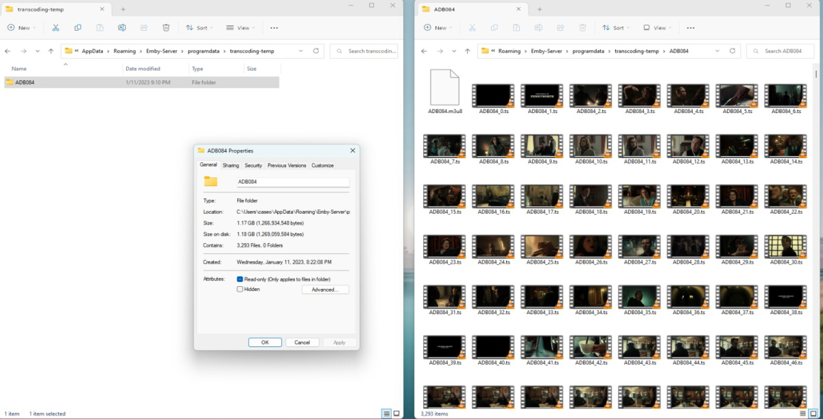

Scott D 69 Posted January 12, 2023 Posted January 12, 2023 (edited) 17 hours ago, Happy2Play said: Take the Roku for example, users click the Home button while something is still playing will close the app without stopping the media. So the server did not receive the command so the items remain in the transcode-temp folder. Same problem here, with one exception. According to the server log file it did in fact receive the "2023-01-11 21:16:16.462 Info SessionManager: Playback stopped reported by app Roku SG 4.0.75 playing Sandie Shaw. Stopped at 3276000 ms" The temp files remained and consumed a touch over 1 gig in the temp directory. This session appears to have all the markings of a "clean run". A start time, and end time and a stop command. This problem occurred during the Bruce_Kelly session started at 8:22:08 pm ending at 9:16:16 pm. Side note - After returning from a long weekend (4 days) away from the server, I found over 250 gig of a 450 SSD being occupied by temp files. There was a live tv stream that had not closed which had run for over 22 hours (most of the data being used in temp folder). The live stream was not being sent out, just captured into the temp folder. Had to restart the server to clean things up and close the channel to the HDHR. No log files for this incident, just wanted to recover the space as quickly as possible. embyserver-63809078400.txt ffmpeg-transcode-20476791-ebe0-4d79-b978-99c736fef423_1.txt Edited January 12, 2023 by Scott D
ShadowKindjal 21 Posted January 13, 2023 Posted January 13, 2023 On 1/11/2023 at 3:40 PM, Luke said: Right but the server should eventually recognize that and clean them up, it just won't be immediately like it would be if you actually stopped. Except that isn't happening if i have stuff backdated to November. Is it possible for emby to clear out that folder on startup?
Scott D 69 Posted January 13, 2023 Posted January 13, 2023 I have been doing a manual restart on a daily basis for a few years now. It will close any open channels of an HDHR as well as delete any transcode temp files. Some have even created jobs that will delete leftover files. I find it easier, while not convenient if left unattended, to simply restart in the morning. Only takes a few seconds and cleans things up nicely.
