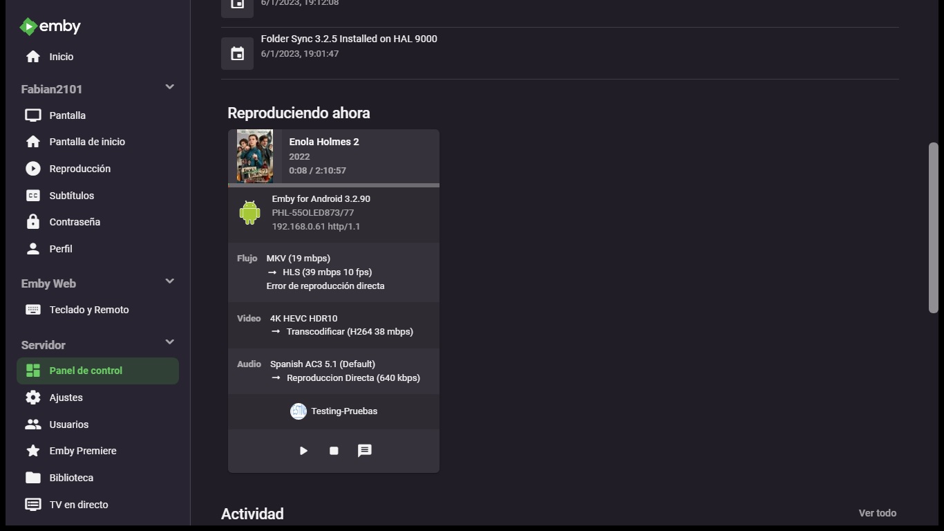

Hello, I want to inform Emby technical support that I am having problems in playing the new and recent MKV files in which the video track contains simultaneously the “High Dynamite Range” systems of “Dolby Vision (DV) and HDR10 ” always exclusively with the contents of the streaming service Netflix. These MKV files that contain "Dolby Vision (DV) and HDR10" simultaneously, from the streaming service Netflix are the only ones that are currently presenting this serious problem with Emby Server 4.7.11.0 for Windows operating system, and with the official client of Emby for Android TV v2.0.83g.
The serious problem is that my Emby server starts converting or transcoding the video track using 100% of the CPU, the HDR video quality dies because it is displayed as a device that does not support HDR with washed out and distorted colors, No impact on HDR brightness and contrast, since by mistake my Emby server transcoded or converted the video track from the original HEVC codec (h265), to the h264 codec that does not support any kind of HDR. And in the statistics for nerds the legend “Direct Play Error” is reported.
But if instead of using the internal player of the official client for Android TV, and I establish the playback with an external player, the playback is done with direct transmission without any conversion or transcoding and I can see the HDR perfectly well.

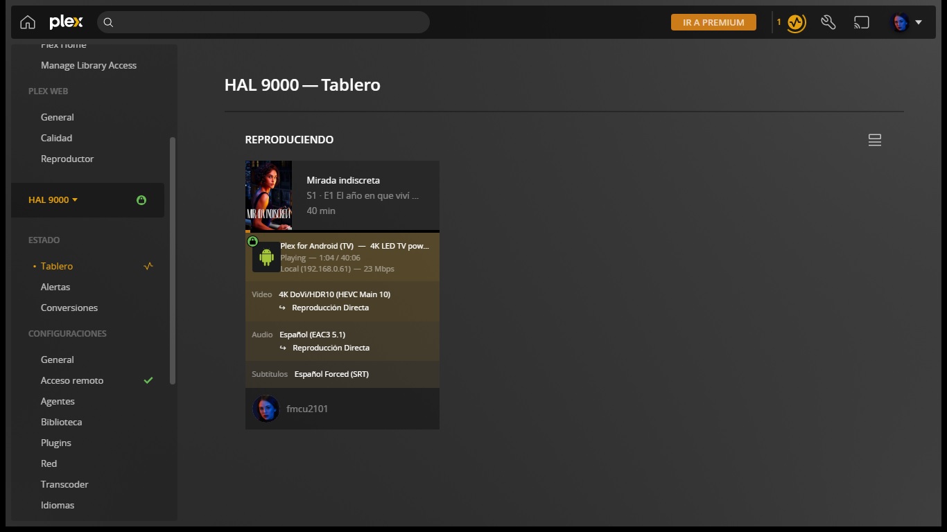

You are right, I turned on my Plex server, which had been turned off for several months, I began to carry out the tests with Plex and I am surprised that with the Plex server and its official client for Android TV all the content that video tracks containing Dolby Vision and HDR10 work and play without any issues or errors, and with full direct playback without any transcode.
It is that I, a few months ago, managed to solve the problem of jumps and jerks in the images when playing with Emby on my Philips OLED873 television, forcing my Emby server to always send HLS transmission, instead of direct transmission.
I also see that Emby does not inform that the transmissions contain Dolby Vision and HDR10. Plex now does report it on the dashboard.
This new issue with my Emby server may force me to return to Plex.
I am attaching all the screenshots of the dashboard of my Plex server, where you can observe and check that the playback with Netflix content works on the Plex server:251561470_PLEXCaleidoscopedirecta.thumb.jpg.877169ba5779a36ee594075f8f7a7dd6.jpg
251561470_PLEXCaleidoscopedirecta.thumb.jpg.877169ba5779a36ee594075f8f7a7dd6.jpg1948614294_PLEXEnaola2directa.thumb.jpg.2f6216ccbd108c4008a83b9f1af209cf.jpg1714862464_PLEXLadyVoyeurdirecta.thumb.jpg.66748fe4a4e48566e3d124c089f5bcc6.jpg

Dear @Luke, I already installed and I was doing the tests with the official app for Android Mobiles as you requested.
The result is exactly the same, Emby is not able to achieve direct playback, or direct play without transcoding the video on the video tracks with Dolby Vision and HDR10, exclusively for the moment only on Netflix content.
In the non-Netflix movie "The Menu (2022)", it has no problem playing with Emby despite the fact that the video track also contains Dolby Vision and HDR10.

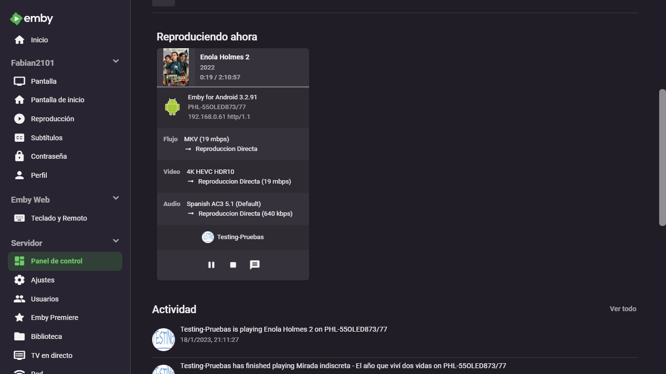

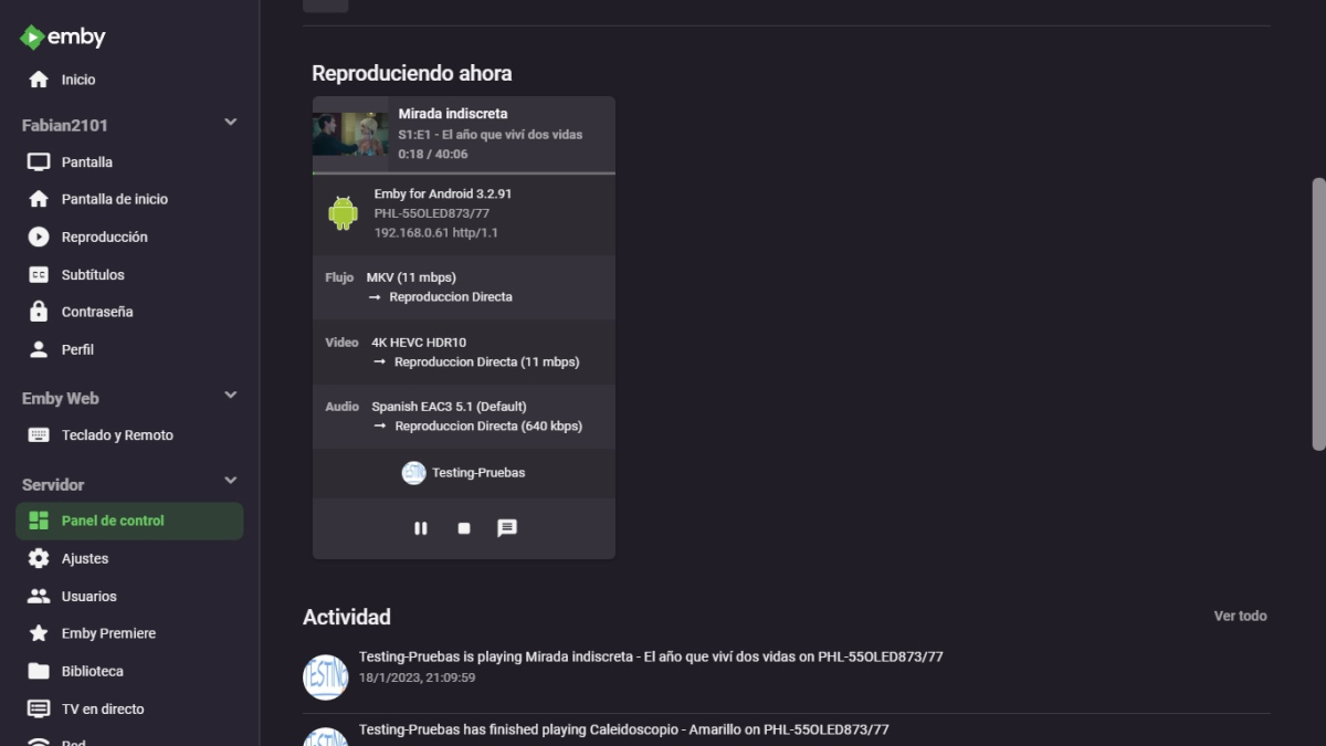

Fabian2101
I want to notify you that the problem with playback, with the previously mentioned files of Netflix content, which contain DV and HDR10, in my case it is completely solved, the playback is direct and without any transcoding, but for the moment the solution It is in the client for Android tablets and smartphones with version 3.2.91.
The successful test was carried out on my Philips 55OLED873 television with Android TV 8, on the Xiaomi Mi Box with Android TV 9.
Unfortunately, the problem persists in the client for Android TV, and what I use the most is the client for Android TV, on my four television devices to watch movies and episodes of television series in HDR quality.
I attach the screenshots, where you can see my Emby server, doing direct transmission with HTTP, without any transcoding:
833710309_CalidoscopioHDRenEmbyMobile.thumb.jpg.e544d15fc190f1b568f502b960884332.jpg364148072_EnaolaHolmesHDRenEmbyMobile.thumb.jpg.0445bb92d6c2d6f7caac4710c973333f.jpg131022595_MiradaindiscretaHDRenEmbyMobile.thumb.jpg.7736274218c7c04032e19049f20b8bd0.jpg
