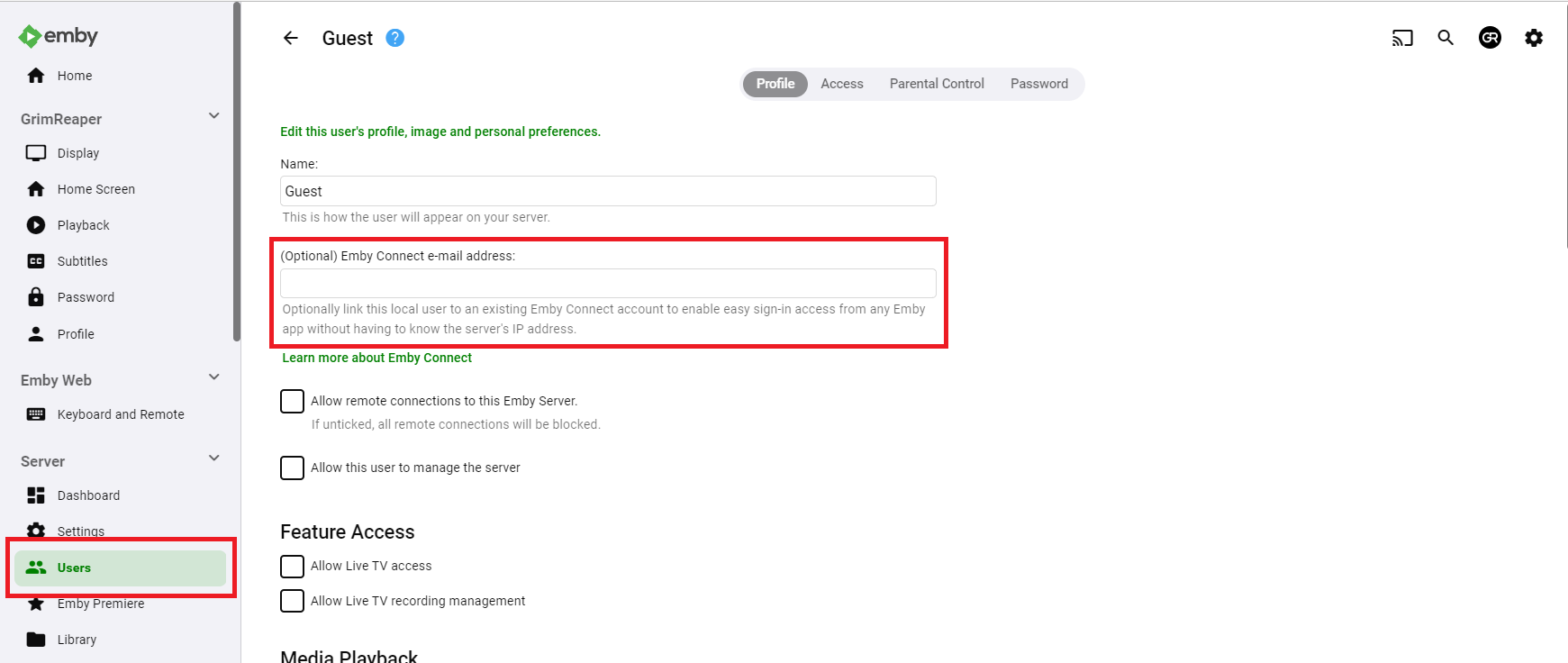

GrimReaper 4851 Posted January 20, 2023 Posted January 20, 2023 59 minutes ago, Methodman104 said: Do I add the Emby Connect username and password I created for them? Or do they log into the Emby Server first with the username/password they signed up for with Emby Connect then find my server? You need to link local user with existing Connect account: For example for User: Dad you would input email address of his Connect account: momanddad@gmail.com. He'll get a confirmation email to accept. Once you link his account, he can login to your server either with his local credentials (having to know server address) or with his Connect credentials (not needing to know server address).
Happy2Play 9800 Posted January 20, 2023 Posted January 20, 2023 1 hour ago, Methodman104 said: Do I add the Emby Connect username and password I created for them? Or do they log into the Emby Server first with the username/password they signed up for with Emby Connect then find my server? Assuming a Connect account has been created you add the email address to the existing user via the image in the KB. Then the user would use their Connect email and password to log in via the device. As Direct and Connect are different connection methods. Have you verified your ports are still open? Test Your External Address
