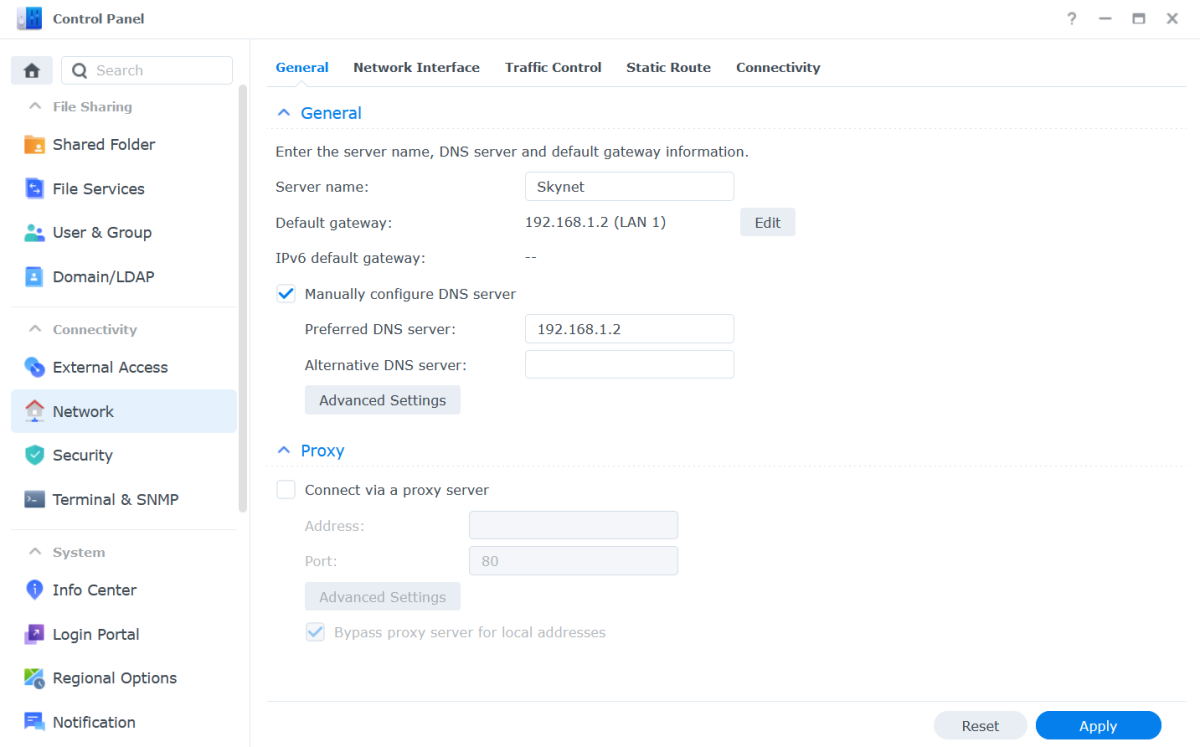

rbjtech 5335 Posted January 7, 2023 Posted January 7, 2023 This is the bit that concerns me from the log - Emby is saying 192.168.1.2 is the g/w - when it's not, that is your AVR .. ?
wakeboarder141 40 Posted January 7, 2023 Author Posted January 7, 2023 8 minutes ago, rbjtech said: This is the bit that concerns me from the log - Emby is saying 192.168.1.2 is the g/w - when it's not, that is your AVR .. ? Yes, it appears to be set incorrectly in the NAS somehow. I will try to correct this. This is how it was set.
rbjtech 5335 Posted January 7, 2023 Posted January 7, 2023 Right ok - now we are getting somewhere. Check the IP of your router - this is the gateway IP - it's probably 192.168.1.1 Put this as the g/w on your synology and the DNS server as well. Then things should start working - fingers crossed 1
wakeboarder141 40 Posted January 7, 2023 Author Posted January 7, 2023 (edited) 12 minutes ago, rbjtech said: Then things should start working - fingers crossed You got it! Thanks so much for your help. No idea how that changed, but at least I know the problem now. Any advice on any special tricks for now switching everything from my old ISP to the new fiber? In theory I should just be able to restart Emby once the fiber is running, and the remote server IP address should update automatically right? Edited January 7, 2023 by wakeboarder141
