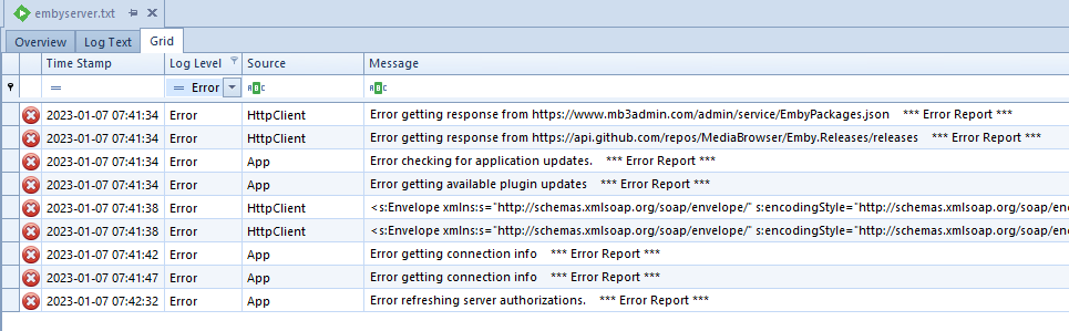

rbjtech 5335 Posted January 7, 2023 Posted January 7, 2023 Changing ISP should make no difference to emby. Clear the emby log and restart emby - then post the log, that would then give us info on it's IP subnet etc.
wakeboarder141 40 Posted January 7, 2023 Author Posted January 7, 2023 (edited) 2 hours ago, rbjtech said: Changing ISP should make no difference to emby. Clear the emby log and restart emby - then post the log, that would then give us info on it's IP subnet etc. Here is the log after the Emby restart. I don't know of a way to clear the log first if I needed to do that. Also, this is all back on original equipment and original ISP trying to get back to working. embyserver.txt Edited January 7, 2023 by wakeboarder141
rbjtech 5335 Posted January 7, 2023 Posted January 7, 2023 (edited) ok - so emby is detecting two local ip addresses - (these are private IP's - so perfectly ok to publish here) 192.168.1.29 10.10.10.5 I believe you said the 10.10.10.x network is your 10Gig Network - but do you want emby to use that or the 192.168.1.x network ? It appears all external connection attempts are failing - suggesting emby is trying to use a network that has not internet access - the 10.10.10.x network ? I would force emby to use just the 192.168.1.29 address . In 'Server > Network' This is an example where I am forcing emby to use 192.168.30.100 Once done and rebooted - then set your port forward rule in your router (WAN any:any > Emby 8097/8920 etc - to point to 192.168.1.29 (note, the local server is listening on 8097, not 8096 according to the log) from the log showing all external comms failing - Edited January 7, 2023 by rbjtech
rbjtech 5335 Posted January 7, 2023 Posted January 7, 2023 (edited) Also noticed a few queries on your network gateway - emby says it's 192.168.1.2 ? Is that correct ? As there are also DLNA activity using that IP which doesn't make a lot of sense. Gateway's on these routers are usually 192.168.1.1 or 192.168.1.254 - you may have it manually set ? Worth checking - as this may explain why you can't get any WAN connectivity working (it can't leave by the gateway) but local emby (LAN) is working just fine. Edited January 7, 2023 by rbjtech 1

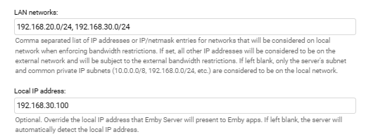

rbjtech 5335 Posted January 7, 2023 Posted January 7, 2023 8 minutes ago, wakeboarder141 said: Does that LAN Networks field need to be filled out or just the Local IP address field? Thanks. You can leave that blank - sorry, I already had a pic of it so just used that containing both fields - LAN networks is only related to whether emby considers it a LAN local or remote connection. Ignore it ..
