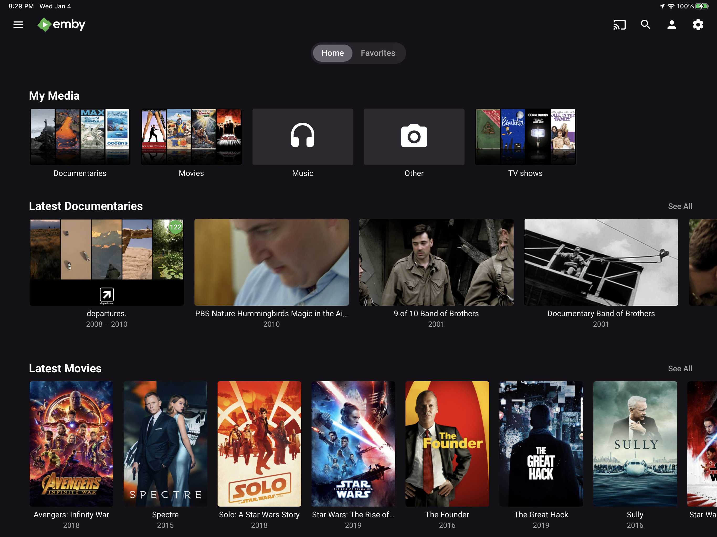

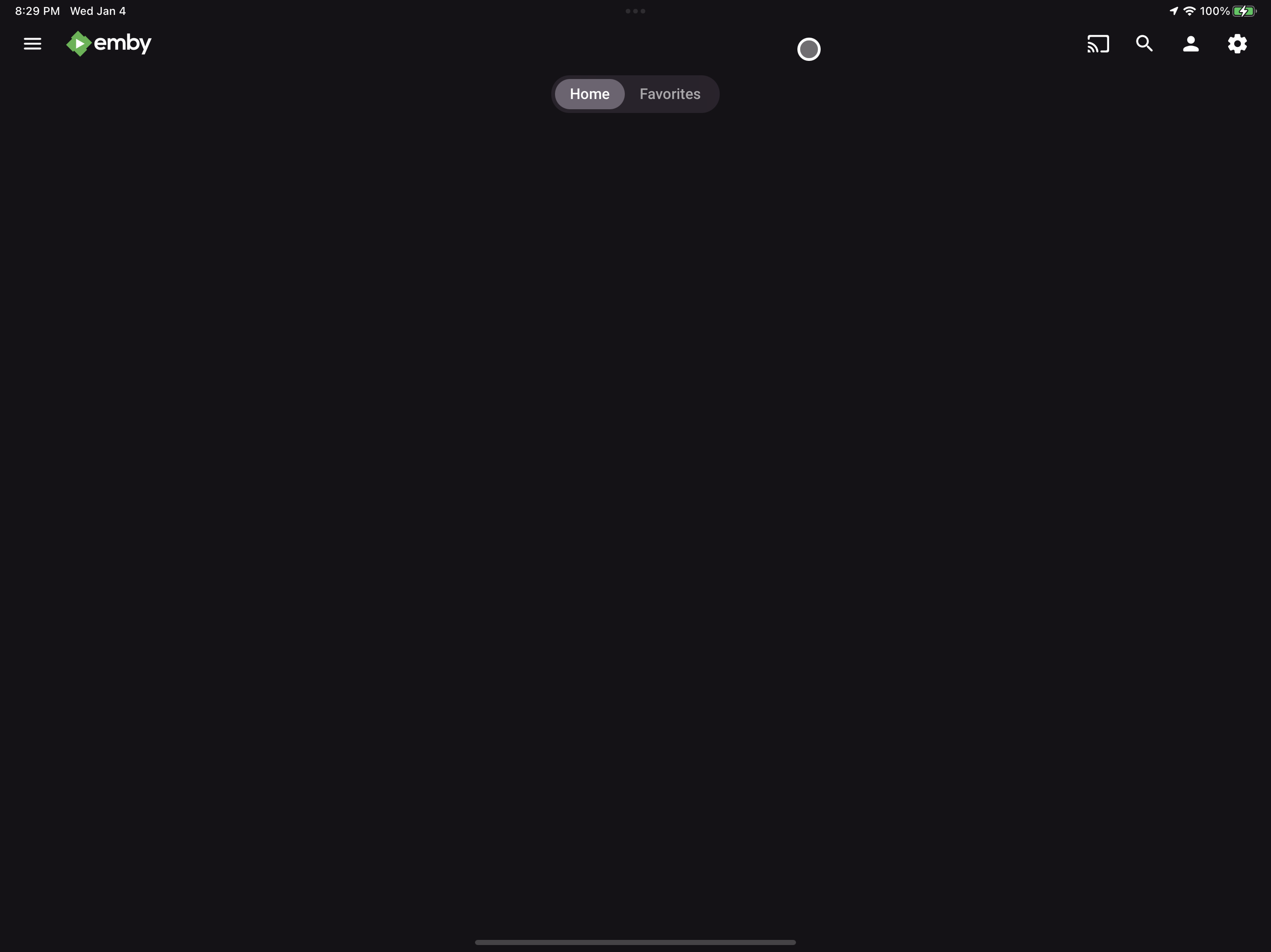

micleeso 0 Posted January 5, 2023 Posted January 5, 2023 The Library Access Control function is not operating correctly. If I allow access to entire library, the default setting "Enable Access to All Libraries" the user will be able to access all content. If I select specific libraries the user has no access to any of the libraries. Thank you for helping.

micleeso 0 Posted January 5, 2023 Author Posted January 5, 2023 (edited) As explained. I have user if I try to select access to specific library the user does not see any Libraries. Only access to all libraries work. I have been using this for years. I added a new library that I don't want the user access to, the user doesn't see any content. Edited January 5, 2023 by micleeso

micleeso 0 Posted January 5, 2023 Author Posted January 5, 2023 Here you go. I added a photo of the outcome. embyserver-63808458480.txt embyserver.txt hardware_detection-63808458033.txt hardware_detection-63808458509.txt

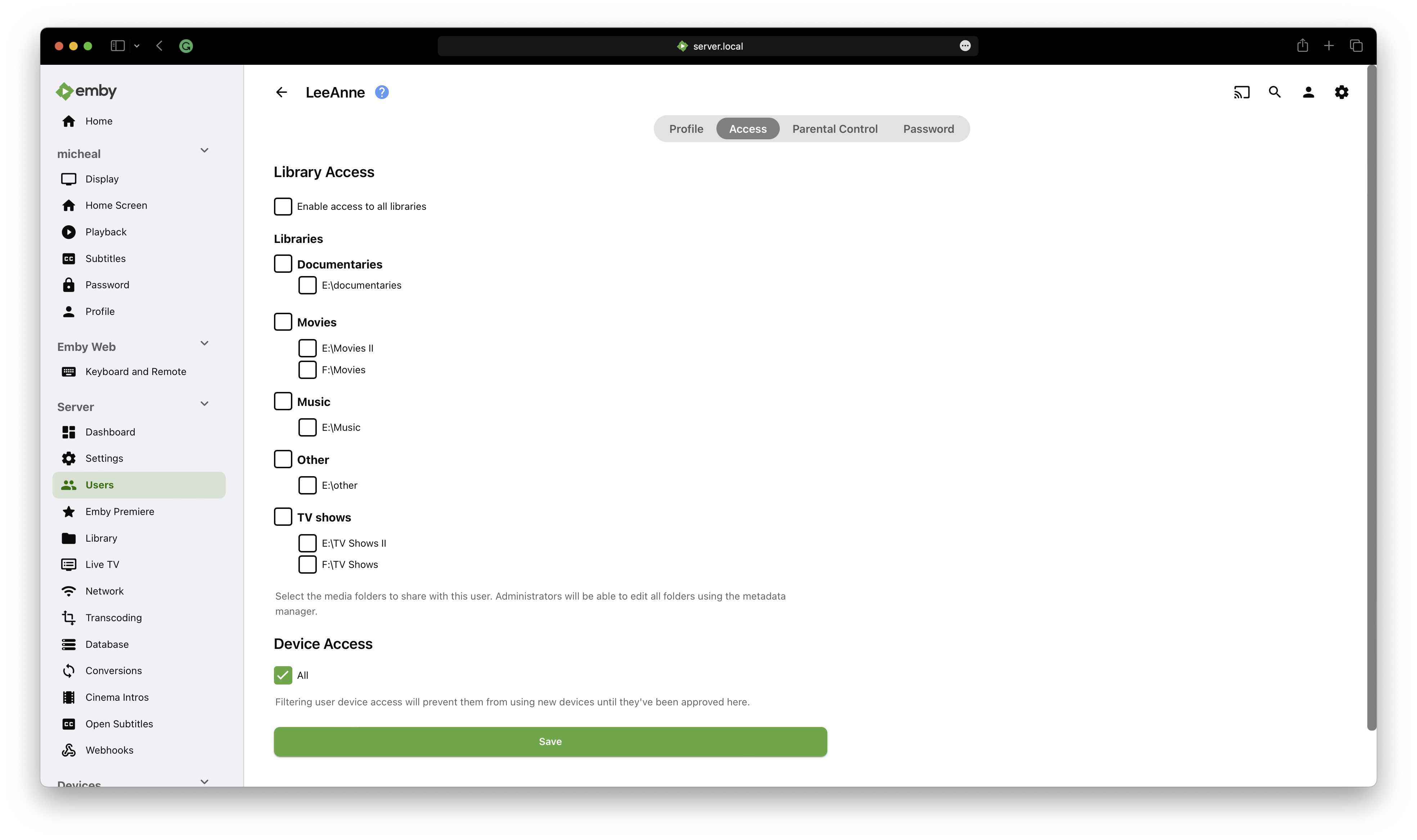

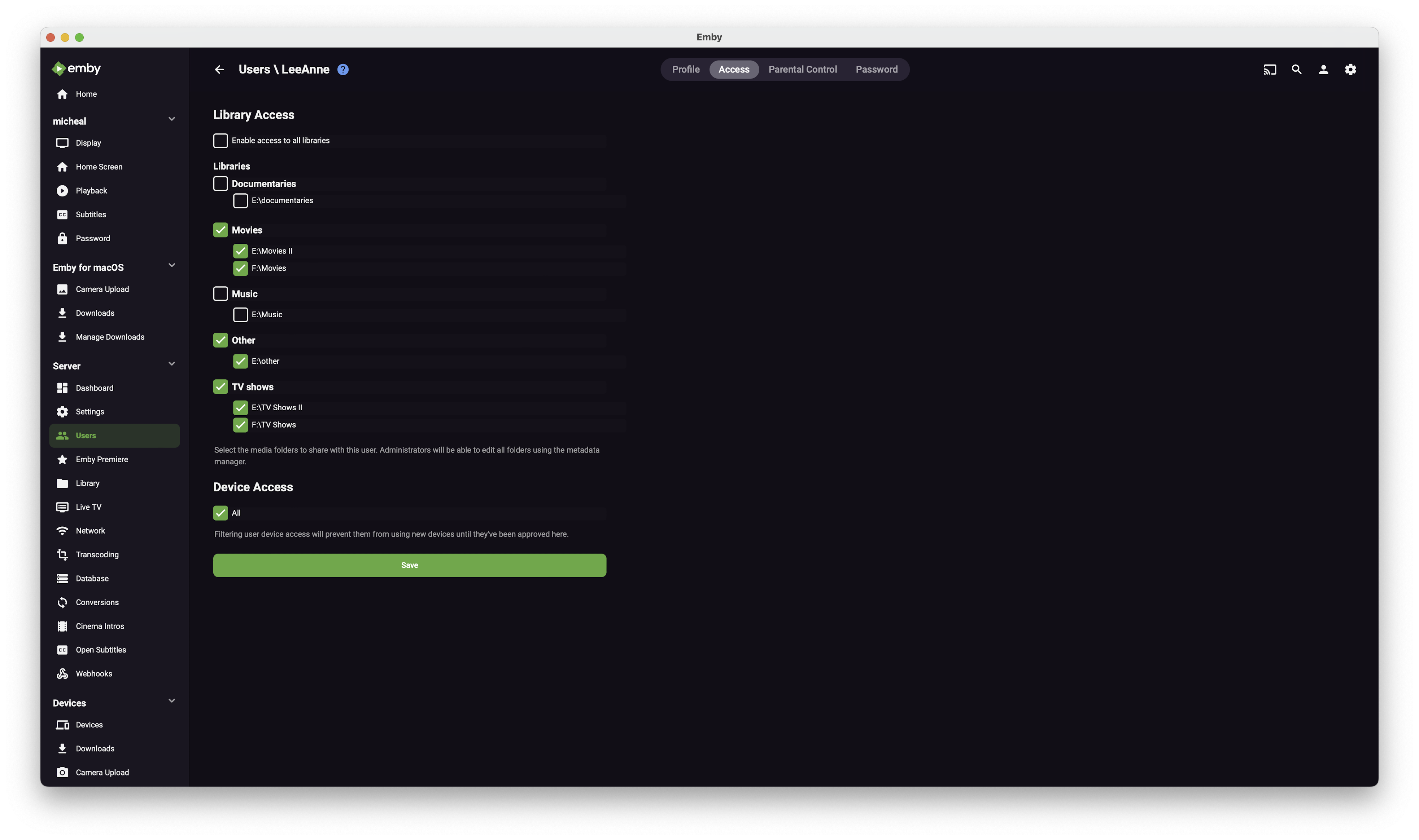

Luke 42290 Posted January 5, 2023 Posted January 5, 2023 Hi, can you show an example of how you configured library access for a user? Thanks.
micleeso 0 Posted January 5, 2023 Author Posted January 5, 2023 14 hours ago, Luke said: Hi, can you show an example of how you configured library access for a user? Thanks. I narrowed the issue down to macOS client. If I edit the access control to the user using the macOS application the issue occurs. i.e. remove access to documentaries and music I then log into the user and all content is gone. Attached is a picture of removing said library content in macOS application. I then opened Safari and looked at the access control setting to that user. All library content was deselected, hence no access to entire library. I can successfully edit the library access control to the user using the browser portal. MacOS = "black background" Browser Portal = "White background"
Luke 42290 Posted January 5, 2023 Posted January 5, 2023 OK yes this will be resolved with the next update to Emby for macOS.
