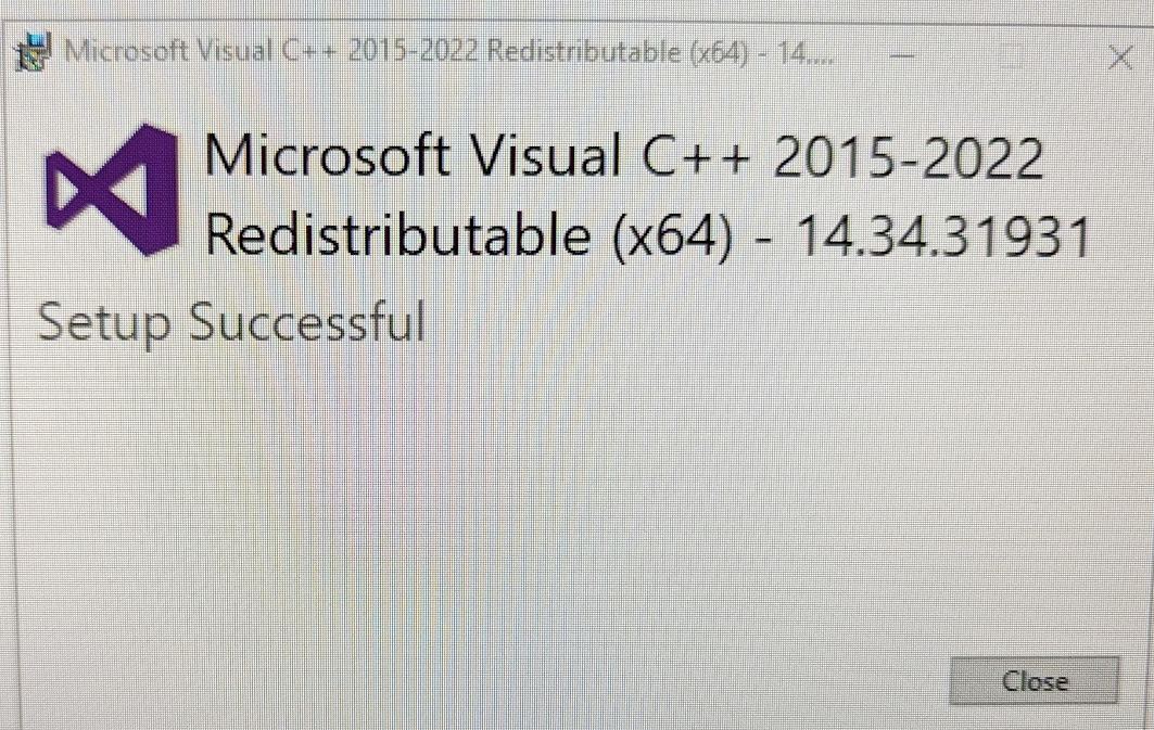

Happy2Play 9800 Posted January 5, 2023 Posted January 5, 2023 What version of MS Visual++ do you have installed?
dafty84 1 Posted January 5, 2023 Author Posted January 5, 2023 2 minutes ago, Happy2Play said: What version of MS Visual++ do you have installed?

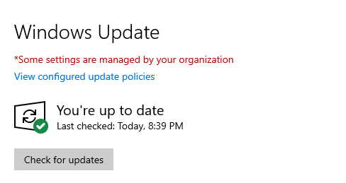

dafty84 1 Posted January 5, 2023 Author Posted January 5, 2023 13 minutes ago, Luke said: Yea that's strange. Is Windows up to date? Yeah all patched/up to date:

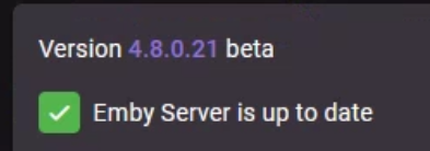

dafty84 1 Posted March 13, 2023 Author Posted March 13, 2023 (edited) On 3/12/2023 at 2:54 PM, Luke said: Did you try the above suggestions? TBH I did not. I ended up going different route with an Nvidia card and haven't attempted with the ARC card since. My apologies for abandoning the conversation/thread. I see 4.8 per your next post resolves issue. If you don't mind, what was the discovery? I would like to try the ARC card if possible if you don't mind sharing the beta? Edited March 13, 2023 by dafty84
dafty84 1 Posted March 13, 2023 Author Posted March 13, 2023 (edited) 8 minutes ago, dafty84 said: TBH I did not. I ended up going different route with an Nvidia card and haven't attempted with the ARC card since. My apologies for abandoning the conversation/thread. I see 4.8 per your next post resolves issue. If you don't mind, what was the discovery? I would like to try the ARC card if possible if you don't mind sharing the beta? I see the current beta is 4.8.0.21. I assume the fix will be a newer Ver? I think this one was released in Dec? Edited March 13, 2023 by dafty84
