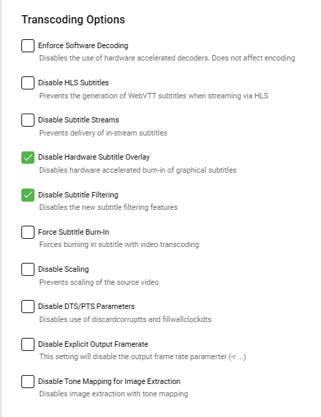

PeteGul 42 Posted March 2, 2023 Author Posted March 2, 2023 Installed it, but can't seem to find what is mentioned. But I found HLS, see picture.
rbjtech 5345 Posted March 2, 2023 Posted March 2, 2023 Odd - could be a Beta release thing - as I have these options. Ignore this for the moment - lets get the logs and I'll try and see what's going on .. 1

pwhodges 2039 Posted March 2, 2023 Posted March 2, 2023 Most of that subtitle stuff is a beta thing. It's also complicated in that case by the fact that there are similar options on the Diagnostics page shown and on the Advanced Transcoding tab for subtitles, and no indication of how they are linked or which takes precedence. Add the old option on the ordinary transcoding page about stripping subtitles or burning them in and the whole thing's currently rather a mess! Obviously (?) this will get cleaned up for release; I'm hoping against hope that it's actually one of the things getting sorted out during this beta release hiatus - as all the subtitle options seem to be working pretty well now if you can get the right ones selected. Paul 1
