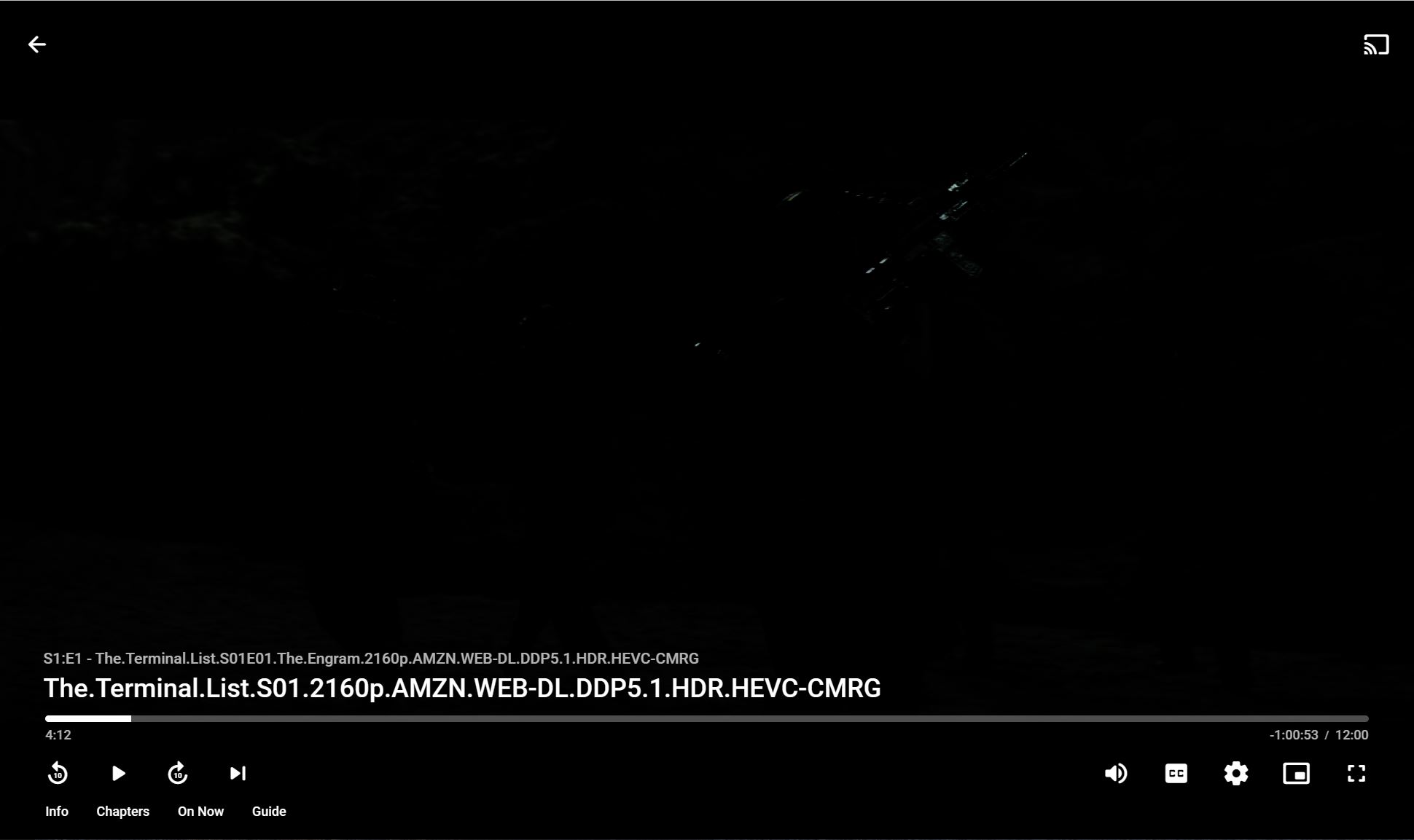

scotty333 0 Posted January 1, 2023 Posted January 1, 2023 Hi, Having an issue with most but not all HEVC HDR videos. Some scenes are so dark you can only see some small light areas of video, on PC Windows, Android and Tizen. Same videos play fine on Media Player Classic - same PC. Have tried using SDR, and hardware/software transcoding - no difference. Screenshot and logs attached. Same issue when setting playback to 1080p. Odd thing is not all video is affected, but most. No issue with 1080P media (so far). Light scenes in same files are not as bad, but still much darker than they should be. Cheers embyserver.txt

scotty333 0 Posted January 2, 2023 Author Posted January 2, 2023 HDR Tone mapping is enabled (same result if on or off). No ffmeg log was generated when playing these files.

scotty333 0 Posted January 2, 2023 Author Posted January 2, 2023 Mediainfo below. Really odd it plays other HDR10 files perfectly, some just latest releases are so dark it's unwatchable... Media Player Classic HC is fine for same files. Title 4K HEVC HDR10 Codec HEVC Profile Main 10 Level 150 Resolution 3840x2160 Aspect Ratio 16:9 Interlaced No Framerate 23.976 Bitrate 15 mbps Video Range HDR10 Colour Primaries bt2020 Colour Space bt2020nc Colour Transfer smpte2084 Bit Depth 10 bit Pixel Format yuv420p10le Reference Frames 1
GrimReaper 4926 Posted January 2, 2023 Posted January 2, 2023 8 hours ago, scotty333 said: Bitrate 15 mbps Make sure Tonemapping is enabled in Settings, play item in question and then lower quality to below 15 Mbps (i.e. 10 Mbps, 5 Mbps...) - that will trigger transcoding upon which you can post ffmpeg logs created.
scotty333 0 Posted January 2, 2023 Author Posted January 2, 2023 Thanks that makes sense. Log attached! ffmpeg-transcode-dd9d2f28-3d1b-4fc6-b555-a4a1cdc853e6_1.txt
scotty333 0 Posted January 2, 2023 Author Posted January 2, 2023 Just noticed if I set the bitrate to 5 Mbps the picture is no longer dark? But TV doesn't show it's HDR content... in fact it doesn't show it's HDR when auto bitrate and dark picture either. Whereas other HDR HEVC files do show as HDR and look perfect.
