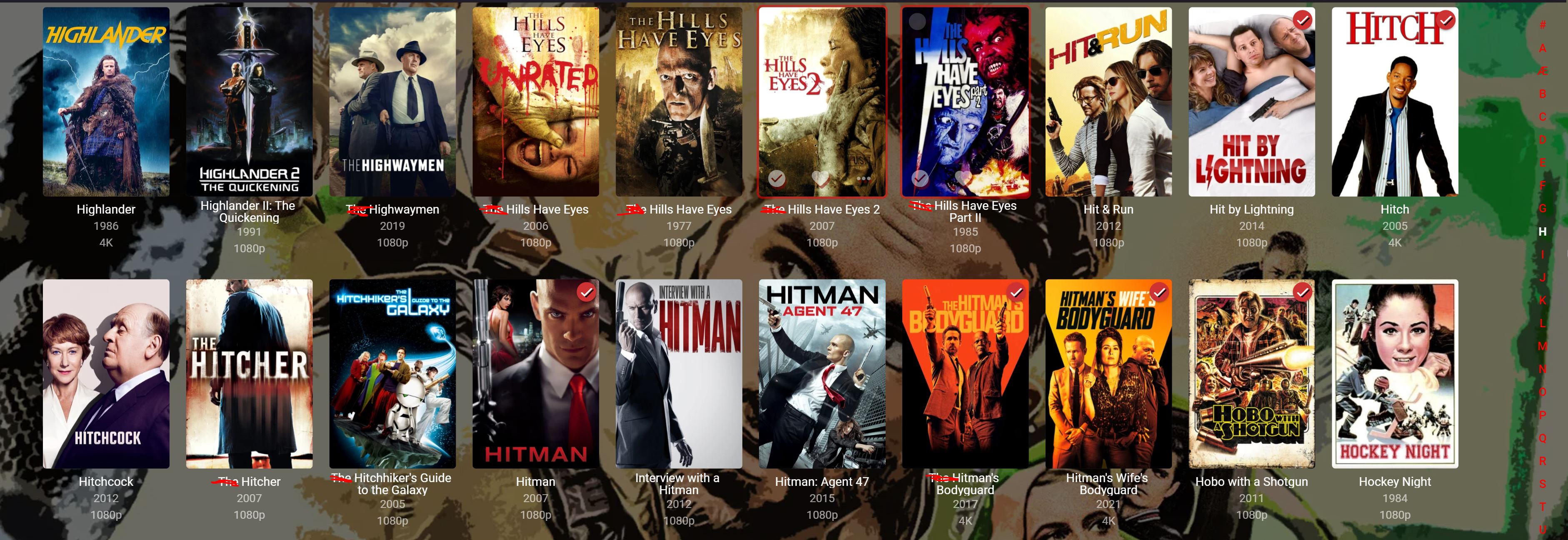

King Pin 34 Posted December 31, 2022 Author Posted December 31, 2022 I do everything on my desktop. I'm always going through my library updating images, quickly scanning to find a movie to see if I need to upgrade it to a newer format etc. It makes easier when quickly scanning. Right now Emby isn't doing it for a lot of movies screenshot attached. I
Happy2Play 9800 Posted December 31, 2022 Posted December 31, 2022 True it is Sorting them correctly as they appear in H instead of T. So you want to remove "The" from Emby display title? Don't know regex but if you write nfo files I guess you could change the "Title" node and Emby would display them without "The".

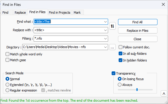

Happy2Play 9800 Posted January 1, 2023 Posted January 1, 2023 I guess a dirty way would be use notepad++ and do a find in files Find: <title>The (Ensuring you have the trailing space) Replace with: <title> Filters: *.nfo Directory: library path But would test on single item or create a test library with a couple item. This is something you have to do whenever adding a new item with "The" in title. Or if a coding guru can provide a script to copy <sorttitle> to <title> (but confict if you have custom sorttitles) 1
rbjtech 5335 Posted January 1, 2023 Posted January 1, 2023 This may also impact the ability for emby to identify the item on a metadata refresh (but I would hope the providers have logic to capture this) - so I would be very cautious on doing this. The Sort Title is there for this exact reason - it will usually just put the 'the' after the title. ie 'Highwaymen, The' I used to do this myself many years back, but then reverted back to the main title due to Identify issues - you have been warned 1
