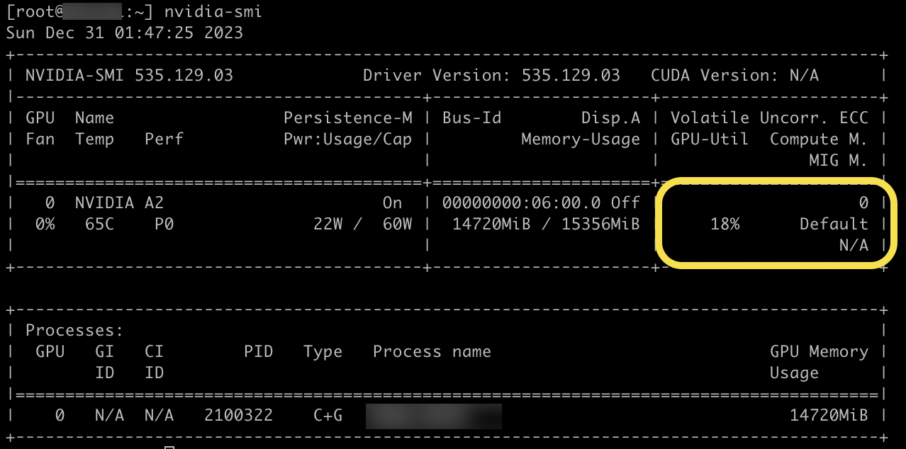

Solution smokey7722 15 Posted January 4, 2024 Author Solution Posted January 4, 2024 Rather than leaving this open ended I figured I should provide an update... This took way longer than I planned to get to but I finally got to it. The 1U chassis now has an A2 installed in it and I have the vCenter Nvidia vGPU license in place for vWS. I assigned the VM for Emby an A2-16Q profile which gives the VM effectively the entire A2 card to use. From the logs after driver install and reboot, Emby shows the following decoders: 2024-01-03 16:00:37.997 Info CodecManager: CodecList: Decoders mpeg2video CUVID NVIDIA A2-16Q - MPEG-2 DX11VA NVIDIA A2-16Q [1] - MPEG-2 NVDEC NVIDIA A2-16Q - MPEG-2 vc1 DX11VA NVIDIA A2-16Q [1] - VC-1 NVDEC NVIDIA A2-16Q - VC-1 h264 CUVID NVIDIA A2-16Q - H.264 (AVC) DX11VA NVIDIA A2-16Q [1] - H.264 (AVC) NVDEC NVIDIA A2-16Q - H.264 (AVC) hevc CUVID NVIDIA A2-16Q - H.265 (HEVC) DX11VA NVIDIA A2-16Q [1] - H.265 (HEVC) NVDEC NVIDIA A2-16Q - H.265 (HEVC) vp9 NVDEC NVIDIA A2-16Q - VP9 DX11VA NVIDIA A2-16Q [1] - VP9 vp8 NVDEC NVIDIA A2-16Q - VP8 Encoders h264 NVENC NVIDIA A2-16Q - H.264 (AVC) hevc NVENC NVIDIA A2-16Q - H.265 (HEVC) Real world testing... Prior to the card I could run anything in the house using my Nvidia Shield Pro clients as expected as nothing has to transcode. My phone or web browsers required some transcoding but seemed fine. However my family who uses my Emby instance as I mentioned earlier have a variety of clients from native TV's (Samsung, LG, etc) to Apple TV's or various phones. If I had a piece of content that was 4K HEVC HDR10, it needed to transcode it down for them and the system could keep up in general for one 4K HEVC transcode. The VM has 8GB of ram and 8 cpu cores and was constantly rising to 80%+ during transcodes unless I kept 1080p H264 content for remote users to select when they had to transcode. More cores didn't seem to help either and I also can't keep throwing more at it for CPU as the ESX host runs other VM's too. After the card... So far I haven't seen it break. I've had 4x 4K HEVC HDR10 streams transcoding down to 720p or 1080p plus a few H264 transcodes going at once and the CPU hasn't gone above 10% Ironically thats also with the A2 not reaching above ~30% utilization either. Example below... this had 2x 4K HEVC HDR10's and 2x 1080p H264 transcoding at once. Yea, 18%. I'm planning on dropping the VM CPU down to 4 from 8 as it hasn't needed much at all so far.
