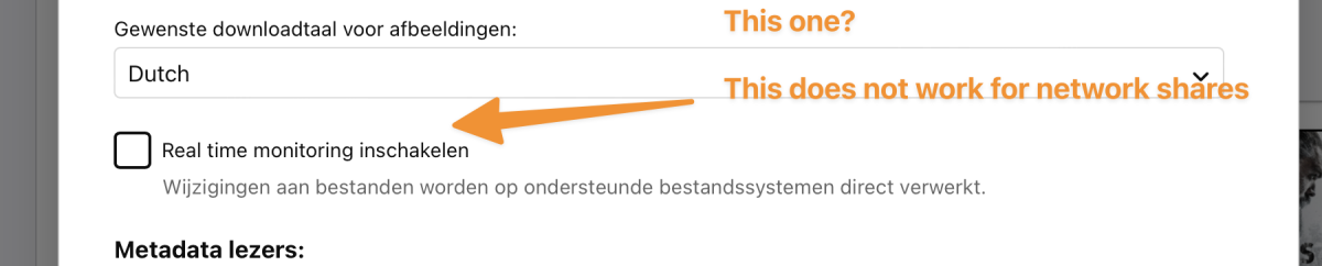

Eigeplackter 92 Posted December 29, 2022 Posted December 29, 2022 Why don‘t you use the „Watch library“ Real-Time-Surveillance option in Emby ? Option is in libraries- edit 3rd from top I think. 1

Eigeplackter 92 Posted December 29, 2022 Posted December 29, 2022 Are you sure ? Maybe it‘s working for me as it‘s actually a path on my Synology where Emby is running top. But it is a shared folder.
Marc0 29 Posted December 29, 2022 Author Posted December 29, 2022 Just now, Eigeplackter said: Are you sure ? Maybe it‘s working for me as it‘s actually a path on my Synology where Emby is running top. But it is a shared folder. Yes! That is way it is working for you. From the perspective of Emby , The Synology is not a share but a "local" drive. I have an Intel NUC running with EMBY, which is connect through shares to a Synology. That's a different set up. But thanks anyway... you help is appreciated !
Luke 42243 Posted December 29, 2022 Posted December 29, 2022 6 hours ago, Marc0 said: It's not supported on all file systems. It will be more likely to work if you mount the network share to a local folder on the Synology and then import that path into emby server.

Luke 42243 Posted January 12, 2023 Posted January 12, 2023 It's limited to file systems supported by both INotify and the .Net runtime, which SMB on linux is not. That's why you need to mount it to a local share to give the realtime monitor a better chance of working.

Q-Droid 1011 Posted January 20, 2023 Posted January 20, 2023 It doesn't work with network file systems (remote storage) regardless of how they're mounted or accessed. 1
Q-Droid 1011 Posted January 20, 2023 Posted January 20, 2023 I need to add that this isn't a problem with Emby but a limitation of the inotify API which is kernel based and does not detect changes made on network shares. In those cases it's the host exporting those shares that detects the change on storage local to itself. It's a limitation of the kernel/OS. 1
