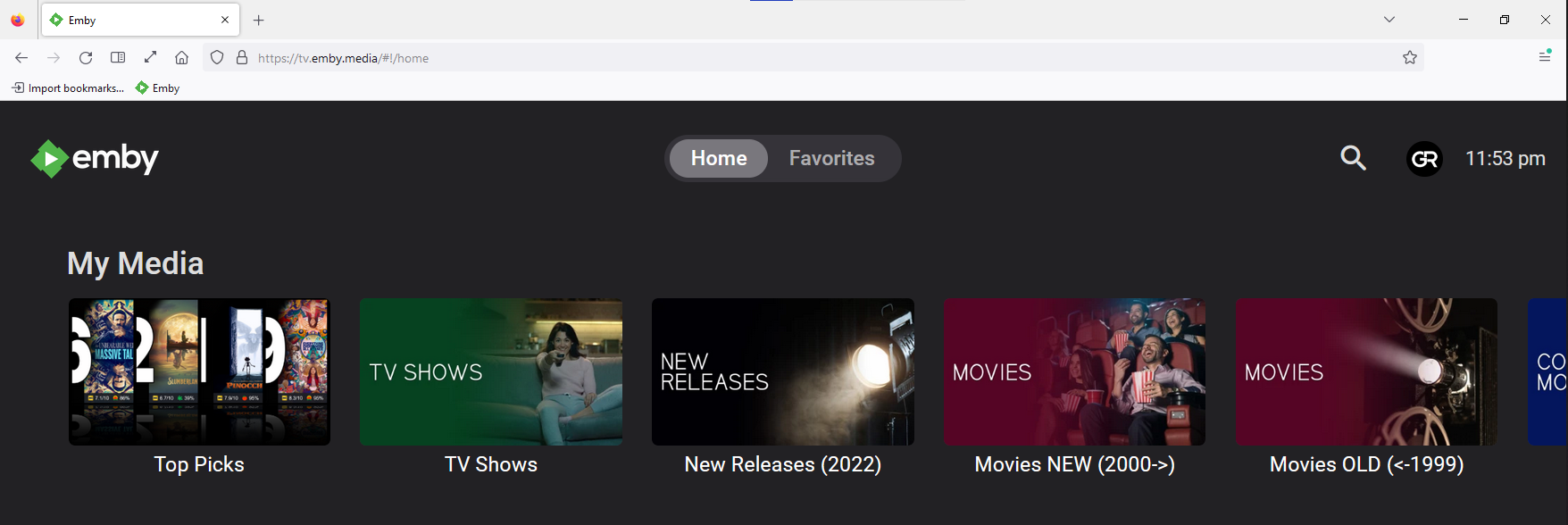

Truthfully, the major selling point for me was the GUI presented by tv.emby.media.  This is kind of difficult to explain but the graphical user interface presented by tv.emby.media was bigger.  More like the "10 foot user interface" that I was looking for in a media server.  The regular view when connecting to my server directly was the same but smaller.  I didn't know why there were two different views but didn't think too hard about it, used tv.emby.media to connect to my server and all was good in the land.

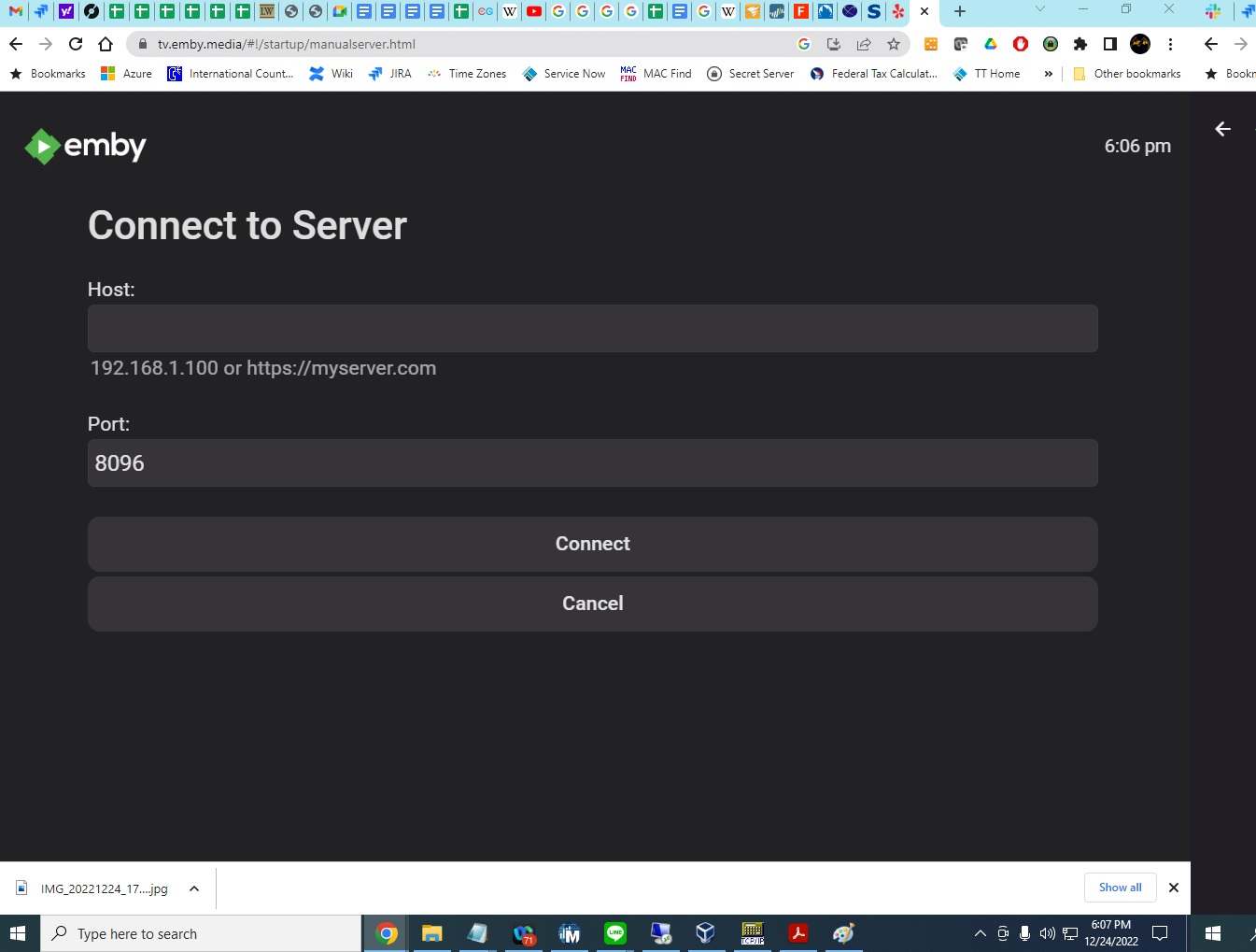

Until there was an update.  Or something.  6 months or so later tv.emby.media stopped connecting.  No matter what I did or what I tried I always received a "connection failure" web page when trying to connect.  Connecting manually using tv.emby.media didn't work.  Emby connect didn't work.  The only way I could connect to my server was using the IP address and port or I could also use app.emby.media but the resulting GUI was the same for both:  Smaller than the one presented when connecting to tv.emby.media.
I've been just working around this forever.  Today I had some time to gather some screen shots and post here in the hopes that maybe someone could provide some insight into the difference between tv.emby.media and app.emby.media and maybe how to get tv.emby.media working again.

You likely don't have SSL set-up on your server, hence your tv.emby.media is failing as per your screenshots you're trying to connect to https://tv.emby.media :
(btw, tv.emby.media works on both http:// and https://, with Connect or with manual connection); connect to http://tv.emby.media, just as you are connecting to http://app.emby.media, not https://app.emby.media (all visible from lock icon in your browser address bar).

To answer the questions about the difference, they are the same thing, except that tv.emby.media defaults to TV display mode. You can configure app.emby.media to look the same way in Display settings.

To provide more specifics, it is the connection piece of the process that is failing.  I connect to tv.emby.media and can then either use emby connect or connect manually to my server.  The conection part of the process is what fails.
Thanks much for the great information and this helps to confirm what I found out while tshooting today.  I did a lot of looking with wireshark on my client and server and then got into the networking panel on Chrome since wireshark didn't actually show any of my connection attempts.  Chrome is blocking the connection:
Mixed Content: The page at https://tv.emby.media/#!/startup/manualserver.html' was loaded over HTTPS, but requested an insecure resource 'http://x.x.x.x:8096/emby/system/info/public'. This request has been blocked; the content must be served over HTTPS.
So that explains why it worked fine until I updated Chrome.  More specifically:
http://tv.emby.media <-> http://x.x.x.x:8096
https://tv.emby.media <-> http://x.x.x.x:8096
would work when I first installed emby in 2020.
But a Chrome update broke https://tv.emby.media <-> http://x.x.x.x:8096
And now this doesn't work either:
http://tv.emby.media <-> http://x.x.x.x:8096 doesn't work either.
Access to fetch at 'http://x.x.x.x:8096/emby/system/info/public' from origin 'http://tv.emby.media' has been blocked by CORS policy: The request client is not a secure context and the resource is in more-private address space `private`.
Thanks everyone for taking the time to assist me with resolving this.  It looks like I need to get SSL setup on my server to make chrome happy and will look into doing that.
This works just fine:  http://x.x.x.x:8096.  That's what I've been using since the Chrome update broke how I used to connect.
it is new restrictions blocking private network access. We have applied for an exemption for now for app.emby.media but have not done this for tv.emby.media, since we don't really publish that url anymore.

1.  This is not an "emby" issue.  This is a chrome issue.
2.  This is an issue using the chrome browser because of increased security measures implemented in updated versions of the chrome browser.  Chrome blocks the following comms:
    a.  https://tv.emby.media <-> http://x.x.x.x:8096
In this example chrome is actually blocking two items although it only reports one in the debug.    Chrome will block ssl (secure) <-> 80 (insecure).  Chrome will also block public IP <-> private IP comms.
Message as seen in the chrome debug:
     b.  http://tv.emby.media <-> http://x.x.x.x:8096
In this example chrome will block public IP <-> private IP comms.
What Chrome wants to see:
https://tv.emby.media <-> https://public-ip:8096
This would require setting up SSL on Emby as well as port forwarding on your firewall or telco provided gateway if it supports that funcionality.  I have not verified this setup and I have not seen a firewall that likes hairpin traffic but, depending on the gear involved this setup might work.
http://tv.emby.media <-> http://public-ip:8096
This setup would require port forwarding on your firewall or telco provided gateway if it supports that funcionality.  I have not verified this setup and I have not seen a firewall that likes hairpin traffic but, depending on the gear involved this setup might work.
How I got this to work:
I'm running my own DNS server so I put in A record for tv.emby.media to on my DNS server to resolve the private IP of my emby server.  So now I've got:
http://tv.emby.media:8096 (private IP) <-> http://x.x.x.x:8096
This solution could also be achieved adding an entry to the hosts file on your client.
Also, as Luke stated above, app.emby.media has been included in Chrome's exclusion list so Chrome is not blocking comms when using this URL.  The display settings of your server can be modified to TV mode so you can have the desired view presented when using app.emby.media to connect to your server.
Thanks everyone :)!
