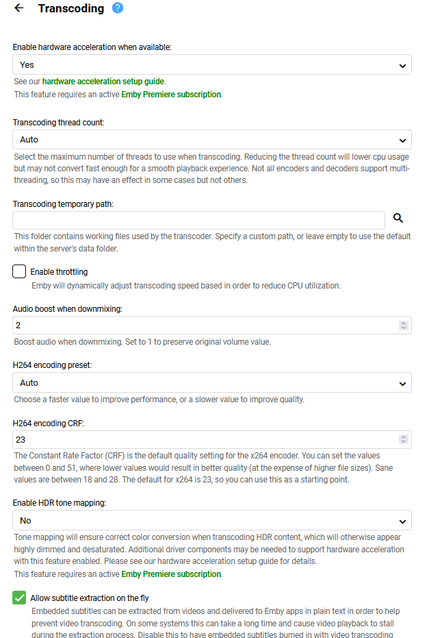

Eigeplackter 116 Posted December 25, 2022 Posted December 25, 2022 Whats your synology model ? What's in your transcode settings ?
