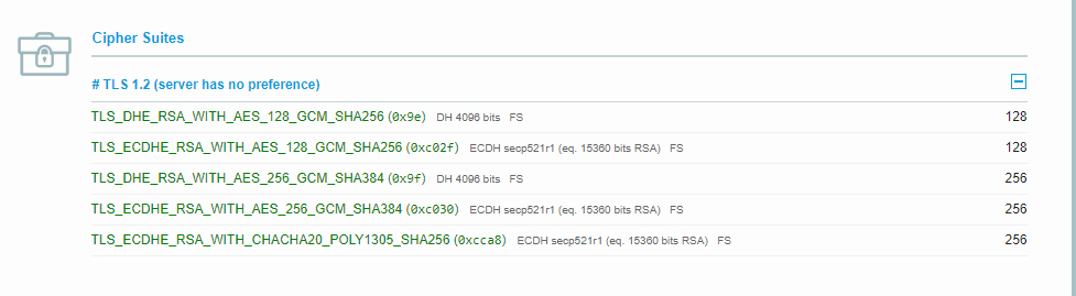

Happy2Play 9817 Posted January 16, 2023 Posted January 16, 2023 @GregMo Did you look at the ciphers suite? As I just enabled a couple on Windows 7 to allow it to work and not get the TLS alert: 'HandshakeFailure'. FanArt TLS 1.2 suite via SSLLabs.
GregMo 24 Posted January 16, 2023 Author Posted January 16, 2023 Where does one find that screen you're showing? I've checked everything I can find in IIS Crypto and it looks like all the TLS_ECDHE_* suites are enabled, but not the TLS_DHE_* suites.
Happy2Play 9817 Posted January 16, 2023 Posted January 16, 2023 1 minute ago, GregMo said: Where does one find that screen you're showing? I've checked everything I can find in IIS Crypto and it looks like all the TLS_ECDHE_* suites are enabled, but not the TLS_DHE_* suites. That was from ssllabs.com testing "https://assets.fanart.tv" server. But in ISSCrypto I enabled these. 2023-01-15 17:02:51.173 Info Main: Application path: C:\Users\Media\Desktop\Emby-Server\system\EmbyServer.dll 2023-01-15 17:02:51.751 Info Main: Emby Command line: C:\Users\Media\Desktop\Emby-Server\system\EmbyServer.dll Operating system: Microsoft Windows 6.1.7601 Service Pack 1 Framework: .NET 6.0.10 OS/Process: x86/x86 Runtime: C:/Users/Media/Desktop/Emby-Server/system/System.Private.CoreLib.dll Processor count: 1 Data path: C:\Users\Media\Desktop\Emby-Server\programdata Application path: C:\Users\Media\Desktop\Emby-Server\system 2023-01-15 17:05:50.699 Debug Server: http/1.1 Response 200 to ::1. Time: 1ms. http://localhost:8099/emby/Items/6/RemoteImages?Type=Thumb&Limit=50&X-Emby-Client=Emby Web&X-Emby-Device-Name=Google Chrome Windows&X-Emby-Device-Id=6e4026d8-306e-4940-91c3-03dee5a37f14&X-Emby-Client-Version=4.8.0.21&X-Emby-Language=en-us 2023-01-15 17:05:50.781 Debug Server: http/1.1 GET http://localhost:8099/emby/Images/Remote?imageUrl=https://assets.fanart.tv/fanart/tv/412366/tvthumb/dexter-new-blood-619150f38aa9b.jpg. UserAgent: Mozilla/5.0 (Windows NT 6.1) AppleWebKit/537.36 (KHTML, like Gecko) Chrome/109.0.0.0 Safari/537.36 2023-01-15 17:05:50.782 Debug Server: http/1.1 Response 304 to ::1. Time: 1ms. http://localhost:8099/emby/Images/Remote?imageUrl=https://assets.fanart.tv/fanart/tv/412366/tvthumb/dexter-new-blood-619150f38aa9b.jpg 2023-01-15 17:05:50.782 Debug Server: http/1.1 GET http://localhost:8099/emby/Images/Remote?imageUrl=https://assets.fanart.tv/fanart/tv/412366/tvthumb/dexter-new-blood-6193c335456b0.jpg. UserAgent: Mozilla/5.0 (Windows NT 6.1) AppleWebKit/537.36 (KHTML, like Gecko) Chrome/109.0.0.0 Safari/537.36 2023-01-15 17:05:50.783 Debug Server: http/1.1 Response 304 to ::1. Time: 1ms. http://localhost:8099/emby/Images/Remote?imageUrl=https://assets.fanart.tv/fanart/tv/412366/tvthumb/dexter-new-blood-6193c335456b0.jpg 2023-01-15 17:05:50.783 Debug Server: http/1.1 GET http://localhost:8099/emby/Images/Remote?imageUrl=https://assets.fanart.tv/fanart/tv/412366/tvthumb/dexter-new-blood-616e149bb0b0f.jpg. UserAgent: Mozilla/5.0 (Windows NT 6.1) AppleWebKit/537.36 (KHTML, like Gecko) Chrome/109.0.0.0 Safari/537.36 2023-01-15 17:05:50.783 Debug Server: http/1.1 Response 304 to ::1. Time: 0ms. http://localhost:8099/emby/Images/Remote?imageUrl=https://assets.fanart.tv/fanart/tv/412366/tvthumb/dexter-new-blood-616e149bb0b0f.jpg 2023-01-15 17:05:52.392 Info Server: http/1.1 POST http://localhost:8099/emby/Items/6/RemoteImages/Download?Type=Thumb&ImageUrl=https://assets.fanart.tv/fanart/tv/412366/tvthumb/dexter-new-blood-619150f38aa9b.jpg&ProviderName=FanArt&X-Emby-Client=Emby Web&X-Emby-Device-Name=Google Chrome Windows&X-Emby-Device-Id=6e4026d8-306e-4940-91c3-03dee5a37f14&X-Emby-Client-Version=4.8.0.21&X-Emby-Language=en-us. UserAgent: Mozilla/5.0 (Windows NT 6.1) AppleWebKit/537.36 (KHTML, like Gecko) Chrome/109.0.0.0 Safari/537.36 2023-01-15 17:05:52.393 Info HttpClient: GET https://assets.fanart.tv/fanart/tv/412366/tvthumb/dexter-new-blood-619150f38aa9b.jpg 2023-01-15 17:05:55.113 Debug ProviderManager: Saving image to C:\Users\Media\Desktop\Media\TV Shows\Dexter New Blood (2021)\landscape.jpg 2023-01-15 17:05:55.115 Info Server: http/1.1 Response 204 to ::1. Time: 2723ms. http://localhost:8099/emby/Items/6/RemoteImages/Download?Type=Thumb&ImageUrl=https://assets.fanart.tv/fanart/tv/412366/tvthumb/dexter-new-blood-619150f38aa9b.jpg&ProviderName=FanArt&X-Emby-Client=Emby Web&X-Emby-Device-Name=Google Chrome Windows&X-Emby-Device-Id=6e4026d8-306e-4940-91c3-03dee5a37f14&X-Emby-Client-Version=4.8.0.21&X-Emby-Language=en-us 2023-01-15 17:05:55.128 Debug Server: http/1.1 GET http://localhost:8099/emby/Users/cd25cc6eade44e3c814ebd95552c134f/Items/6?X-Emby-Client=Emby Web&X-Emby-Device-Name=Google Chrome Windows&X-Emby-Device-Id=6e4026d8-306e-4940-91c3-03dee5a37f14&X-Emby-Client-Version=4.8.0.21&X-Emby-Language=en-us. UserAgent: Mozilla/5.0 (Windows NT 6.1) AppleWebKit/537.36 (KHTML, like Gecko) Chrome/109.0.0.0 Safari/537.36 2023-01-15 17:05:55.129 Debug Server: http/1.1 Response 200 to ::1. Time: 1ms. http://localhost:8099/emby/Users/cd25cc6eade44e3c814ebd95552c134f/Items/6?X-Emby-Client=Emby Web&X-Emby-Device-Name=Google Chrome Windows&X-Emby-Device-Id=6e4026d8-306e-4940-91c3-03dee5a37f14&X-Emby-Client-Version=4.8.0.21&X-Emby-Language=en-us 2023-01-15 17:05:55.308 Debug Server: http/1.1 GET http://localhost:8099/emby/Users/cd25cc6eade44e3c814ebd95552c134f/Items/6?X-Emby-Client=Emby Web&X-Emby-Device-Name=Google Chrome Windows&X-Emby-Device-Id=6e4026d8-306e-4940-91c3-03dee5a37f14&X-Emby-Client-Version=4.8.0.21&X-Emby-Language=en-us. UserAgent: Mozilla/5.0 (Windows NT 6.1) AppleWebKit/537.36 (KHTML, like Gecko) Chrome/109.0.0.0 Safari/537.36 2023-01-15 17:05:55.310 Debug Server: http/1.1 Response 200 to ::1. Time: 2ms. http://localhost:8099/emby/Users/cd25cc6eade44e3c814ebd95552c134f/Items/6?X-Emby-Client=Emby Web&X-Emby-Device-Name=Google Chrome Windows&X-Emby-Device-Id=6e4026d8-306e-4940-91c3-03dee5a37f14&X-Emby-Client-Version=4.8.0.21&X-Emby-Language=en-us 2023-01-15 17:05:55.313 Debug Server: http/1.1 GET http://localhost:8099/emby/Items/6/Images?X-Emby-Client=Emby Web&X-Emby-Device-Name=Google Chrome Windows&X-Emby-Device-Id=6e4026d8-306e-4940-91c3-03dee5a37f14&X-Emby-Client-Version=4.8.0.21&X-Emby-Language=en-us. UserAgent: Mozilla/5.0 (Windows NT 6.1) AppleWebKit/537.36 (KHTML, like Gecko) Chrome/109.0.0.0 Safari/537.36 2023-01-15 17:05:55.314 Debug ImageProcessor: Getting image size for item Series C:\Users\Media\Desktop\Media\TV Shows\Dexter New Blood (2021)\landscape.jpg 1
GregMo 24 Posted January 16, 2023 Author Posted January 16, 2023 Okay, this is interesting. I verified with https://learn.microsoft.com/en-us/windows/win32/secauthn/tls-cipher-suites-in-windows-8 that those two suites are available on Win8 but they're not showing on IIS Crypto.
GregMo 24 Posted January 16, 2023 Author Posted January 16, 2023 Okay, more info. Apparently those two suites were added with an update that my system never received. The really cute thing is that I can't add the update now because Windows Update server requires updated SSL too.
