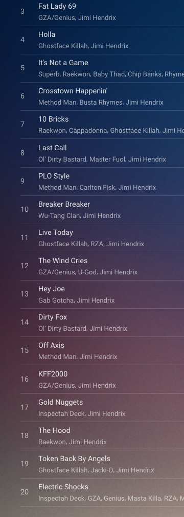

Bigmack3000 108 Posted March 4, 2023 Author Posted March 4, 2023 (edited) Kind of a separate issue, but I figure it's similar enough to keep it in this thread: If you look at the artists for this release: https://musicbrainz.org/release/fbd6df34-4f6f-47c5-9a6b-c78be2243508 GZA/Genius is in the whitelist for artists with " / " in their name. And it works if he's listed first in the track (As you can see in tracks 3, 12 and 16). But, in the last track he's listed 2nd, and emby then splits the name into two different artists. Which throws all the artist tags in that track off by one. I don't know what the fix would be, but I'm bringing it to your attention incase there is a way to keep white listed names together no matter where they are in the artist title. Edited March 4, 2023 by Bigmack3000
Happy2Play 9814 Posted March 4, 2023 Posted March 4, 2023 9 minutes ago, Bigmack3000 said: Kind of a separate issue, but I figure it's similar enough to keep it in this thread: If you look at the artists for this release: https://musicbrainz.org/release/fbd6df34-4f6f-47c5-9a6b-c78be2243508 GZA/Genius is in the whitelist for artists with " / " in their name. And it works if he's listed first in the track. But, in the last track he's listed 3rd, and emby then splits the name into two different artists. Which throws all the artist tags in that track off by one. I don't know what the fix would be, but I'm bringing it to your attention incase there is a way to keep white listed names together no matter where they are in the artist title. Only guess would be track tags. What does ffprobe show for the track?

Happy2Play 9814 Posted March 4, 2023 Posted March 4, 2023 16 minutes ago, Bigmack3000 said: oh you can edit artists in emby? Look like a fix would be changing the tag order from Inspectah Deck; GZA/Genius; Masta Killa; RZA; Method Man; Raekwon; Ghostface Killah; Jimi Hendrix to GZA/Genius;Inspectah Deck; Masta Killa; RZA; Method Man; Raekwon; Ghostface Killah; Jimi Hendrix But something for Luke to look at. 1
Bigmack3000 108 Posted March 4, 2023 Author Posted March 4, 2023 yea worst case, I'll put that artist first.
Luke 42287 Posted March 4, 2023 Posted March 4, 2023 Yes I see the issue with this example. Thanks. 1
