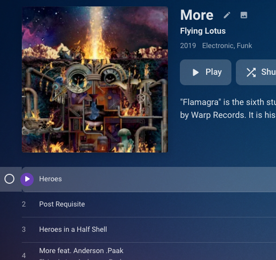

Bigmack3000 108 Posted February 3, 2023 Author Posted February 3, 2023 Anyone know what's going on here? The cd is called "Flamagra". The description lists it correctly. It was run through picard and tagged correctly. Every metadata link goes to the correct album. But for some reason, Emby insists on calling it "More". I attached one of the songs to see if there's hidden metadata I can't find. 01 Heroes.mp3
Happy2Play 9814 Posted February 3, 2023 Posted February 3, 2023 4 hours ago, Bigmack3000 said: Anyone know what's going on here? The cd is called "Flamagra". The description lists it correctly. It was run through picard and tagged correctly. Every metadata link goes to the correct album. But for some reason, Emby insists on calling it "More". I attached one of the songs to see if there's hidden metadata I can't find. 01 Heroes.mp3 No sure as everything looks correct on that track, but the track show Flamagra for me. C:\Users\Media>C:\Users\Media\AppData\Roaming\Emby-Server\system\ffprobe -i "C:\Users\Media\Downloads\1318738539_01Heroes.mp3.7b3be5d55fb260bed66f1cce57966e78.mp3" ffprobe version 5.1-emby_2022_11_29 Copyright (c) 2007-2022 the FFmpeg developers and softworkz for Emby LLC built with gcc 12.2.0 (Rev4, Built by MSYS2 project) Input #0, mp3, from 'C:\Users\Media\Downloads\1318738539_01Heroes.mp3.7b3be5d55fb260bed66f1cce57966e78.mp3': Metadata: title : Heroes artist : Flying Lotus track : 1/27 album : Flamagra disc : 1/1 genre : Electronic; Funk TBPM : 90 TKEY : Em MusicBrainz Release Group Id: 23a0d4ce-5421-4f35-afc4-49983c430edb TORY : 2019 publisher : Warp MusicBrainz Release Track Id: 7ba3d097-fbc8-41d7-8802-220eeccd3756 album_artist : Flying Lotus TSO2 : Flying Lotus artist-sort : Flying Lotus TSRC : GBBPW1900051 SCRIPT : Latn WORK : Heroes TMED : Digital Media originalyear : 2019 SERATO_PLAYCOUNT: 0 ARTISTS : Flying Lotus BARCODE : 0801061029135 CATALOGNUMBER : WARPCDD291 MusicBrainz Album Type: album MusicBrainz Album Status: official MusicBrainz Album Release Country: XW MusicBrainz Work Id: a2077c44-a8af-4aca-8dc3-3e33cf3b1f4c MusicBrainz Album Id: bb1ea9c5-0d0d-48ae-b3d7-eaa9ab4a903a MusicBrainz Artist Id: fc7376fe-1a6f-4414-b4a7-83f50ed59c92 MusicBrainz Album Artist Id: fc7376fe-1a6f-4414-b4a7-83f50ed59c92 date : 2019-05-24 Duration: 00:02:44.10, start: 0.025056, bitrate: 327 kb/s Stream #0:0: Audio: mp3, 44100 Hz, stereo, fltp, 320 kb/s, Start-Time 0.025s Metadata: encoder : LAME3.100 Side data: replaygain: track gain - -7.900000, track peak - unknown, album gain - unknown, album peak - unknown, Stream #0:1: Video: mjpeg (Baseline), yuvj420p(pc, bt470bg/unknown/unknown), 500x500 [SAR 1:1 DAR 1:1], 90k tbr, 90k tbn, Start-Time 0.025s (attached pic) Metadata: comment : Cover (front)
Bigmack3000 108 Posted February 3, 2023 Author Posted February 3, 2023 Thanks. So odd. I'll just rename it in emby, i guess.
Bigmack3000 108 Posted February 3, 2023 Author Posted February 3, 2023 hmmm. Alright, even if I change the name in emby. It still shows "More" as the title:
Vicpa 612 Posted February 3, 2023 Posted February 3, 2023 Hi @Bigmack3000 I will look at the track, next. But Just so you know even though it looks like you changed the name in emby you can't. Emby will not let you change the title of an album or an artist for that matter. ( @Happy2Play can you confirm that) Which seems incorrect to me... -vicpa
Happy2Play 9814 Posted February 3, 2023 Posted February 3, 2023 3 minutes ago, Vicpa said: Hi @Bigmack3000 I will look at the track, next. But Just so you know even though it looks like you changed the name in emby you can't. Emby will not let you change the title of an album or an artist for that matter. ( @Happy2Play can you confirm that) Which seems incorrect to me... -vicpa Correct as I believe it is all the linking per track. Can only guess something with the rest of the tracks.
Bigmack3000 108 Posted February 3, 2023 Author Posted February 3, 2023 here's the whole album. Archive.zip

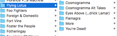

Happy2Play 9814 Posted February 3, 2023 Posted February 3, 2023 14 minutes ago, Bigmack3000 said: here's the whole album. Archive.zip 156.56 MB · 0 downloads Nothing stands out to me and imports correctly. Shouldn't matter but what is your structure? Can you remove album, done full scan, searched to ensure album no longer exists then readd.
Bigmack3000 108 Posted February 3, 2023 Author Posted February 3, 2023 folder structure is pretty normal. I tried removing the whole artist. rescanning. readding. still comes up as "More". I'm converting it to a different format and retagging it now as a different version of that album. just to completely erase any lingering metadata. Hail mary shot that that is the problem?
Happy2Play 9814 Posted February 3, 2023 Posted February 3, 2023 2 minutes ago, Bigmack3000 said: folder structure is pretty normal. I tried removing the whole artist. rescanning. readding. still comes up as "More". I'm converting it to a different format and retagging it now as a different version of that album. just to completely erase any lingering metadata. Hail mary shot that that is the problem? Okay what is in the More Album? But the files you provided show as Flamagra for me. Might need to add albums back individually.
