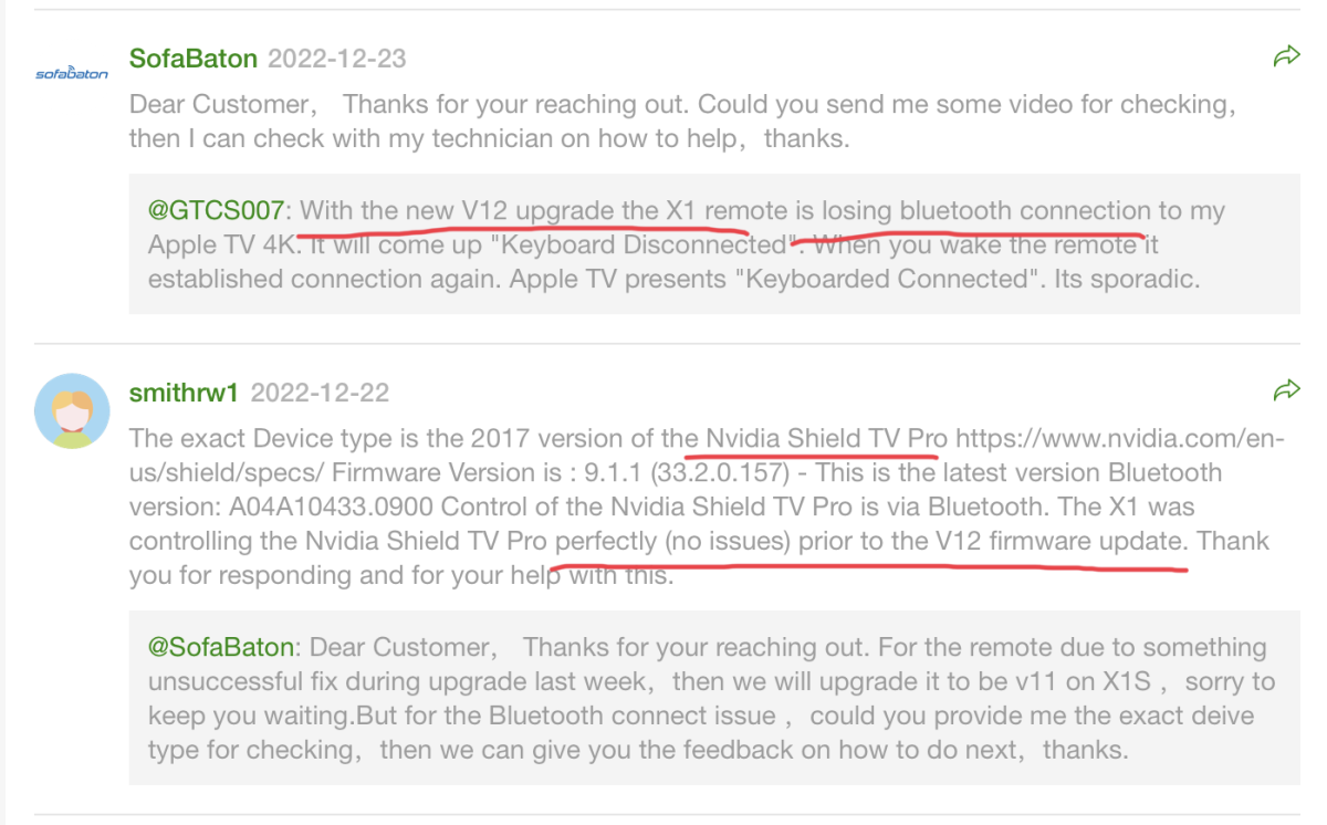

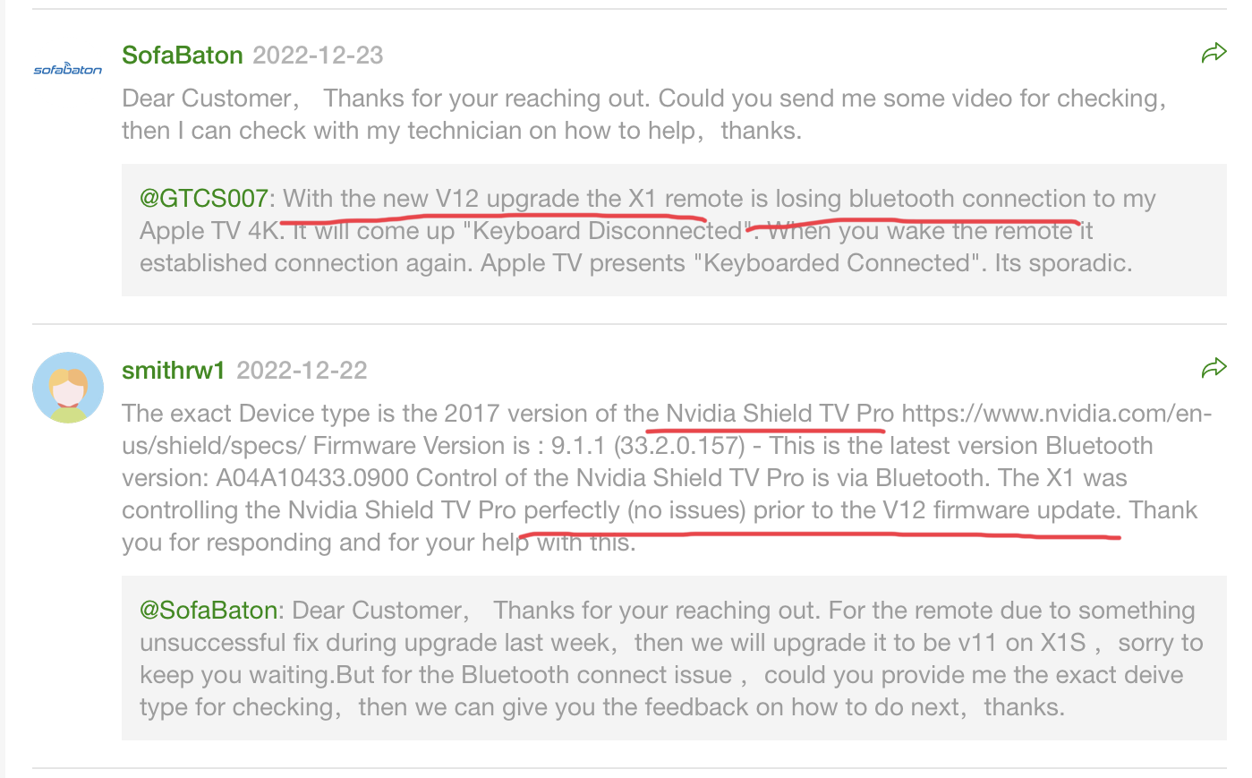

Glueckstiger 2 Posted December 23, 2022 Author Posted December 23, 2022 Can an interrupted bluetooth connection of the remote control cause this problem? I checked with a non-powered remote control hub and playback did not stop. It seems like an update from a few days ago is causing problems here.
ebr 16337 Posted December 24, 2022 Posted December 24, 2022 15 hours ago, Glueckstiger said: Can an interrupted bluetooth connection of the remote control cause this problem? I wouldn't think so but who knows... I guess if another update solves the BT connection issue and then this problem goes away, then that will tell us.
Glueckstiger 2 Posted December 25, 2022 Author Posted December 25, 2022 Since I updated the hub, the problem has not reoccurred. 1
