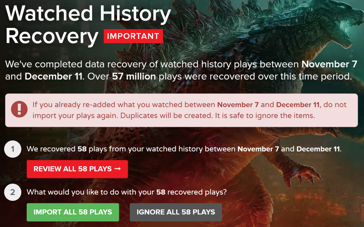

1- Go to https://trakt.tv/dashboard and review and import the Recovered History which Trakt was able to save.

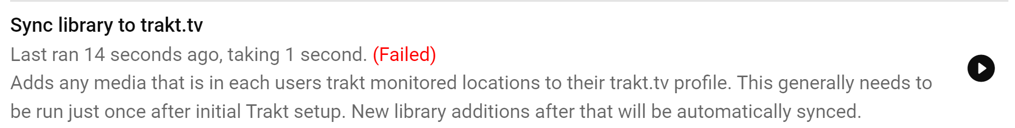

Next I tried to run the "Sync library to trakt.tv" Scheduled task to send all remaining watched history in Emby to Trakt. But this failed. Looks like the Emby trakt plugin needs to be re-authenticated.
