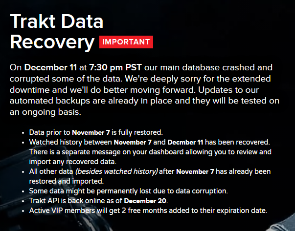

gberg 6 Posted December 21, 2022 Posted December 21, 2022 (edited) Are you getting Trakt to work, or isi it still not syncing watchet episodes anv movies? I get it to sync watched stuff up to 2022-12-15, but what I've watched after that doesn't get marked as watched on the Trakt site. I'm not sure how to interpret the message on the trakt site, but it sans that the API is back online as of December 20. So I guess it means it is supposed to work? Edited December 21, 2022 by gberg

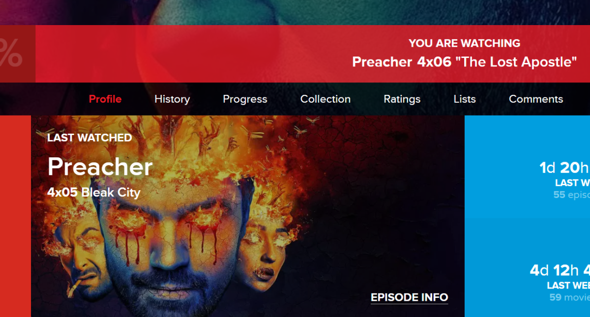

gberg 6 Posted December 21, 2022 Author Posted December 21, 2022 Now that I watch a TV-episode it does actually sync the watch status to the Trakt site, but still everything between December 15 and today is missing. Maybe that's what we should expected after the crach?

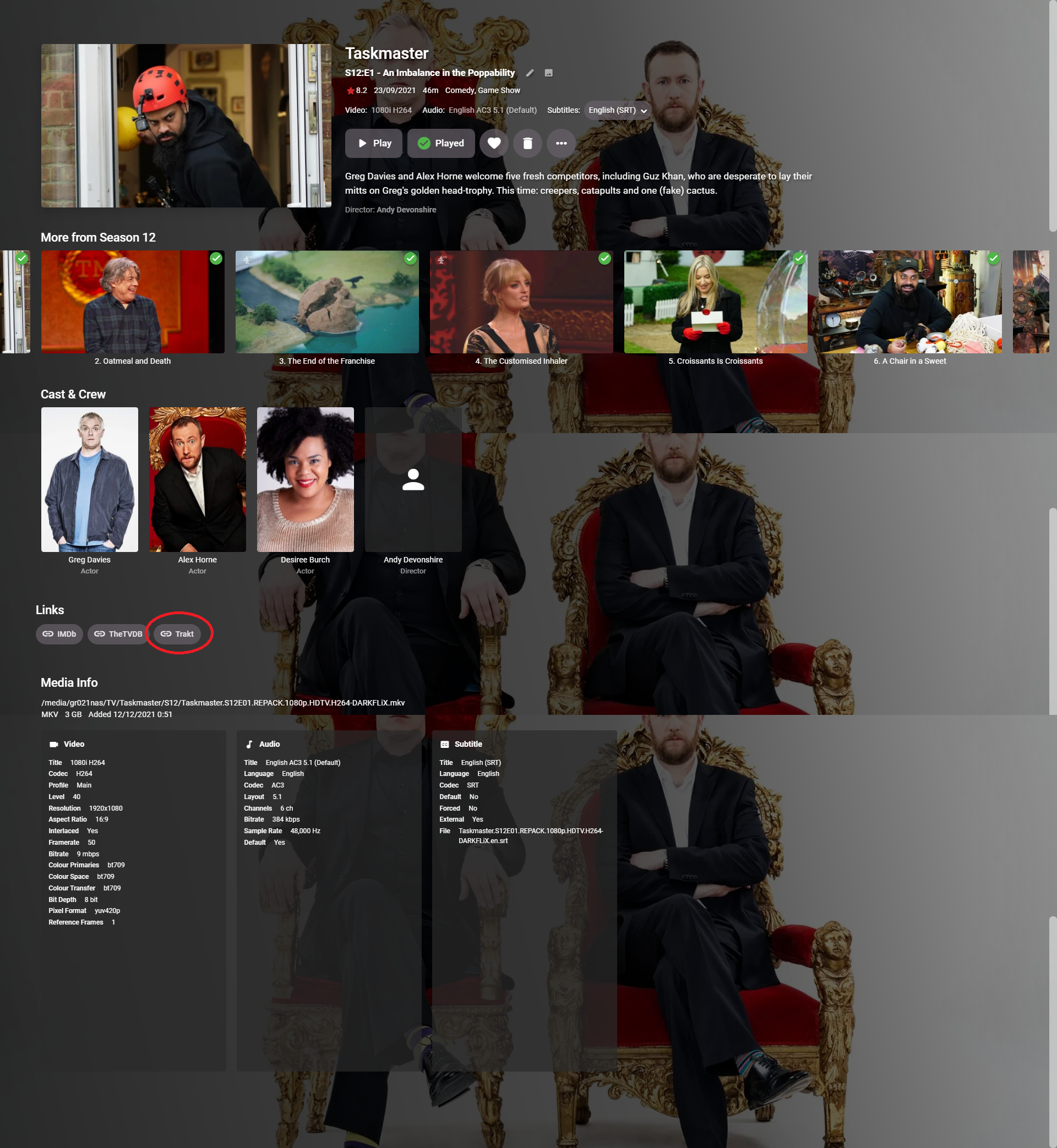

gberg 6 Posted December 21, 2022 Author Posted December 21, 2022 Another thing I notice is that the Trakt links on the episode pages are not working for the episodes not syncing to the Trakt site. Perhaps that has something to do with the issue?

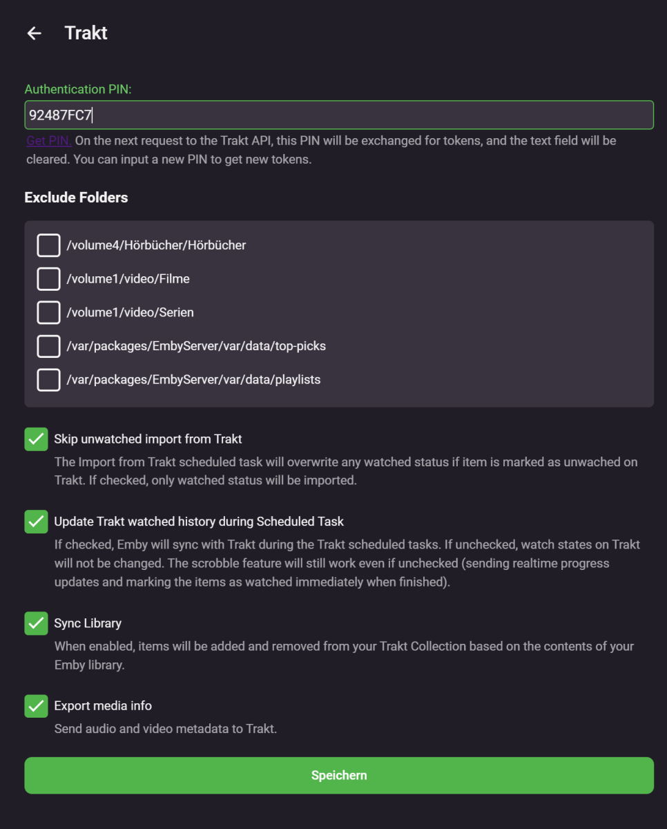

Eigeplackter 91 Posted December 21, 2022 Posted December 21, 2022 Just gave it a try myself and it's not working. Removed plugin - reboot - install plugin - reboot - got new PIN - sync fails - marked additional movie as watched - got new PIN - sync fails Settings (PIN of 1st try) Log attached embyserver (2).txt 1

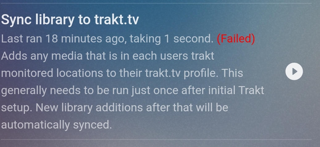

gberg 6 Posted December 21, 2022 Author Posted December 21, 2022 8 minutes ago, olliebean said: Mine didn't sync anything that I watched during the downtime, even after renewing the PIN. I had to copy those watches across manually from the Activity history. Ok, but shouldn't we be able to make Emby manually sync watched status by going to Scheduled tasks and "Sync library to trakt.tv"
MBSki 1114 Posted December 21, 2022 Posted December 21, 2022 14 minutes ago, gberg said: Ok, but shouldn't we be able to make Emby manually sync watched status by going to Scheduled tasks and "Sync library to trakt.tv" I've tried that after changing the pin and restarting the server and it's not working. It appears that the sync from Emby to Trakt.tv is broken. I'm not seeing anything from Emby getting synced to Trakt. Not even new watched progress since the fix. @Luke Can you look into this?
gberg 6 Posted December 21, 2022 Author Posted December 21, 2022 5 minutes ago, MBSki said: I've tried that after changing the pin and restarting the server and it's not working. It appears that the sync from Emby to Trakt.tv is broken. I'm not seeing anything from Emby getting synced to Trakt. Not even new watched progress since the fix. @Luke Can you look into this? Hmm, ok. For me new watched stuff actually seems to automatically sync to Trakt site.
MBSki 1114 Posted December 21, 2022 Posted December 21, 2022 6 minutes ago, gberg said: Hmm, ok. For me new watched stuff actually seems to automatically sync to Trakt site. What status do you see for this scheduled task?
Eigeplackter 91 Posted December 21, 2022 Posted December 21, 2022 46 minutes ago, Eigeplackter said: Just gave it a try myself and it's not working. Removed plugin - reboot - install plugin - reboot - got new PIN - sync fails - marked additional movie as watched - got new PIN - sync fails Settings (PIN of 1st try) Log attached embyserver (2).txt 63.39 kB · 1 download Funny thing is, even as job is still shown as failed, the actual watchstate on trakt.tv website is correct,; 1
gberg 6 Posted December 21, 2022 Author Posted December 21, 2022 (edited) 13 minutes ago, MBSki said: What status do you see for this scheduled task? Yes, it has always said (Failed) for me since way back, but it nevertheless it has actually synced watched stuff, I guess it fails because som movies and episodes are not found on Trakt. Edited December 21, 2022 by gberg 1
MBSki 1114 Posted December 21, 2022 Posted December 21, 2022 Interesting, ok. Too bad we can't rely on the scheduled task status. Sadly I'm not getting anything updated from after December 11th.
Eigeplackter 91 Posted December 21, 2022 Posted December 21, 2022 Did you login on trakt website ? There comes up the question how to proceed with the possible playstates in the downtime, you can import or discard em. Maybe you have to do that before new states are added.
MBSki 1114 Posted December 21, 2022 Posted December 21, 2022 6 minutes ago, Eigeplackter said: Did you login on trakt website ? There comes up the question how to proceed with the possible playstates in the downtime, you can import or discard em. Maybe you have to do that before new states are added. Yep, did that and it added everything up to Dec 11. Since Dec 11 is when it crashed, Trakt wouldn't have anything after. All that is in Emby, but since the sync isn't working I can't get those plays into Trakt. Unless I just copy manually of course, but since new plays aren't working either it seems something is still not working correctly.

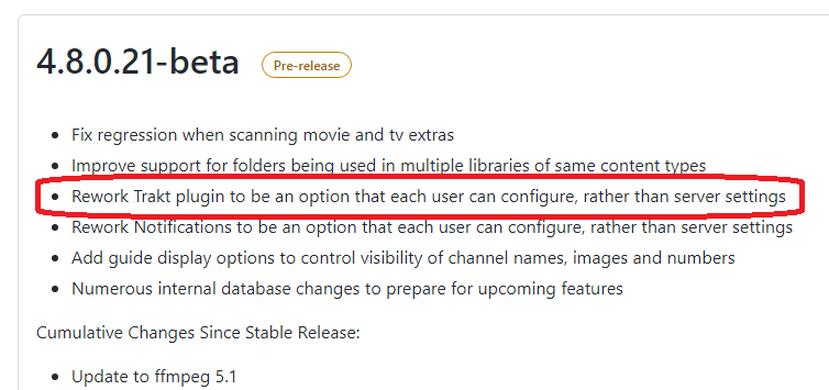

gberg 6 Posted December 21, 2022 Author Posted December 21, 2022 4 minutes ago, gberg said: OK, Glad you got it kinda working again. And by the way, I looked at the github release notes for Emby thet the trakt plugin probably will be reworked so that users themselves rather than the server admin will configure the Trakt authentication, which I think is a great idea. 1
Eigeplackter 91 Posted December 21, 2022 Posted December 21, 2022 Yeah I'm running the beta. Nice change. 1
