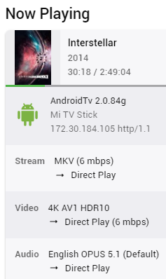

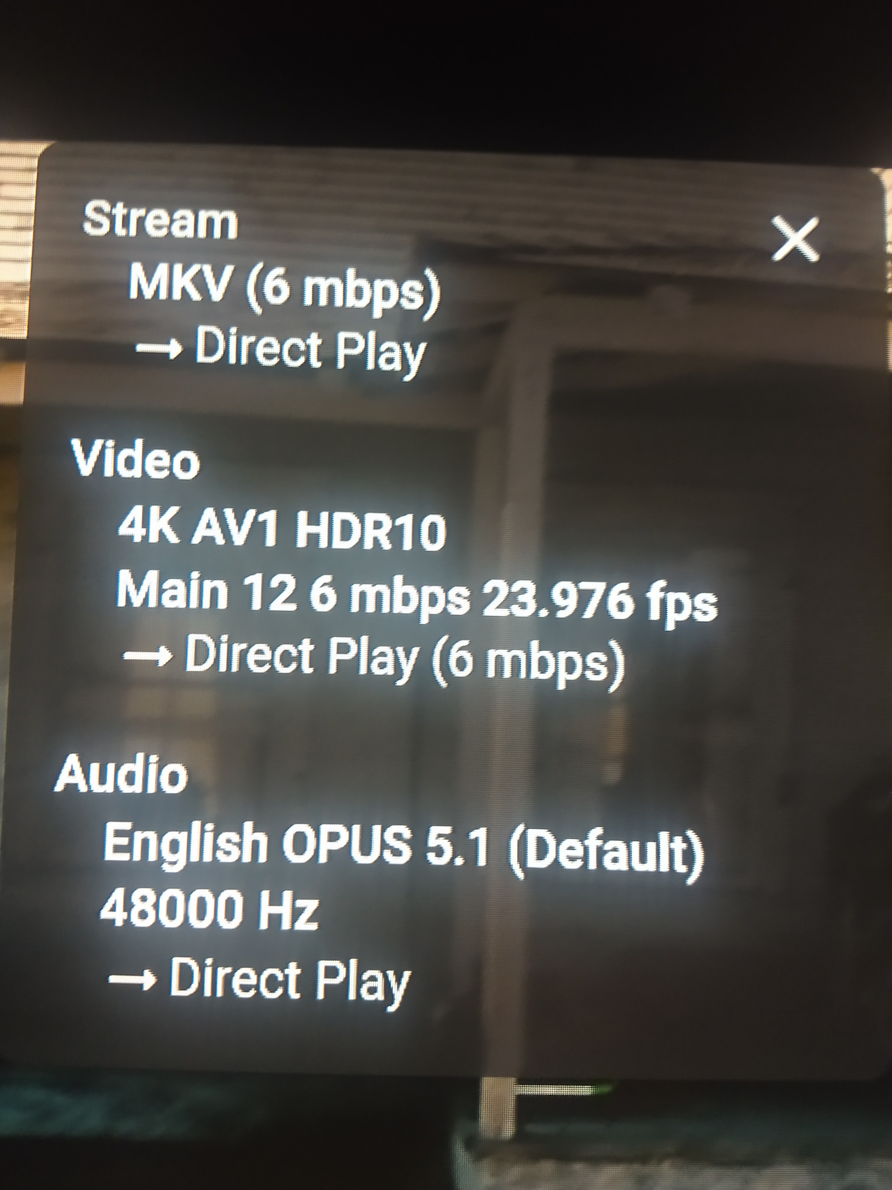

hbbs 8 Posted December 21, 2022 Author Posted December 21, 2022 (edited) A new BETA version of Emby for Android TV was released today. Version: 2.0.84g It caught my attention that the first line in the changelog were about the subject of this topic. It can't be a coincidence. Anyhow, thanks for solving this @ebrand everyone else who was involved. This issue is solved. At least on my end. @VirulentPipyou'll need to subscribe to the Beta of Emby for Android TV to get this one. It can be done on the Google Play Store (smartphone, Desktop..) Edited December 21, 2022 by hbbs Insert screen capture 1

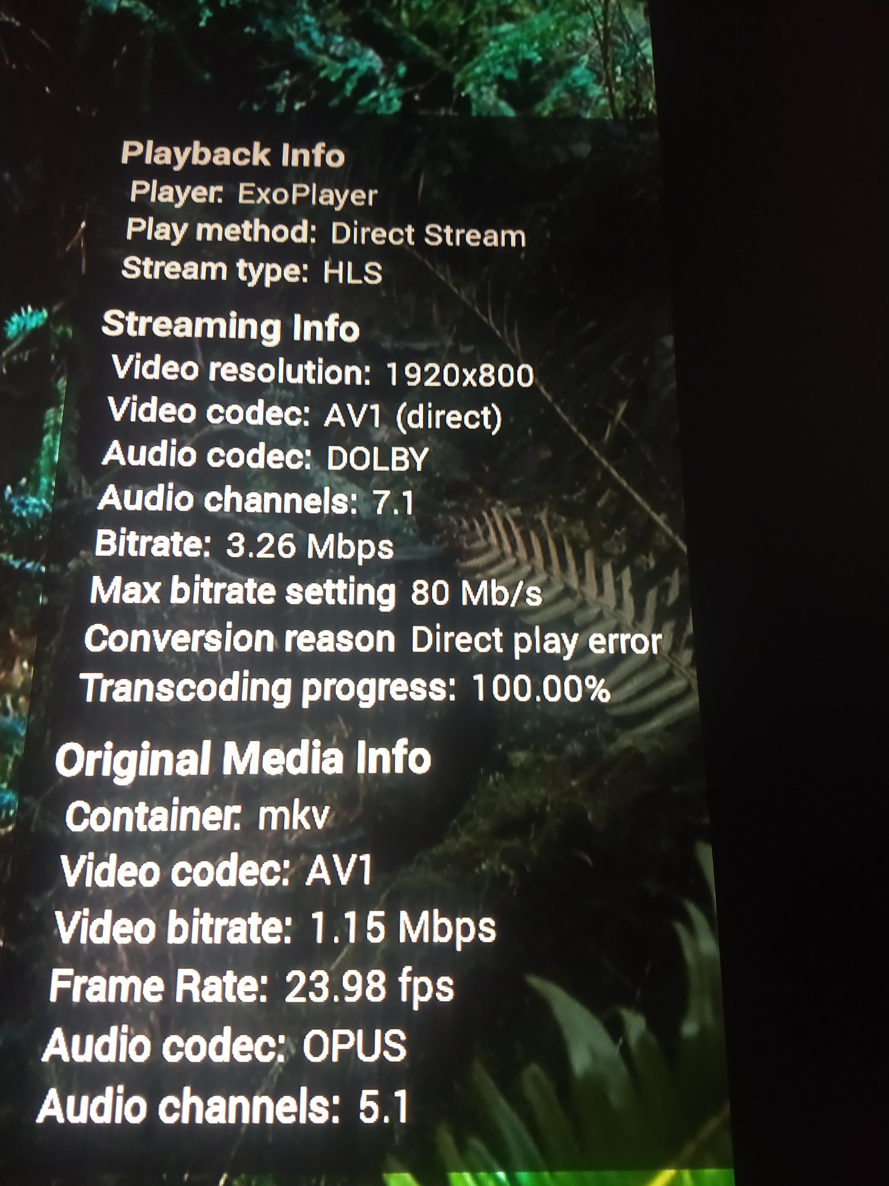

hbbs 8 Posted December 21, 2022 Author Posted December 21, 2022 (edited) It is definitely a pattern. It just doesn't work. The audio is remuxed to AC3 but the image freezes out right at the moment when I click to playback correct. it never picks up from there. Any other ideas? Should I open another thread about this? Edited December 21, 2022 by hbbs
hbbs 8 Posted December 21, 2022 Author Posted December 21, 2022 The reason I inserted the image on the post above was to highlight that the audio was already 100% remuxed and still no video image (besides that one in the cameta shot) is shown. Not even If I start to jump chapters. Nothing happens on the video image side. Only audio updates correctly.

ebr 16337 Posted December 21, 2022 Posted December 21, 2022 17 hours ago, hbbs said: It just doesn't work. The audio is remuxed to AC3 but the image freezes out right at the moment when I click to playback correct. it never picks up from there. That tells me that we cannot stream copy AV1 in HLS. We have similar issues with HEVC in some instances.
