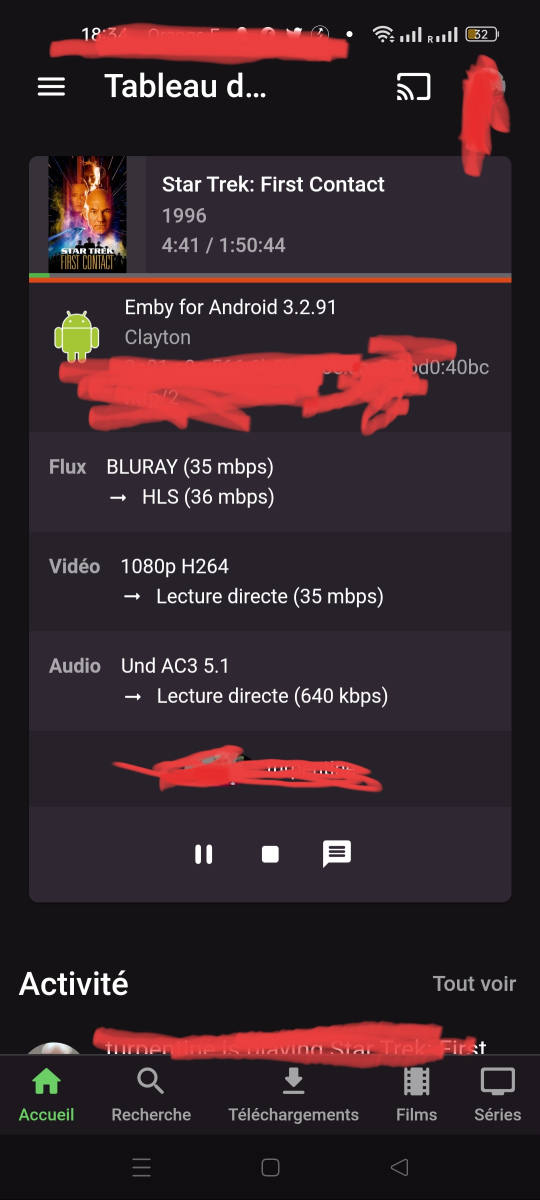

turpentine 17 Posted January 4, 2023 Posted January 4, 2023 (edited) It is very funny i have the same creepy playback on my Brand best seller new Google android tv Chromecast. Every exact 2 second the player just hangs for a half second And then resume at even 1080 full blu-ray bitrates on a 1gb fiber FTTH connection. Stream Blu-Ray to hls Video h264 Direct play Audio AC3 direct play What Is more funny is the very old Chromecast ultra 4k which has not android Inside can stream with no issues. Seems that the Google tv playstore has a retarded emby app. Update : even the last classic android apk installed manualy by send files to tv app instead of Google tv official apk. Same playback. The Chromecast 4k with android tv Is the worst emby app that i have ever tested since i use emby for years now. Newer Is better ? I doubt Edited January 4, 2023 by turpentine

turpentine 17 Posted January 19, 2023 Posted January 19, 2023 (edited) VID20230119185353.mp4 @Lukeunfortunately with the New version apk the issue Is still the same on my Chromecast 4k with Google tv android. Audio Is ok but Blu-ray direct play video playback Is still pausing every second for a quater of a sec then resume but audio Is never pausing. Edited January 19, 2023 by turpentine
Luke 42243 Posted January 20, 2023 Posted January 20, 2023 On 1/19/2023 at 12:49 PM, turpentine said: VID20230119185353.mp4 34.21 MB · 0 downloads @Lukeunfortunately with the New version apk the issue Is still the same on my Chromecast 4k with Google tv android. Audio Is ok but Blu-ray direct play video playback Is still pausing every second for a quater of a sec then resume but audio Is never pausing. It's possible that the bitrate is just too high for the network connection to keep up with.
turpentine 17 Posted January 20, 2023 Posted January 20, 2023 (edited) 2 hours ago, Luke said: It's possible that the bitrate is just too high for the network connection to keep up with. i do not think so, speed test on this wifi chromecast goes up to 250 mbps. for exemple a 4k hevc mkv file (remux) (with bitrate around 100 mbps) instead of simple bluray folder plays perfectly on the same device (a google tv 4k chromecast dongle behind this tv). it really seams there is a problem only on h264 1080p bluray folder around 35 mbps. Edited January 20, 2023 by turpentine
