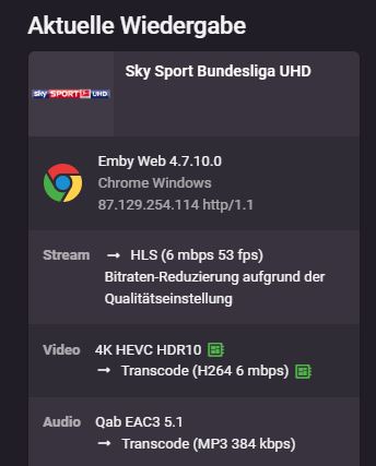

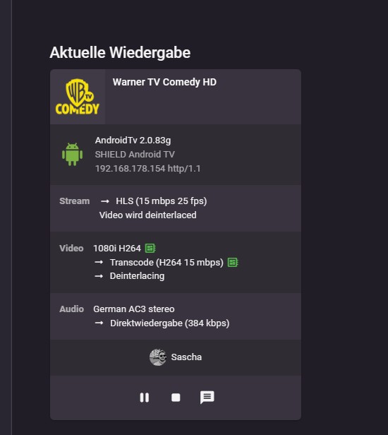

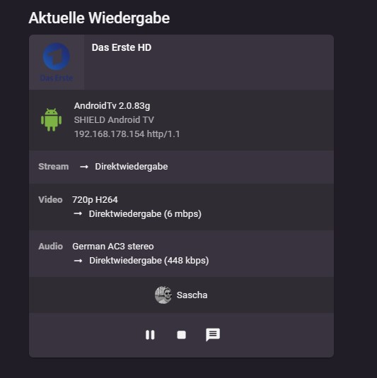

taker1988 21 Posted December 15, 2022 Posted December 15, 2022 Hey, when im watching a channel with 720p, than emby does "direct play" the stream. But if I am streaming a 1080i channel, Emby starts to transcode it cause deinterlacing. I am using the Embyapp on my ShieldTV Pro 2019...I set it up, that it should direct play a channel and also i checked the "copy stream" option. But it seems that those options getting ignored. Am I doing something wrong? I dont want to use transcoding when I am watching TV. Not on local network and not when I am not at home. (But if I am watching a Movie, e.g. a 4k-Movie with Atmos sound, than i want to transcode when I am not at home) PS: When I am watching a UHD channel with "p" not "i", it shows me HEVC and EAC3 5.1 Sound...Than both are transcoding. Is this also normal? Is this possible? Or do I get those transcoding options wrong?
Sammy 795 Posted December 15, 2022 Posted December 15, 2022 Android TV devices don't play interlaced content so Emby Server Transcodes it to progressive.

ebr 16934 Posted December 15, 2022 Posted December 15, 2022 Hi. There are additional options in the playback settings in the app for whether or not to de-interlace on the server. You can try these but how well it works will depend on your display.
