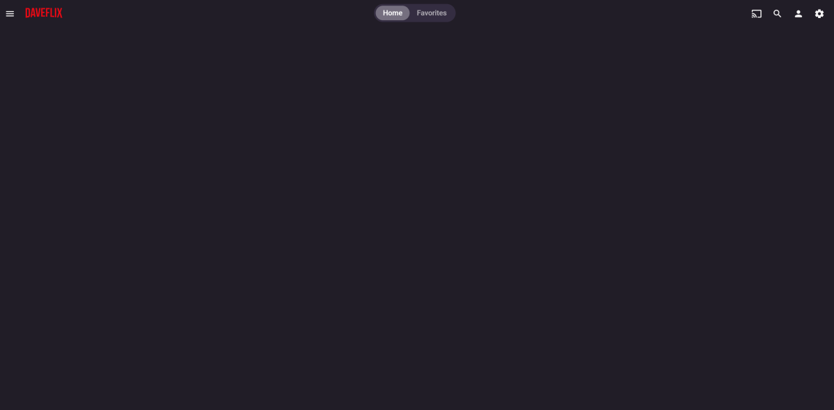

diablopants 1 Posted December 14, 2022 Posted December 14, 2022 I am running emby server 4.7.0.10 from the official docker image. Everything was running fine. Then, I got curious as to what BETA had to offer. Everything is not fine. So, I replaced the latest (stable) docker image with the Beta image to see what new things it had to offer and it would only show the splash screen. So, I replaced the Beta image with the image I was originally using (4.7.0.10) and now I can actually get to my webui but nothing else loads (see attached photo) I am a dev-ops engineer and will be receiving a 10 year employment award tomorrow morning....yeah..../sigh...attached is my log. embyserver (1).txt
Luke 42245 Posted December 14, 2022 Posted December 14, 2022 Hi, can you try clearing browsing data and see if that helps? Since I can see you customized the server logo, you'll probably want to undo any other changes like that in order to rule them out.
Happy2Play 9812 Posted December 14, 2022 Posted December 14, 2022 Per the log I can see these are not independent images. Since you went to beta server you cannot downgrade as the log shows plugin load exeptions. There are DB changes making it no longer compatible with 4.7. Suspect you have to start a new database or revert back to 4.8.0.21. 1
Luke 42245 Posted December 15, 2022 Posted December 15, 2022 Ah I totally missed that. Why did you downgrade from beta to stable?
