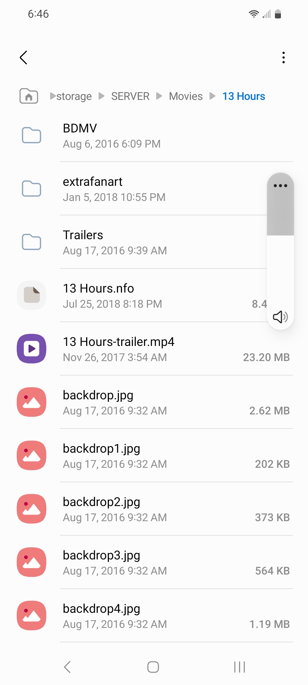

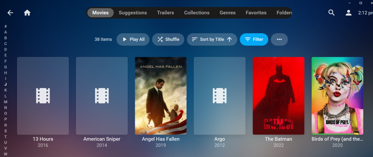

Mopar_Mudder 14 Posted December 11, 2022 Posted December 11, 2022 This has been an issue for a long time, just haven't had time to deal with it. Are work for most of my movies is not showing up even though it is in the movie folder and it was working. Does not show int he detail screen either.
Luke 42186 Posted December 11, 2022 Posted December 11, 2022 Hi, what exactly is in the 13 hours folder?

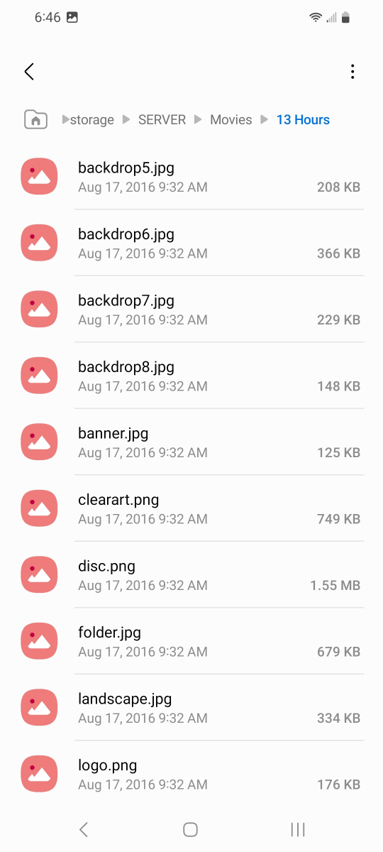

Mopar_Mudder 14 Posted December 12, 2022 Author Posted December 12, 2022 Here are screen shots of the folder
Luke 42186 Posted December 12, 2022 Posted December 12, 2022 What version of the server are you running?
Happy2Play 9800 Posted December 12, 2022 Posted December 12, 2022 Looks correct can you post server log. What client is that? Not familiar with alpha picker on the left.
Mopar_Mudder 14 Posted December 12, 2022 Author Posted December 12, 2022 It is theater. Does the same in web browser and Android app. I hope this is the correct log embyserver-63806313600.txt

Mopar_Mudder 14 Posted December 12, 2022 Author Posted December 12, 2022 Not that I know of. All movies are in the same share so why would some show and not others? I got the file list I posted going in throught the share.
Mopar_Mudder 14 Posted December 19, 2022 Author Posted December 19, 2022 Any other ideas on this, I can find nothing wrong with the server. I just was doing some more looking, and I am not 100% positive but I think all the ones that are not showing up are BluRay that are in folder format instead of MKV, this is back from when Emby actually supported folders for BluRay. All the ones showing cover are are either MKV or DVD folders.
Luke 42186 Posted December 20, 2022 Posted December 20, 2022 11 hours ago, Mopar_Mudder said: Any other ideas on this, I can find nothing wrong with the server. I just was doing some more looking, and I am not 100% positive but I think all the ones that are not showing up are BluRay that are in folder format instead of MKV, this is back from when Emby actually supported folders for BluRay. All the ones showing cover are are either MKV or DVD folders. So you have an mkv version of the movie right next to the bdmv folder?
seanbuff 1353 Posted December 20, 2022 Posted December 20, 2022 35 minutes ago, Luke said: So you have an mkv version of the movie right next to the bdmv folder? Not according to OP's screenshots above. Has there been a change to BDMV support recently?
Mopar_Mudder 14 Posted December 20, 2022 Author Posted December 20, 2022 11 hours ago, Luke said: So you have an mkv version of the movie right next to the bdmv folder? No their is no MKV, just the BDMV folders. The covers that work are just MKV or just DVD folder
Mopar_Mudder 14 Posted December 22, 2022 Author Posted December 22, 2022 (edited) OK so get this. My folder structure is /Movies/5 Days of War/BDMV nfo and art work is in /Movies/5 Days of War/ folder I deleted all the art work, left the nfo file from the /Movies/5 Days of War/ folder Then I told Emby to refresh and replace all the meta data It put a NEW nfo file and new artwork file in the /Movies folder, not in the /Movie/5 Days of War folder I do have cover art now for that movie now somehow. I don't know what is going on but it seems pretty messed up.... Oh an now every movie that was not showing a cover has the 5 Days of way cover LOL Edited December 22, 2022 by Mopar_Mudder
Mopar_Mudder 14 Posted December 22, 2022 Author Posted December 22, 2022 Ok I did some more setting and might be getting more confused. Deleting the existing art and nfo file, actually deleting everything except the BDMV and Certificate folder. Then telling Emby to update the meta data always results in the meta data being put in the root Movie folder, not in the actual movies folder. If I create a new folder, then copy the BDMV folder and Certificate folder into it. Emby picks it up as a new movies and puts the cover art in the actual movie folder where it belongs but the nfo file goes in the BDMV folder. Clear as mud right
Luke 42186 Posted December 27, 2022 Posted December 27, 2022 Hi, yes this was a change made a couple years ago. The nfo does get saved in the bdmv folder for new titles.
