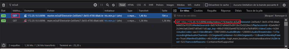

Fares1611 0 Posted December 12, 2022 Author Posted December 12, 2022 Sorry I hit the wrong button just before, to be clearer, before I managed to retrieve the HLS link of a video from my library thanks to the "development tool" of my browser then I put an m3u8 filter and I retrieved the HLS link as can be seen below: And now I can't Please help me
