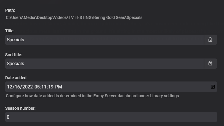

Happy2Play 9811 Posted December 17, 2022 Posted December 17, 2022 (edited) I stand corrected as after the scan finished, I was back to 3 folders. But is does have to do with the Specials folder as BGS Specials still failed as it is not recognized as a Season folder. But Specials alone is recognized as Season 0. Needs to comply with KB Specials Or manually assign Season number per Special folder and do another library scan. And the extend Specials/Extras I believe only apply to 4.8. Edited December 17, 2022 by Happy2Play

KLF&TLF 28 Posted December 17, 2022 Author Posted December 17, 2022 I believe now this has fixed the problem. After following the directions in your TV naming support I had my folder structure as Specials while this works for some it doesn't work for all. I thought after my midnight sitting at the computer going through all my drives that maybe it was also my series name in the directory that was throwing it out but that wasn't the case as it worked perfectly for me on everything bar reality. So I finally settled on Name of Series/Shortened Name of Series Season X/File /Homeland/Homeland Season 0/Homeland S00E1001.mkv /Bering Sea Gold/BSG Season 0/BSG S00E1301.mkv So let me explain my naming convention for the file as this is different to your instructions S00 is referencing the Special the E1301 references the special came out in Season 13 and it is the first special of the season. Since some reality shows do multiple specials through out the season it was easier to name the specials the season then incremental. I get that it won't match TVDMB or IMDB but I manually update those. So thanks 1
