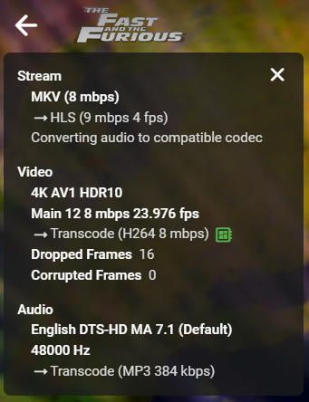

tgurath 7 Posted December 9, 2022 Author Posted December 9, 2022 Theater version 3.0.19 fixed the broken HDR playback in Theater version 3.0.18, so thanks for that. Now I can watch other content using Theater to avoid this transcoding issue while I'm encoding stuff in AV1 in the background. Logs and screenshots of "stats for nerds" from Theater and Vivaldi are attached. You can see the reason given for transcoding is audio but it's also unnecessarily transcoding the video. Also, if the transcode is truly using my gpu I'm surprised the playback is so terrible. Not just stuttery but long pauses. My CPU is maxed out encoding AV1 in the background but my GeForce should be idle. I restarted the server so you'd get clean logs. The movie I tested was The Fast and the Furious if you want to search for that but there's nothing else in there anyway. embyserver-63806231364.txt ffmpeg-transcode-22e158f5-896c-4aae-b951-fa0ce0d05b2e_1.txt hardware_detection-63806231393.txt
ebr 16307 Posted December 9, 2022 Posted December 9, 2022 2 hours ago, tgurath said: You can see the reason given for transcoding is audio but it's also unnecessarily transcoding the video Hi. Once we have to convert audio, then it has to be re-packaged into HLS which then restricts what video formats can be delivered.
