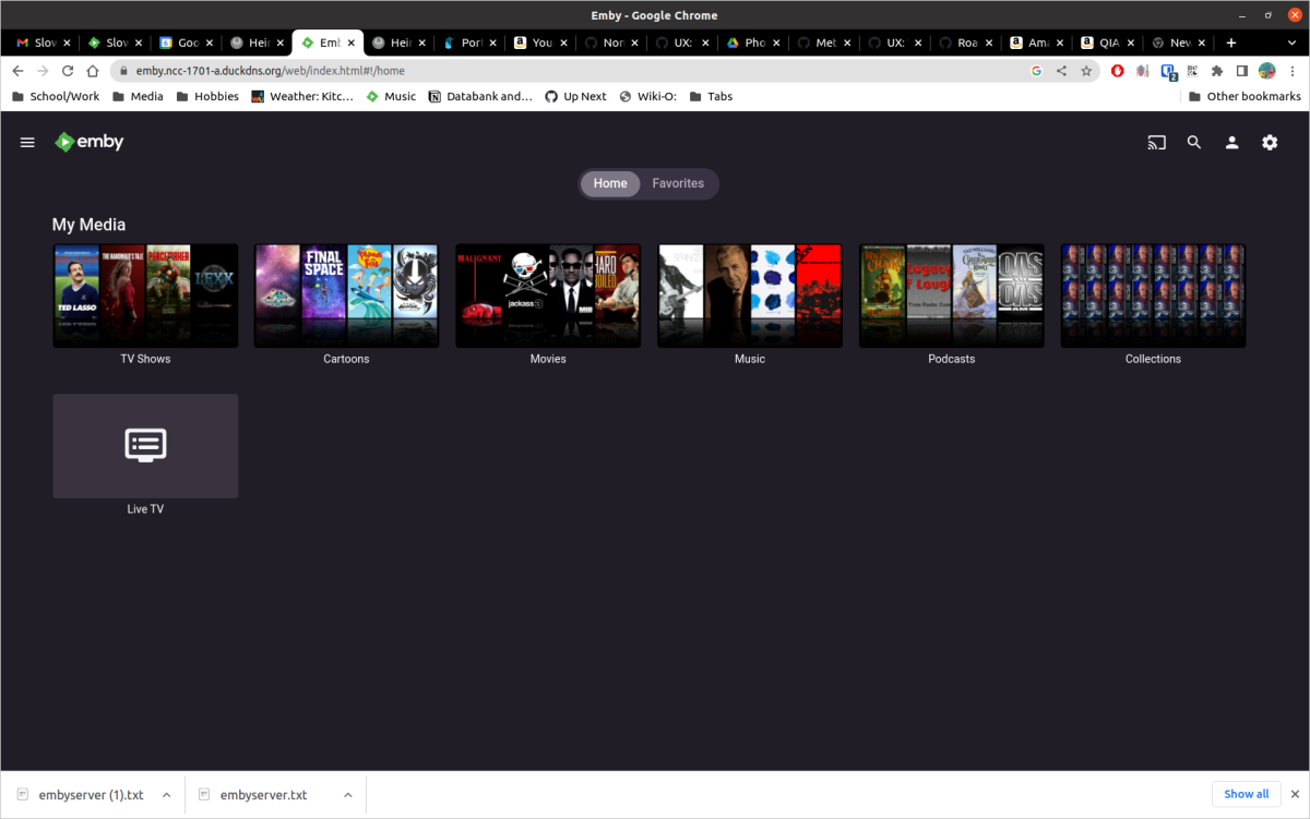

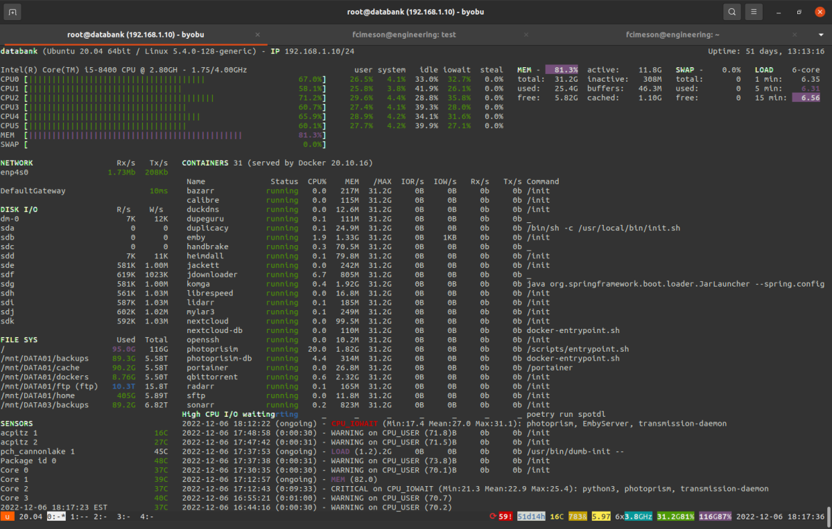

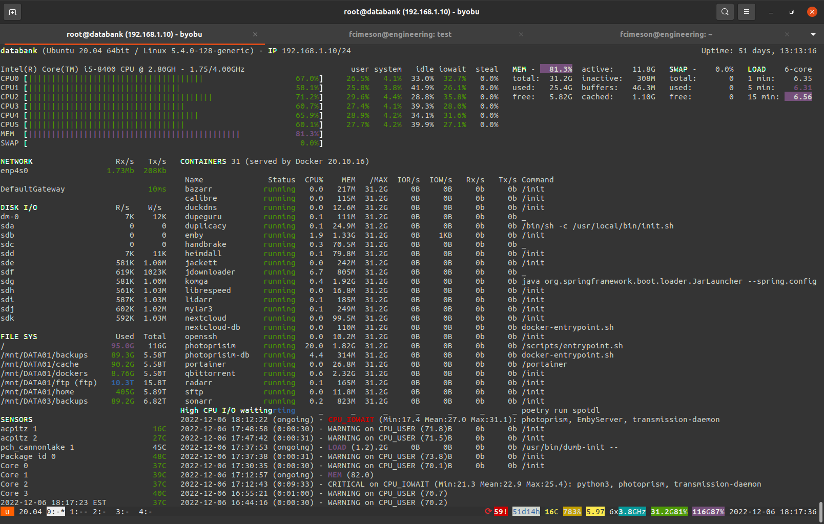

fcimeson 11 Posted December 6, 2022 Author Posted December 6, 2022 (edited) Another incident at 18:13. embyserver.txt 3 Minutes later and it's still isn't showing anything more than the My Media row (Smart TV). The web browser shows slightly more. The server doesn't seem to be loaded down too much either (i5-8400), although this is more load then it's normally under. Regardless, this problem seems to happen frequently. A refresh at 18:20 fixed the browser. embyserver.txt Edited December 6, 2022 by fcimeson
