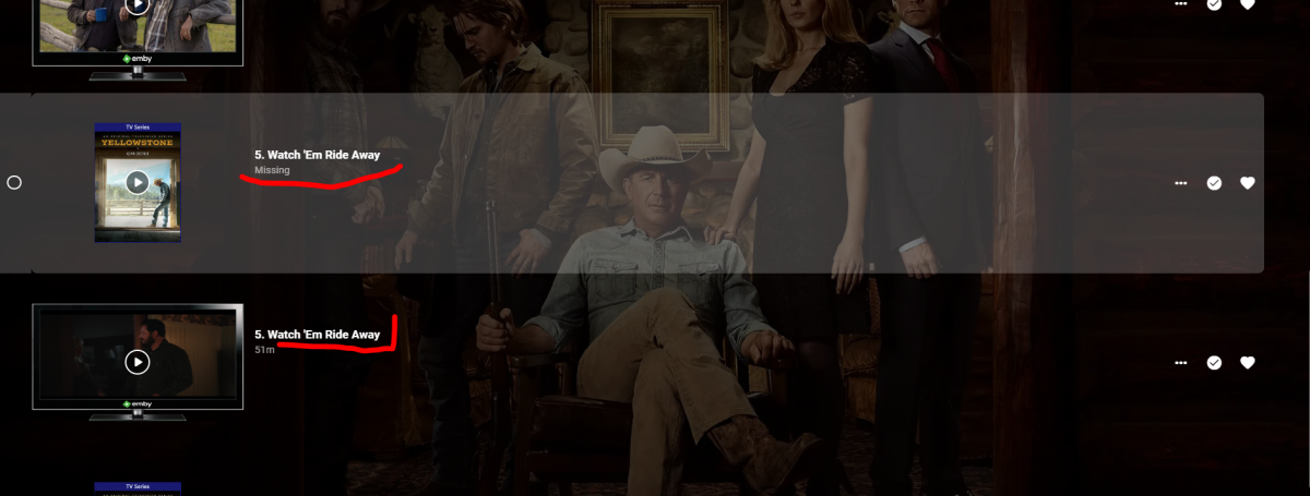

michalkaluza 8 Posted December 5, 2022 Posted December 5, 2022 (edited) Hi, Recently noticed that emby incorrectly recognizes episodes. On the list shows that episode is missing, but the episode appears as a anothe position on the list. Below screens. The name of file is ok. Edited December 5, 2022 by michalkaluza
Luke 42186 Posted December 5, 2022 Posted December 5, 2022 Hi, why exactly do you think they're not recognized?
michalkaluza 8 Posted December 5, 2022 Author Posted December 5, 2022 (edited) as you can see on screen: Yelowstone episode 5 is missing, below is episode 5 one more time. But the emby do not see the episode 5. Status is missing. Because of that there is no info about the episode. Edited December 5, 2022 by michalkaluza
pwhodges 2024 Posted December 5, 2022 Posted December 5, 2022 First thing to check is the file names and folder structure for that season. What are they? Paul
michalkaluza 8 Posted December 5, 2022 Author Posted December 5, 2022 I changed all names of files in this season using filebot. Now the order is ok. All episodes recognized.

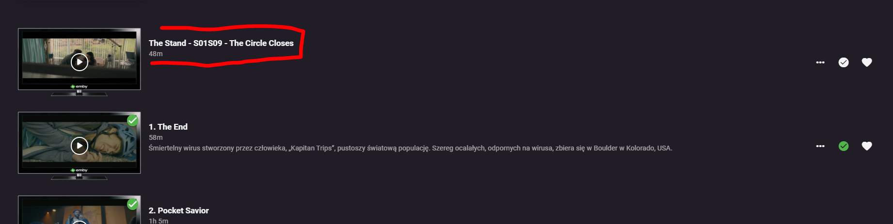

ebr 16307 Posted December 6, 2022 Posted December 6, 2022 Hi. I believe you had two issues here: 1) "The Stand" was named incorrectly. Looks like the filename had S09S09 instead of S09E09. 2) In order for previously missing episodes in your library to reconcile when they are added, a full library scan needs to run. I just probably hadn't yet.
