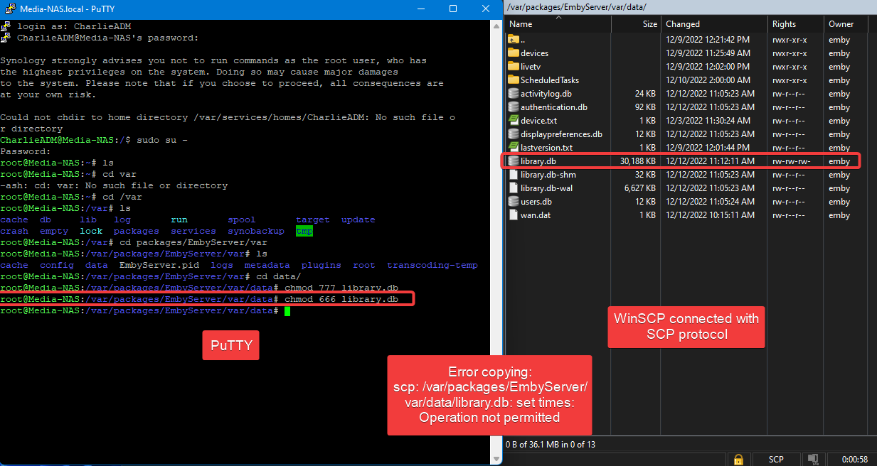

MagicPinball 3 Posted December 12, 2022 Author Posted December 12, 2022 (edited) I was able to change the permission as shown in WinSCP, but the copy still didn't work. Edited December 12, 2022 by MagicPinball

Happy2Play 9811 Posted December 20, 2022 Posted December 20, 2022 6 minutes ago, Luke said: is Emby Server on Synology running when you try to do this? Make sure to shut it down first. You won't be able to replace the file while the server is using it. @MagicPinball Per the image all other dbs are closed so it suggests the library.db did not close properly.
