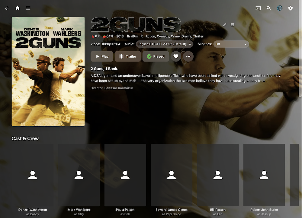

I just reinstalled Emby and re-imported my media using the NFO reader setting.  All of my media imported great and things are going well.
However, since I imported from NFO files, Emby didn't go out to TMDB to fetch 'people' images.  Thus, all of my movies look like the attached image ... no headshots.
I keep my MediaItems locked to prevent undesirable changes to my metadata.  WITHOUT unlocking the metadata for each individual movie, is there a way that I can download headshots and metadata for the people in my database?  Like a "Refresh People" option?
Once upon a time, I feel like I remember "People" being in the Metadata Manager ... but there doesn't appear to be a "People" section anymore. 😞
Hi, if you run the scheduled task to scan the metadata folder, then you might get some of them back. The rest you will have to solve by refreshing the metadata on the movies or series. I understand your use case, that's just an open issue with it right now. Thanks.
