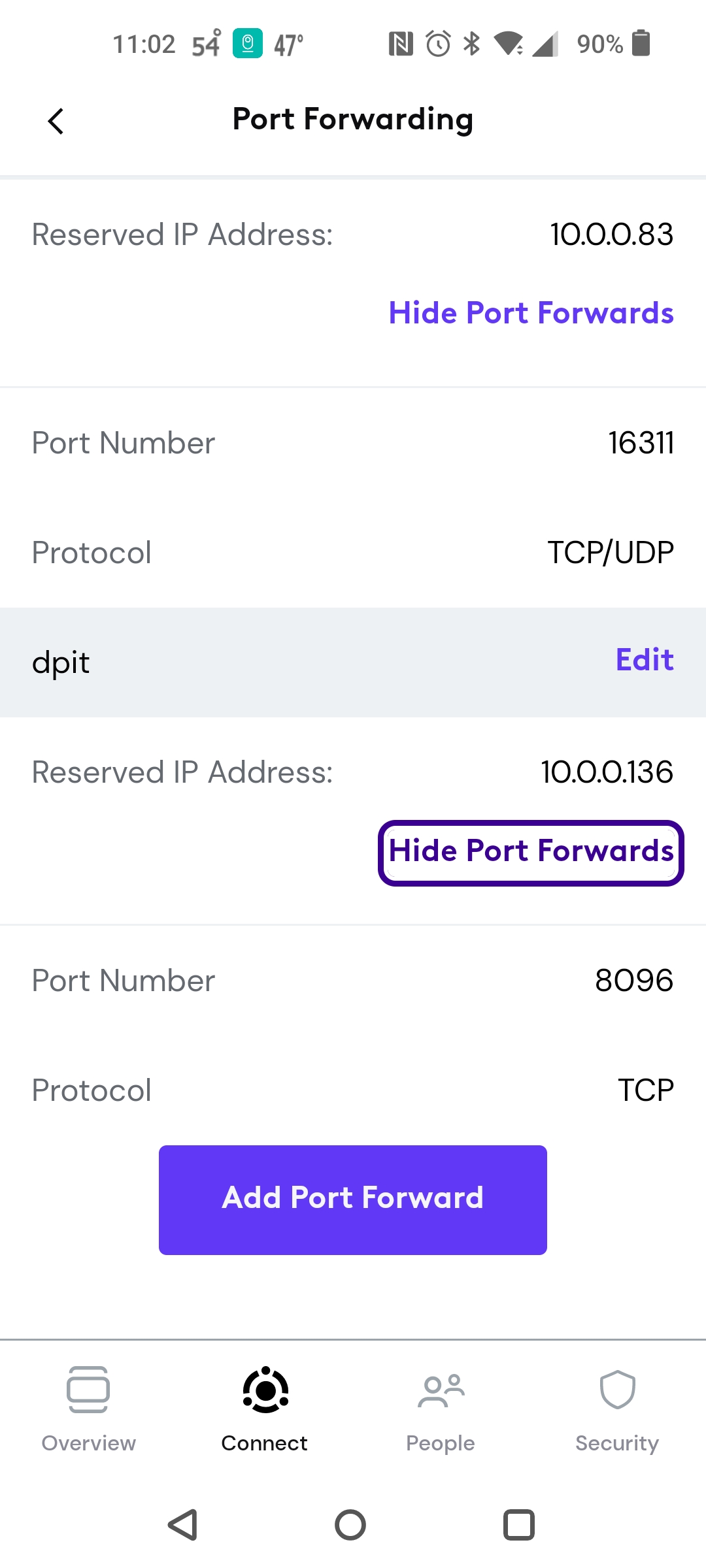

dalezjc 14 Posted December 5, 2022 Author Posted December 5, 2022 Here's a screenshot of the port forward info:
rbjtech 5345 Posted December 5, 2022 Posted December 5, 2022 if your emby server is 10.0.0.136 - then that should be ok. Plex is on 10.0.0.83 - either a different machine or different IP yes ?

Luke 42290 Posted December 7, 2022 Posted December 7, 2022 On 12/5/2022 at 3:47 PM, dalezjc said: Yes, my Emby server is .136. Is this a different machine then Plex?
