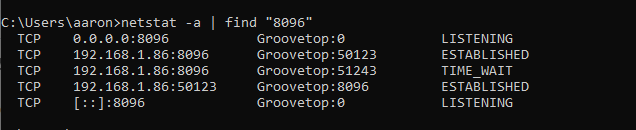

rbjtech 5345 Posted November 30, 2022 Posted November 30, 2022 11 hours ago, Karidemus said: You are correct, my emby server is 192.186.1.86. When I tried the command prompt I got the following: ok good - I know it's now solved (and emby config problem) but you should see your connections/devices appear in this list (as established). It also proves that emby is 'listening' on the correct port. Turning off your firewall would have made no difference, because it wasn't the issue - the emby config was that Happy identified above. tbh, I was not aware that emby config in the xml even existed - so a useful post. Enjoy ! 1
