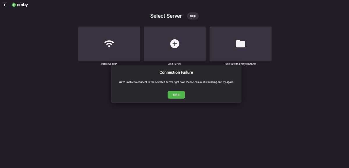

Karidemus 1 Posted November 29, 2022 Posted November 29, 2022 (edited) Hello, I am struggling with connectivity issues. I was using Emby and it was working fine, but recently *something* has changed and now I cannot connect to my locally hosted server through any devices on the network. I get the Connection Failure setting, saying it is unable to connect to the selected server. I have followed the connectivity guide. My devices can see my home server, but can't connect. https://support.emby.media/support/solutions/articles/44001849007-connectivity When I try inputting the local ip address into a browser on my phone or tablet, it won't connect. I forwarded the TCP ports on my computer, and ensured they are the ones selected in the server. I have no VPN running, and I have also ran a virus scan and my system is clean. I am honestly just stumped as to what is going on. If I try remote connections using Emby connect that also fails. I am using Emby 4.7.10, and I am trying to connect with my Smart TV, android phone/tablet, and Windows PCs, and none of them can connect. Please help if possible! embyserver.txt Edited November 29, 2022 by Karidemus Adding logs.

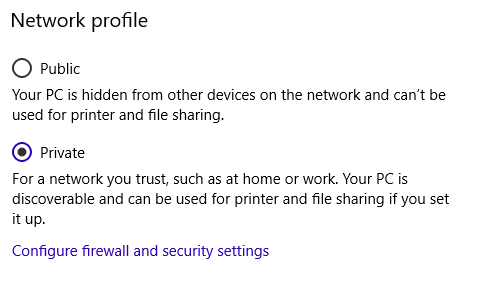

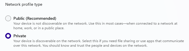

rbjtech 5345 Posted November 29, 2022 Posted November 29, 2022 (edited) 1. Check the LAN/network in Windows is 'Private' and not 'Public' In win11 - it looks like this - in win10 - 2. Check the Firewall has ports opened - temporarily turn it off to check. Edited November 29, 2022 by rbjtech
Karidemus 1 Posted November 29, 2022 Author Posted November 29, 2022 My network is set to private, and I have the ports forwarded. What is odd is that even with the firewall off, I still can't connect with devices on the local firewall.

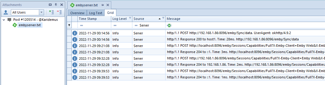

rbjtech 5345 Posted November 29, 2022 Posted November 29, 2022 According to your log - the server is responding to http POST requests .. So as long as the other devices are on the 192.168.1.x subnet and have 192.168.1.x Ip addresses - then they should work ok .. (standard /24 network is presumed here ..) You emby server is 192.168.1.86 correct ?

Karidemus 1 Posted November 29, 2022 Author Posted November 29, 2022 Ive tried both the app, and also using just the server ip on google chrome browser. The app can see the server but wont connect, and the browser just times out.

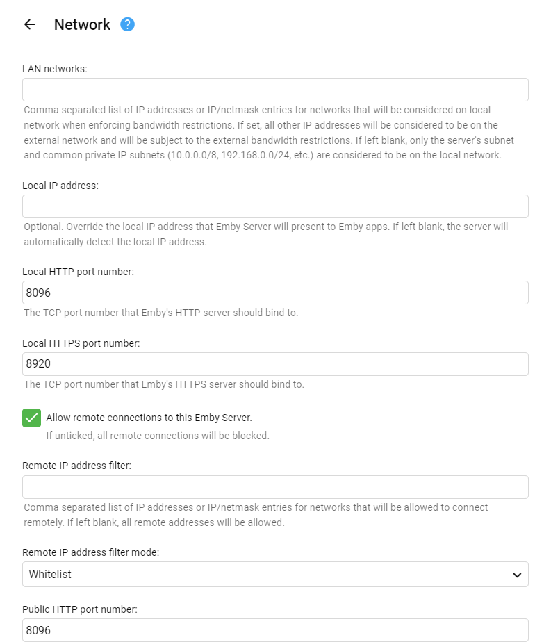

Luke 42290 Posted November 29, 2022 Posted November 29, 2022 Have you configured any settings in the Network section of Emby Server? If so, what?
Karidemus 1 Posted November 29, 2022 Author Posted November 29, 2022 No changes to network setting, most fields are empty.
Luke 42290 Posted November 29, 2022 Posted November 29, 2022 OK, that's a tough one. Clearly something is blocking the connection, the question is what. You could always try a different internal port and see if that makes a difference.
Happy2Play 9814 Posted November 29, 2022 Posted November 29, 2022 Can you provide a server log after a restart as it will show network detection. Port Mapper is flooding your log, so would suggest is disabling via Networks page or uninstalling the plugin. Also using your Forum info I see Emby port is open and Remote access is working.
Karidemus 1 Posted November 29, 2022 Author Posted November 29, 2022 I disabled Port Mapping and uploaded the server log, hopefully that helps. I tried some different ports, but that did not seem to help, unless there is a particular TCP port you would recommend.embyserver.txt

Luke 42290 Posted November 29, 2022 Posted November 29, 2022 6 minutes ago, Karidemus said: I disabled Port Mapping and uploaded the server log, hopefully that helps. I tried some different ports, but that did not seem to help, unless there is a particular TCP port you would recommend.embyserver.txt Looks like you did not change the port: Quote 2022-11-29 15:45:04.240 Info App: Adding HttpListener prefix http://+:8096/
Karidemus 1 Posted November 29, 2022 Author Posted November 29, 2022 Oh sorry I did, but then I worried I wasnt using the right port (I just picked a number one off from the standard) and switched it back. I can switch and try again.

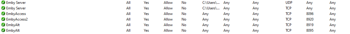

Karidemus 1 Posted November 29, 2022 Author Posted November 29, 2022 Here is the server log information with the new ports. embyservernewport.txt Here is a screen snip of the server rules. With the old TCP and the new ones.
