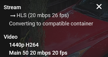

JuiceBoxDrinker 4 Posted December 1, 2022 Author Posted December 1, 2022 Oh okay cool, well right now I just have a single rtsp stream in m3u file being played through live tv (m3u tv tuner?) STATS on Emby Camera Video Config And that is proof it works as H264, its an Annke C500 if that helps. I changed to h265 and it acted differently this time, where last time it simple said the streams was incompatible or something. Now it seems to load infinitely. ffmpeg-remux-8e3f923e-1d78-457a-90cc-ebd508c2f5e1_1.txt I see this is the log 19:19:00.529 [rtsp @ 0x33cdf210] Multi-layer HEVC coding is not implemented. Update your FFmpeg version to the newest one from Git. If the problem still occurs, it means that your file has a feature which has not been implemented. As well in the beginning I can see inside the http address that both 264 and 265 are included, not sure if its supposed to say rtsp instead ? In case it matters this is the contents of the m3u file. #EXTINF:-1 group-title="Cam",Camera 1 rtsp://admin:Cj7190[]@192.168.0.82:554/Streaming/Channels/101/?transportmode=unicast.sdp I restarted the both the camera and the server to no avail. As well I removed everything after the port number in the url also without luck. I'm not too concerned about this issue since one form works, but I am curious so feel no obligation ahaha. Also I seem to be in a different time zone so sorry for the delays inbetween my update Thanks in advance
