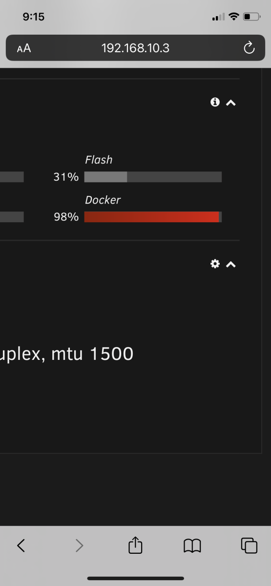

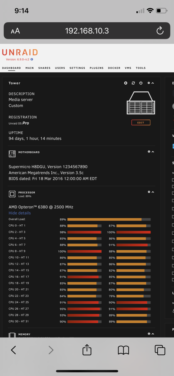

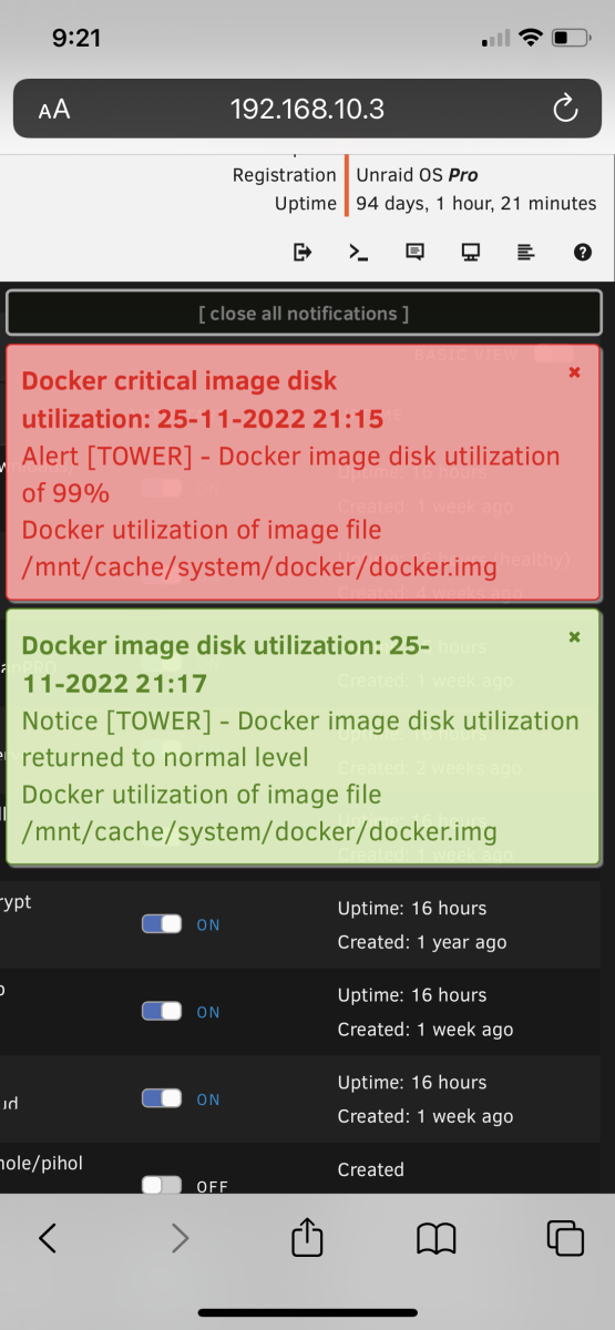

Spyderturbo007 19 Posted November 26, 2022 Posted November 26, 2022 (edited) @PaulE123 You’re not the only one having this issue. I’ve narrowed it down to Emby as well and I can almost reproduce it. It’s always related to me trying to move through a video too quickly. It’s weird because I’m not even transcoding, just direct play. I’ve been in the server when it says it’s at 99% and when I open the container size it’s normal. unRAID showed me that my docker RAM usage was at 99% when it was happening. Another thing I’ve noticed is that it seems to correspond to Emby showing that it’s streaming a movie but it isn’t. I stop playing the movie on the shield, but but Emby says it’s still streaming. I’m on my phone so I can only upload a few screenshots which probably aren’t helpful. I can post more detailed information when I’m at a workstation. Edited November 26, 2022 by Spyderturbo007 1

Spyderturbo007 19 Posted November 27, 2022 Author Posted November 27, 2022 Hi @Luke Here is what I did to get the log file. 1. Stopped and started the Emby docker container 2. Rebooted the Shield 3. Rotated the log file 4. Began playback of a movie named Black Friday. Stats for nerds showed Direct Play. 5. Used the skip forward button a bunch of times after the movie started playing. This causes the video to freeze for ~2 minutes while the CPU utilization goes through the roof (all attributed to Emby) and the docker image generates the error below. 6. When the movie started playing again it showed that it was transcoding for some reason. 7. I then exited the movie. Within a minute or two I received the message "Docker utilization returned to normal" message from my server. Event: Docker critical image disk utilization Subject: Alert [TOWER] - Docker image disk utilization of 99% Description: Docker utilization of image file /mnt/cache/system/docker/docker.img Importance: alert embyserver.txt 1
