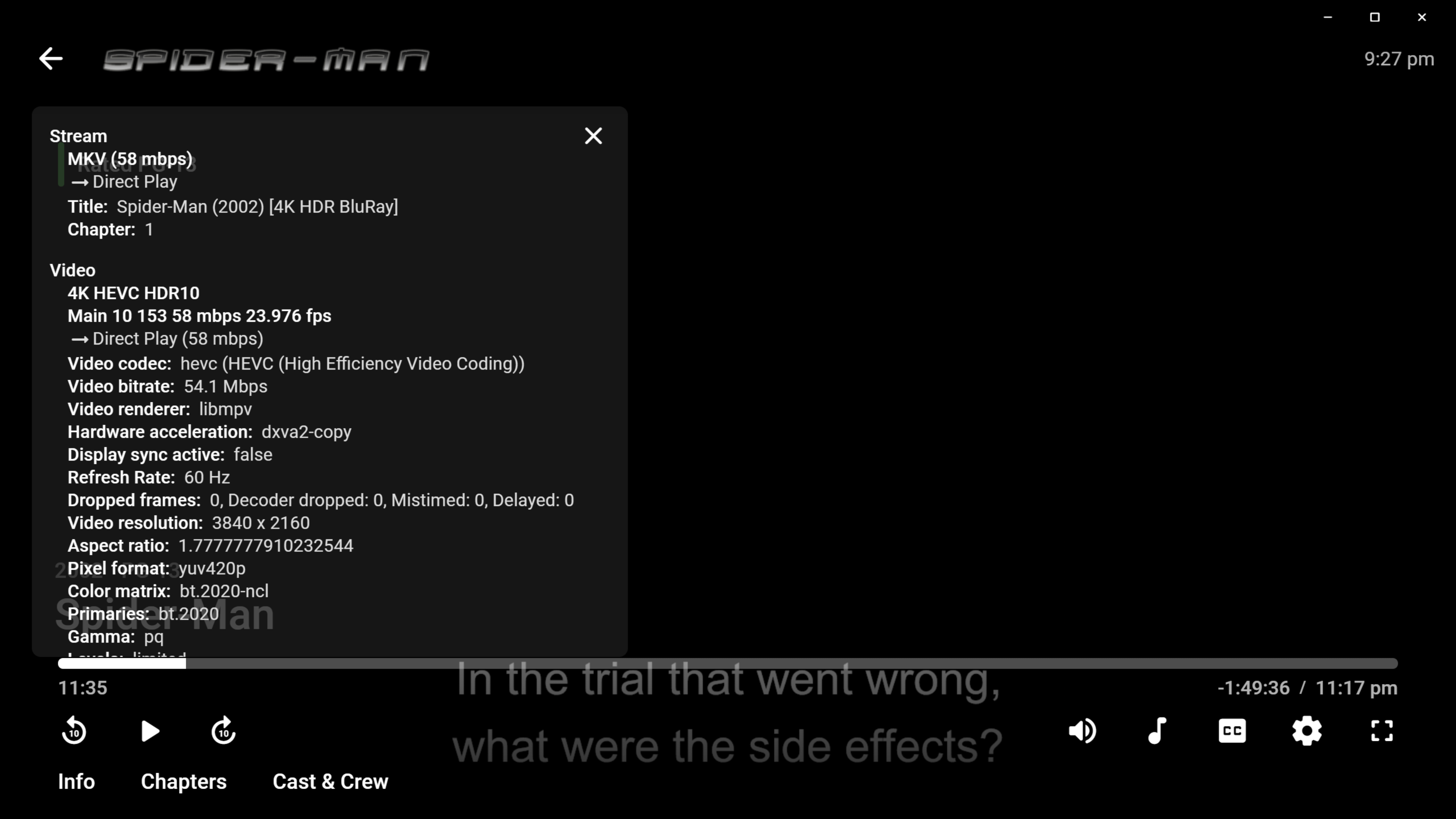

Guest Posted December 2, 2022 Posted December 2, 2022 Yeah, you're both using libmpv, the 'auto' option. Try changing it to gpu-next. It's the first drop down in the video settings.

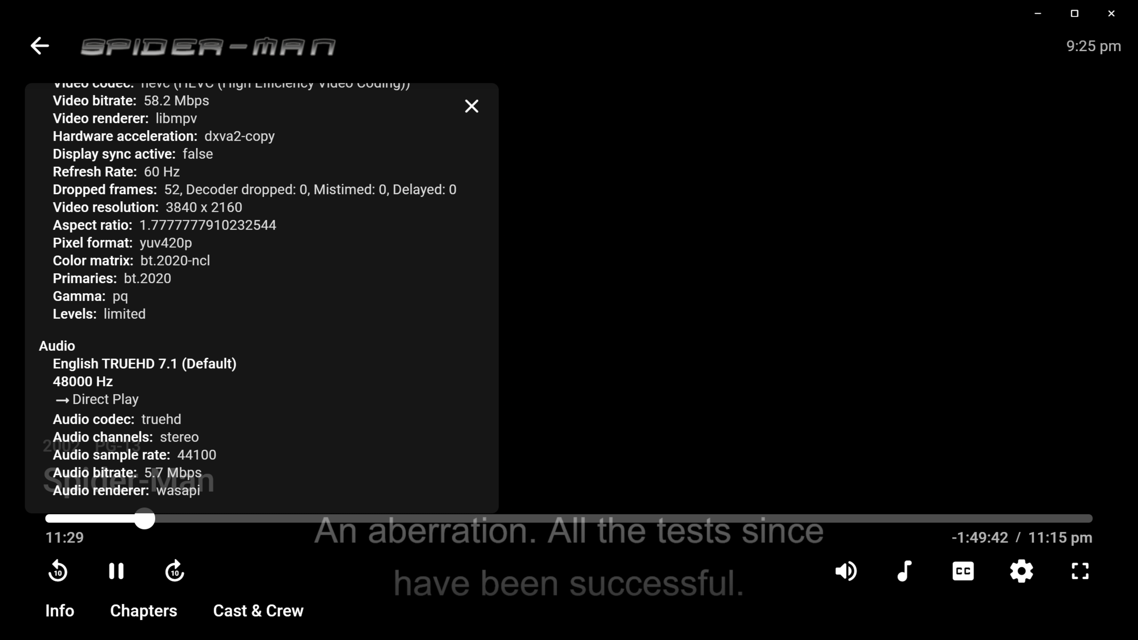

Guest Posted December 2, 2022 Posted December 2, 2022 (edited) For all concerned, when using libmpv in Theater, HDR passthrough is not possible. It will force hardware acceleration copyback. This doesn't support HDR passthrough. Correct playback will fail. You should use 'gpu-next' as the renderer. Edited December 3, 2022 by generiq
Dizzy49 99 Posted December 2, 2022 Posted December 2, 2022 29 minutes ago, generiq said: Yeah, you're both using libmpv, the 'auto' option. Try changing it to gpu-next. It's the first drop down in the video settings. That's it. Working for both files now!

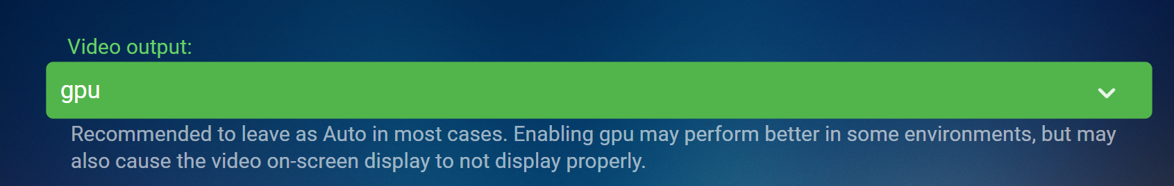

iamneo 3 Posted December 2, 2022 Posted December 2, 2022 Making the change worked for me... does the warning "Enabling gpu may perform better in some environments, but may also cause the..." no longer apply...? For me I prefer OOTB working right away. Expecting those who watch my server to change this setting using the theater app, is next to impossible. LOL thanks for this solution though as it does work with me as well. Stan...

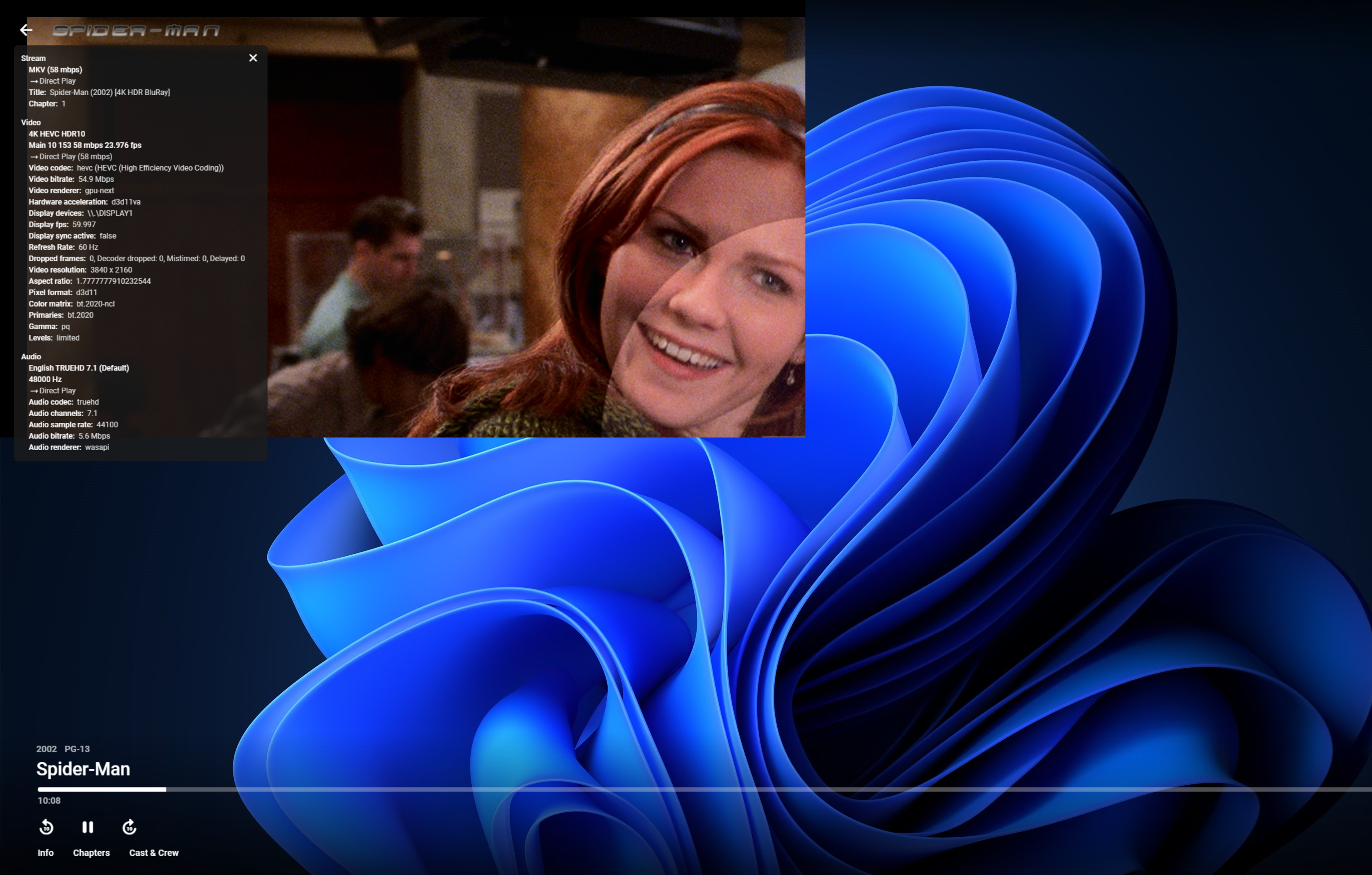

xRodin 0 Posted December 3, 2022 Posted December 3, 2022 Using gpu-next or gpu results in a 1080p viewport on my 4K monitor?

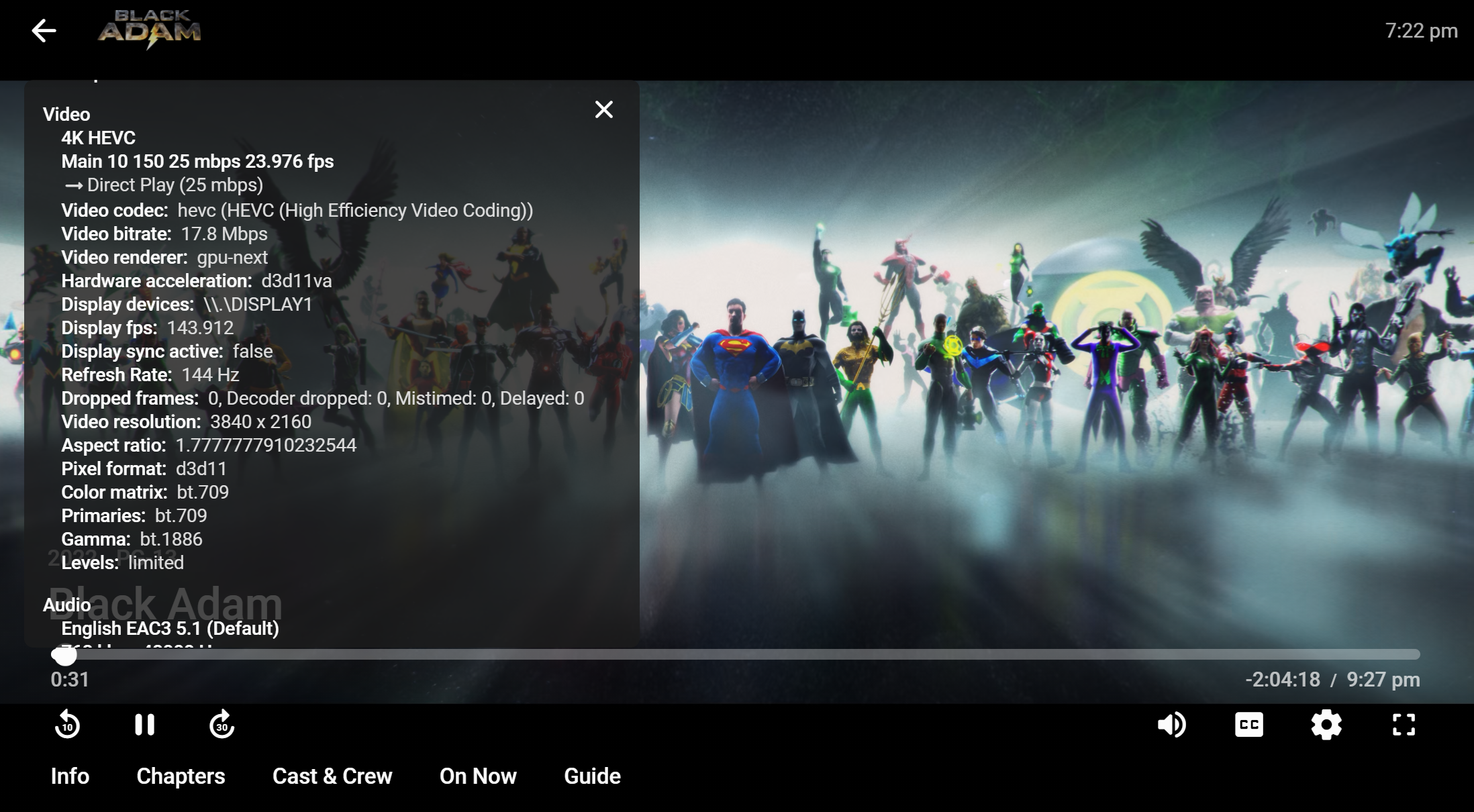

Lag1791 1 Posted December 3, 2022 Posted December 3, 2022 So I just tried the lastest. Selected GPU Next and everything is working for me now. Full 4k playback HEVC w/HDR and ATMOS passthrough to my reciever.

iamneo 3 Posted December 4, 2022 Posted December 4, 2022 55 minutes ago, Luke said: What about leaving the renderer on auto instead? If by renderer you mean "Video Output", if left to auto, you will get the error message that started this whole thread

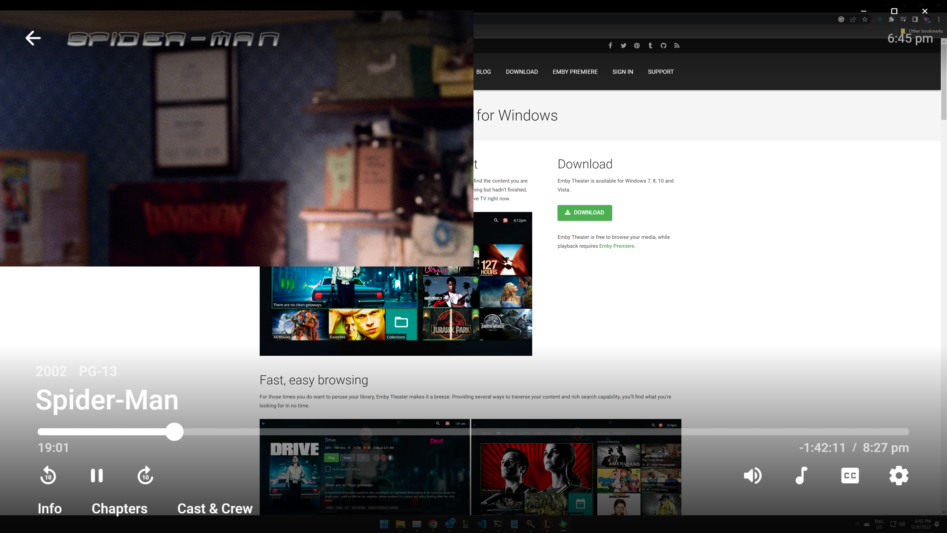

xRodin 0 Posted December 8, 2022 Posted December 8, 2022 @LukeI am still seeing issues with v3.0.18. With the video playback set to auto I can now hear the audio of the media but I cannot see anything. This is 4K HDR source playing on a 4K SDR display, so there is tone mapping. Setting video playback to gpu-next causes the same viewport issue I posted earlier. Here are the server logs: https://1drv.ms/u/s!Am62AlYw6ZI2h8EVQmCeyp4LGHHx9g?e=Nk6z81 embyserverlogs.zip

xRodin 0 Posted December 8, 2022 Posted December 8, 2022 @Luke @generiq, I am using the gpu-next option in the video output setting under the video menu, I don't see a video renderer option. I am not using any scaling options in app or the windows dpi settings. Everything is default except the video output. v-3.0.19 from the website has the same issue but interestingly the portable version from github works fine? Even version 3.0.18 from github works fine but neither of the ones installed from the website worked for me... I guess I'll keep using the github version for now. Let me know if you want more data v-3.0.19 from website with gpu-next: v-3.0.19 from github with gpu-next:
xRodin 0 Posted December 9, 2022 Posted December 9, 2022 Some additional info, using v-3.0.17 from github has the same error that started this whole thread when using the "auto" video output option, but using gpu-next makes it work fine.
Luke 42237 Posted December 9, 2022 Posted December 9, 2022 22 minutes ago, xRodin said: @Luke @generiq, I am using the gpu-next option in the video output setting under the video menu, I don't see a video renderer option. I am not using any scaling options in app or the windows dpi settings. Everything is default except the video output. v-3.0.19 from the website has the same issue but interestingly the portable version from github works fine? Even version 3.0.18 from github works fine but neither of the ones installed from the website worked for me... I guess I'll keep using the github version for now. Let me know if you want more data v-3.0.19 from website with gpu-next: v-3.0.19 from github with gpu-next: They're the same thing. The installer doesn't have anything built in, so it just downloads the portable and then unpacks it.

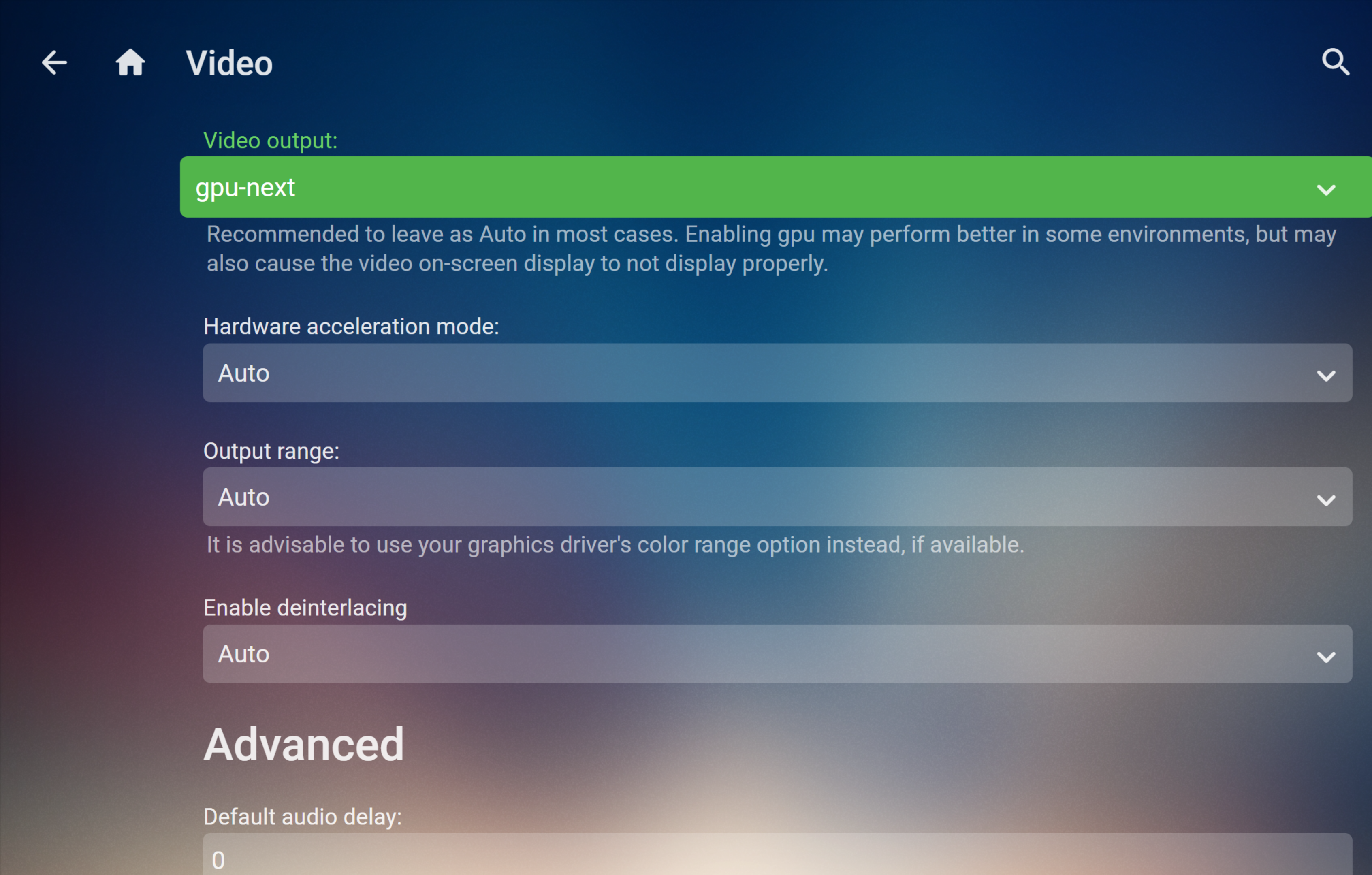

Luke 42237 Posted December 9, 2022 Posted December 9, 2022 Quote I don't see a video renderer option Where are you looking for it?
xRodin 0 Posted December 9, 2022 Posted December 9, 2022 @LukeI don't know what to tell you, I uninstalled the version from the website and selected the "remove all trace" option, reinstalled it, and the same issue occurs with the gpu-next video output setting. This issue does not occur with the github version. I don't see a video renderer option anywhere in the theater settings. Where can I find it? This is what my video section looks like:
Luke 42237 Posted December 9, 2022 Posted December 9, 2022 It's that video-output option. Sorry I had my wording wrong.
