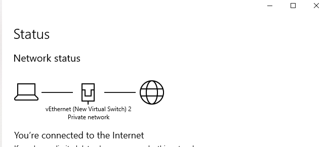

Goose48 2 Posted November 22, 2022 Author Posted November 22, 2022 Here is a screen shot of my Network & Internet

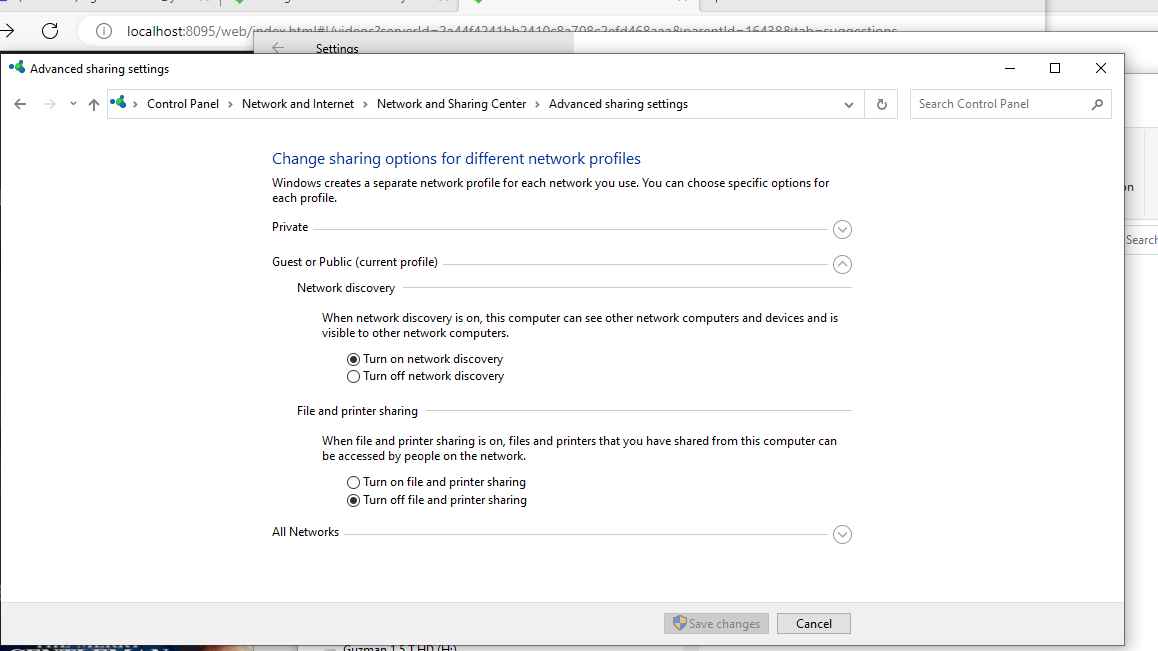

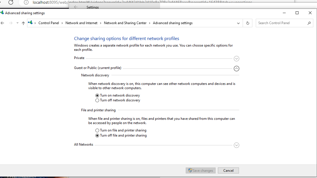

Goose48 2 Posted November 22, 2022 Author Posted November 22, 2022 All my Rokus are working and have excellent wifi reception since I installed the new router. Get every app perfectly. Netflix, Prime, HBO Max look and sound great. Just checked my Network & Internet-Ethernet and notice Public has Network discovery open. Could this be the issue? Again, I thank all of you.

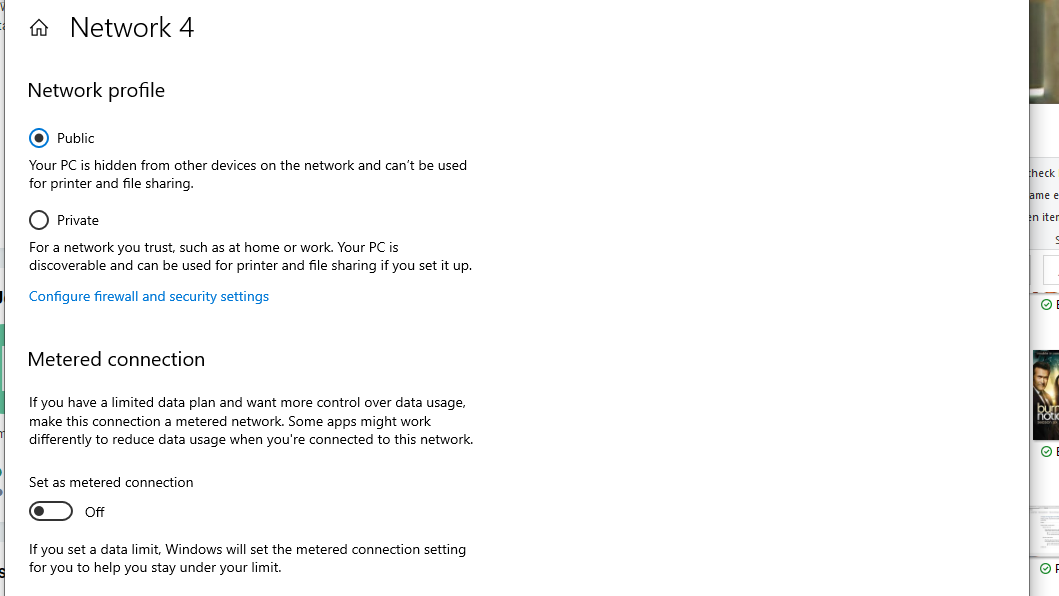

Goose48 2 Posted November 22, 2022 Author Posted November 22, 2022 Just found this. Is This the root of my problem?
Happy2Play 9800 Posted November 22, 2022 Posted November 22, 2022 @Goose48 Yes as the firewall rules should be for Private network. I would change that to Private.
Goose48 2 Posted November 22, 2022 Author Posted November 22, 2022 I will change. What about the other Control Panel Public and Private-Turn on network discovery button? They are both on. Should I change Public to-Turn off network discovery? Once all changes are done do I need to restart my computer? Happy2Play, I thank you for your assistance. And all the others who help, thank you and have the best of holidays.
ebr 16307 Posted November 22, 2022 Posted November 22, 2022 9 hours ago, Goose48 said: Just found this. Is This the root of my problem? Yep, that's exactly what I suspected. Change that to Private and everything will probably start working.
Goose48 2 Posted November 22, 2022 Author Posted November 22, 2022 Absolutely correct. Everything is up and running. All my Tvs are connected and the Emby app is working. Again thank you all
