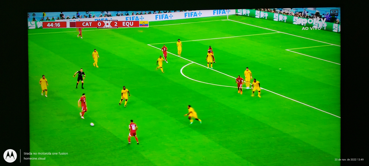

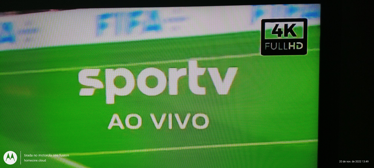

Guest Posted November 20, 2022 Posted November 20, 2022 Hi, Right now watching the Emby app for LG 4K TV, webOS 22, in perfect 4K, from the beginning of the opening game of the World Cup.

ShoutingMan 101 Posted November 21, 2022 Author Posted November 21, 2022 7 hours ago, CarlosLima said: Hi, Right now watching the Emby app for LG 4K TV, webOS 22, in perfect 4K, from the beginning of the opening game of the World Cup. How? Is there some setup in the Emby app or Emby server? Do I need a new / faster server? I've got a 2016 HTPC based on a Intel i5 Skylake CPU. It uses its integrated GPU, but I don't transcode anything. Everything is gigabit ethernet network, and I expect full bitrate streaming no transcoding to lower quality.
