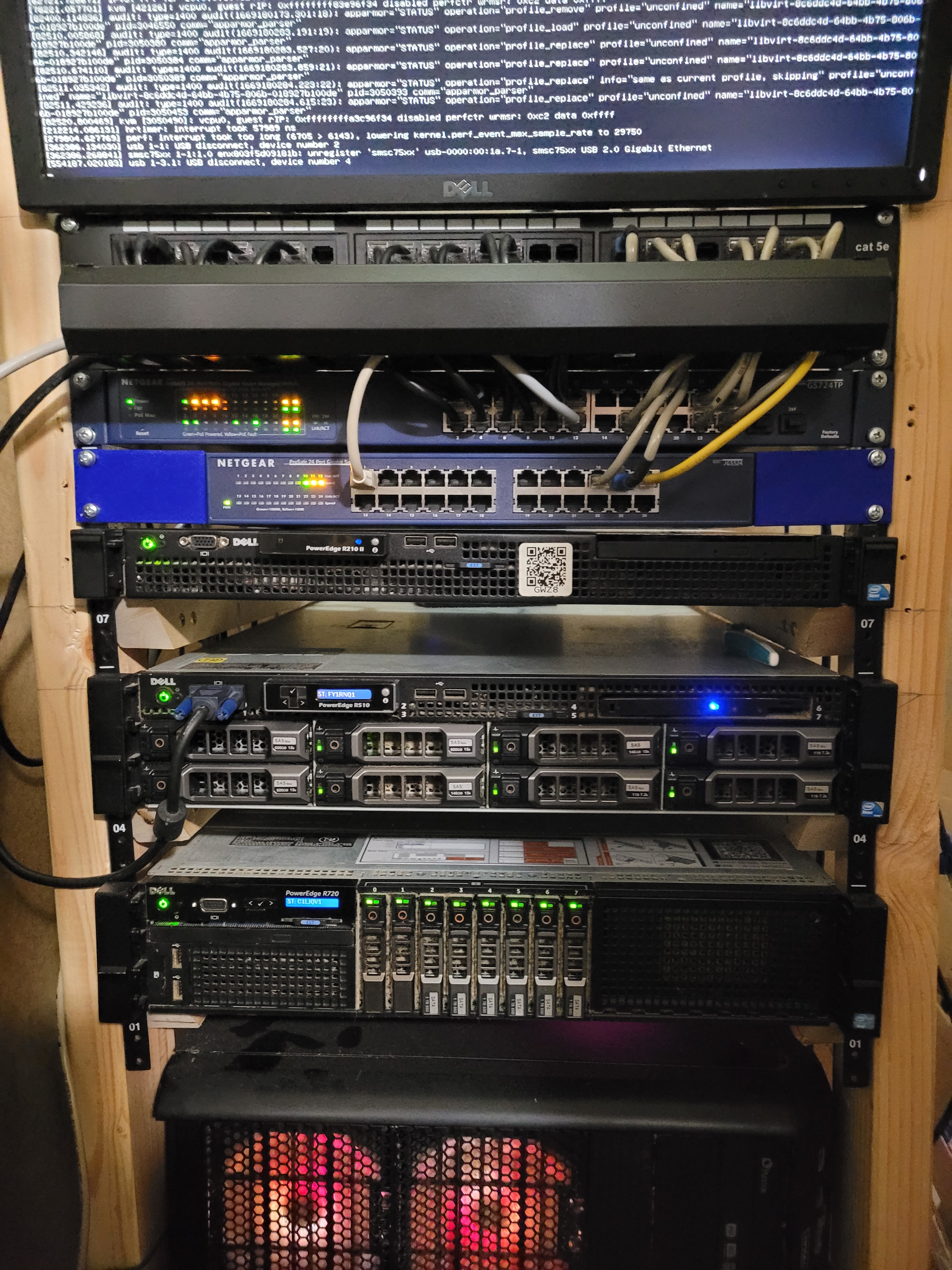

SDHoover 1 Posted November 28, 2022 Author Posted November 28, 2022 @Lukenope, I keep my LAN IP's reserved in my firewall. I use a PF Sense and have the Emby servers MAC assigned to the IP so it doesn't change. Emby servers running on a TrueNAS Scale system as an app (Their version of Docker) Kubernetti I can't remember. It's on a Dell R720 Server, dual processor, 64GB DDR3 Ram.
