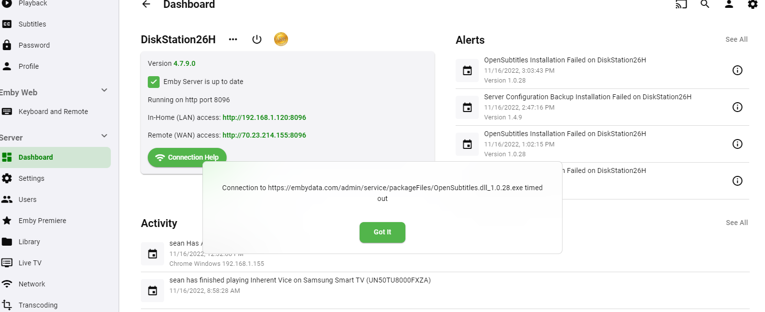

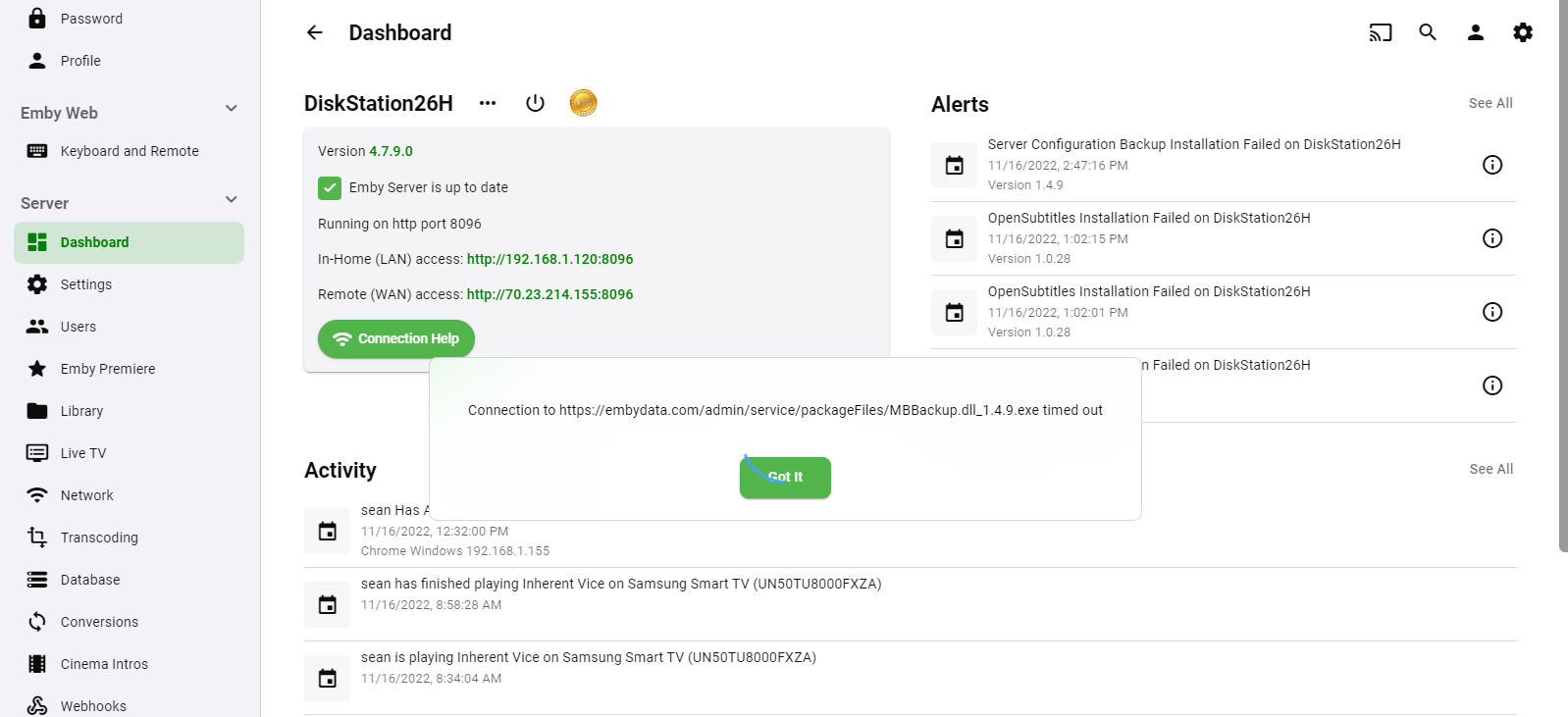

ceczar 0 Posted November 16, 2022 Author Posted November 16, 2022 there's something weird also going on just with the plugin page, i've waited several minutes for this screen to load several different times in the past couple of hours but eventually I get there, and here is me installing it but here is it not actually installed I have had this same issue with different versions of OpenSubtitles, as well as other plugins (such as ConfigurationBackup) embyserver.txt I have also uploaded a log file. perhaps Emby changed the way it communicated and i need to change my port forwarding configuration from what worked before?

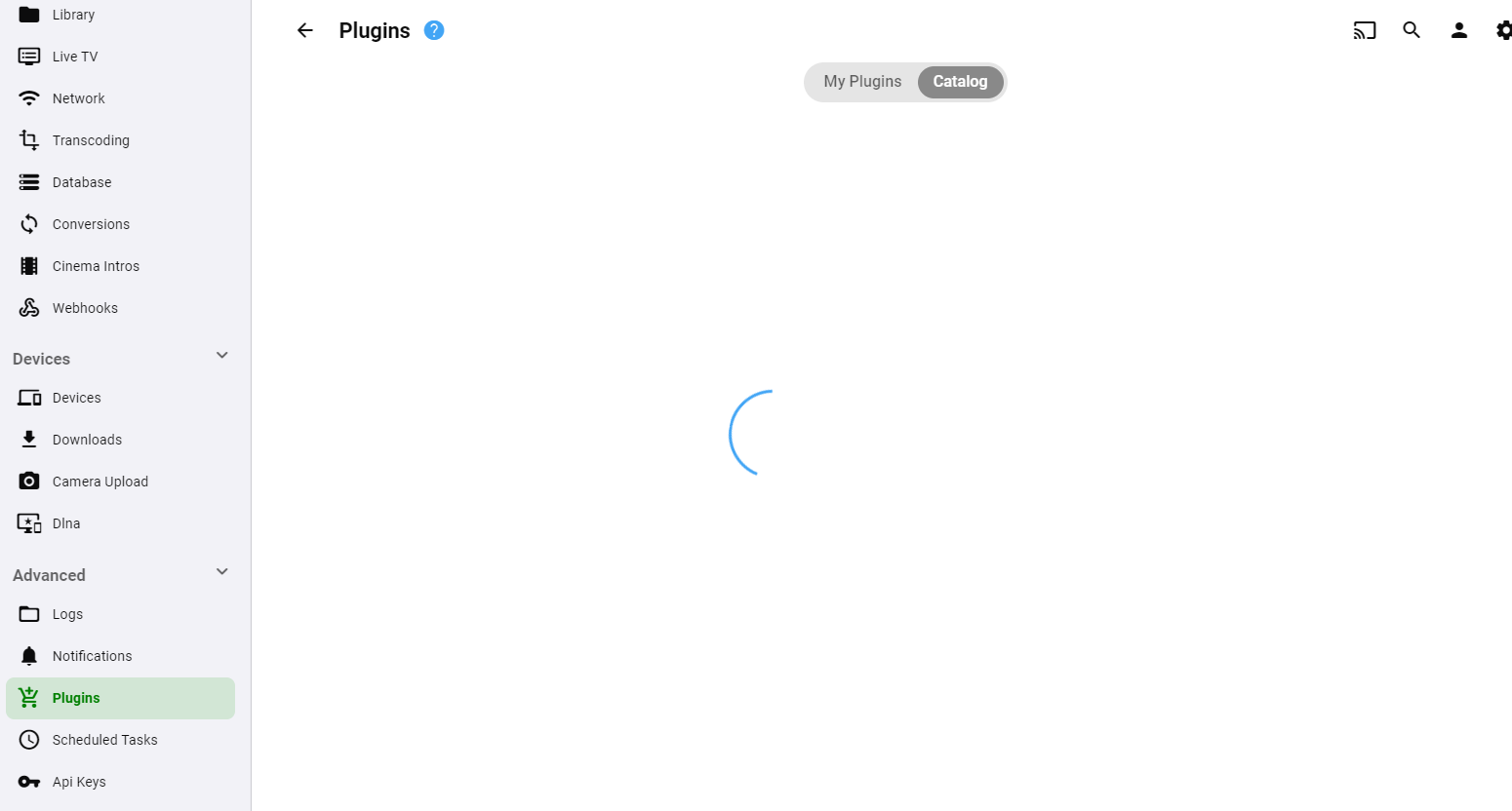

ceczar 0 Posted November 16, 2022 Author Posted November 16, 2022 (edited) I just tried again and 5 minutes later it's still a swirling blue circle. there must be something being blocked, but everything else works Edited November 16, 2022 by ceczar
