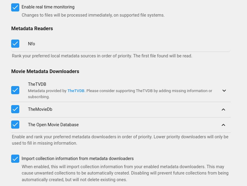

Happy2Play 9812 Posted November 14, 2022 Posted November 14, 2022 (edited) Will need specifics, what is missing? Also need sever log for a specific example to possibly see why information is missing. What are you user controls settings? It should fall back to other providers but TVDB does not have a US content rating for Fast and Furious. Personally would make TMDB first provider. Edited November 14, 2022 by Happy2Play

bigverm23 2 Posted November 14, 2022 Author Posted November 14, 2022 10 minutes ago, Happy2Play said: Will need specifics, what is missing? Also need sever log for a specific example to possibly see why information is missing. What are you user controls settings? It should fall back to other providers but TVDB does not have a US content rating. Personally would make TMDB first provider. took your advice here and re-ordered. Refreshing metadata on the library now.
