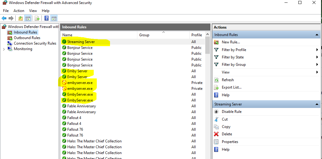

Pwignall 2 Posted November 14, 2022 Author Posted November 14, 2022 Thank you for the response. I tried that. It didn't work. See below for the experience. After adding the new rule to my firewall I went downstairs and opened the Emby App on ROKU and the screen has changed slightly. There is no longer an option for Emby Connect (PIN method) Now there are two options: 1. Install server manually 2. Sign out But I cannot see my movie library. I tried installing the server manually and it timed out again. Here is a screen shot of my firewall. It seems odd it has both my newly created rule and Emby services on there. Not sure if that is a problem.

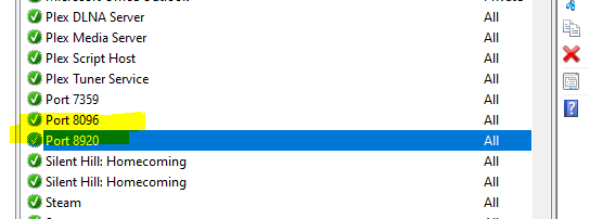

Pwignall 2 Posted November 14, 2022 Author Posted November 14, 2022 It looks like both ports were open on the firewall, now that I look more closely.
Solution ebr 16307 Posted November 14, 2022 Solution Posted November 14, 2022 Hi. It looks like you have block rules for embyserver.exe. Try deleting those.
Happy2Play 9800 Posted November 14, 2022 Posted November 14, 2022 1 hour ago, Pwignall said: Thank you for the response. I tried that. It didn't work. See below for the experience. After adding the new rule to my firewall I went downstairs and opened the Emby App on ROKU and the screen has changed slightly. There is no longer an option for Emby Connect (PIN method) Now there are two options: 1. Install server manually 2. Sign out But I cannot see my movie library. I tried installing the server manually and it timed out again. Here is a screen shot of my firewall. It seems odd it has both my newly created rule and Emby services on there. Not sure if that is a problem. What are your deny rules? As it would affect your Private network.
Pwignall 2 Posted November 14, 2022 Author Posted November 14, 2022 BOOM! That got it. Thank you! Odd that the .exe file is the issue. I thought that was just the installer so I didn't even bother with it. No matter what, I'm fixed and the Roku is streaming. Thank you!
