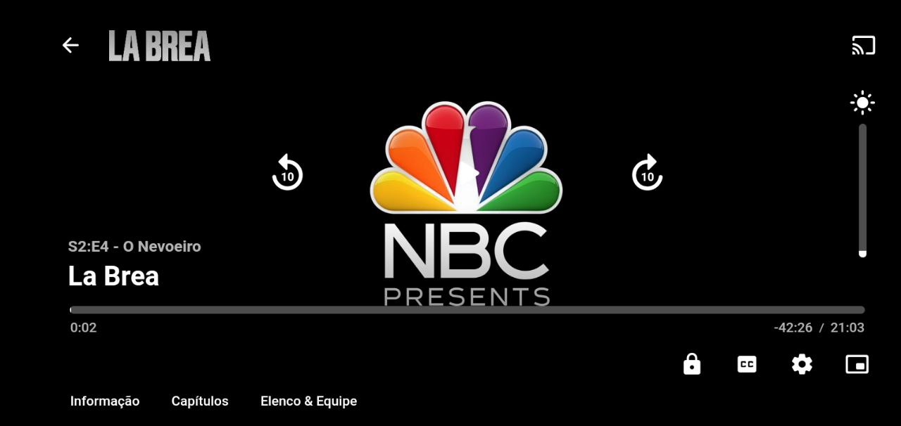

Marcserver 1 Posted November 20, 2022 Posted November 20, 2022 (edited) I have a similar problem. On my PC I can get the video content to play, but off the PC I can't for most content. This problem came up a few months ago. embyserver.txt Edited November 20, 2022 by Marcserver
Happy2Play 9811 Posted November 20, 2022 Posted November 20, 2022 @Marcserver This only matters if you have and a Nvidia GPU. If you don't this is a harmless error and can be ignored. But don't believe your issue belongs here as it potentially looks like a DLNA issue with the final error.
Marcserver 1 Posted November 20, 2022 Posted November 20, 2022 9 hours ago, Happy2Play said: @Marcserver This only matters if you have and a Nvidia GPU. If you don't this is a harmless error and can be ignored. But don't believe your issue belongs here as it potentially looks like a DLNA issue with the final error. I really don't know what this is about. I try to play on TV or cell phone and it doesn't work. I don't have a video card, but that didn't stop the service from working normally.
Luke 42243 Posted November 20, 2022 Posted November 20, 2022 4 hours ago, Marcserver said: I really don't know what this is about. I try to play on TV or cell phone and it doesn't work. I don't have a video card, but that didn't stop the service from working normally. @Marcserver Hi there, let's look at an example. Please attach the information requested in how to report a media playback issue. Thanks!
Marcserver 1 Posted November 20, 2022 Posted November 20, 2022 5 hours ago, Luke said: @Marcserver Hi there, let's look at an example. Please attach the information requested in how to report a media playback issue. Thanks! The only place I can reproduce it is on the pc where the server is. The others are in an infinite loading loop, play for 01 or 02 seconds and then no more. hardware_detection-63804571966.txtffmpeg-remux-adea0673-9ef6-4aa6-991f-6a134c27b42a_1.txtembyserver.txt
Marcserver 1 Posted November 21, 2022 Posted November 21, 2022 I was able to resolve the issue by running a malware scan and resetting the firewall settings. 1
