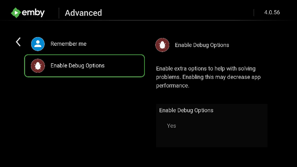

speechles 2062 Posted November 15, 2022 Posted November 15, 2022 (edited) Inside the Roku application settings inside "Advanced" you will find the option. Enable it. Once enabled you must exit and restart the application for it to produce the "Send Log" option on the homescreen correctly. Once you restart the application it will appear as the option to "Send Log" under your user options. When you send the log via the Roku application it connects directly to the Emby central debug server to store your Log. You need to also tell us the "Username" of the user logged in at the time you sent the log and the time in ET ( Eastern Time/USA, GMT -5 ) you sent the log and that should be enough. Thank you. Edited November 15, 2022 by speechles
