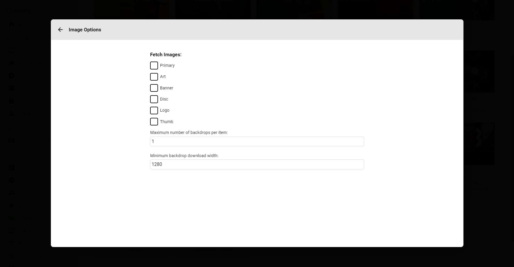

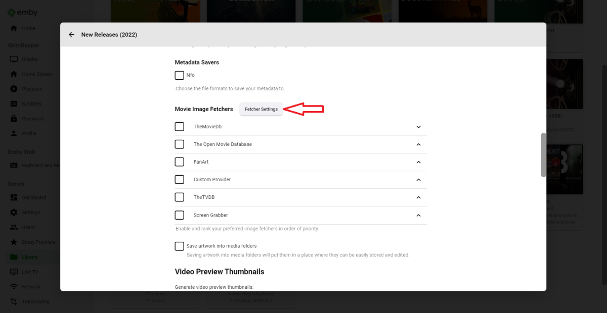

GrimReaper 4851 Posted November 10, 2022 Posted November 10, 2022 (edited) Library setting, Image Fetchers section, "Fetcher settings", select type of artwork do be downloaded. Edited November 10, 2022 by GrimReaper
HawkXP71 112 Posted November 10, 2022 Author Posted November 10, 2022 6 minutes ago, GrimReaper said: Library setting, Image Fetchers section, "Fetcher settings", select type of artwork do be downloaded. Thanks! Dont know if thats the issue, but once my current scan is done Ill kick an update again to see.
