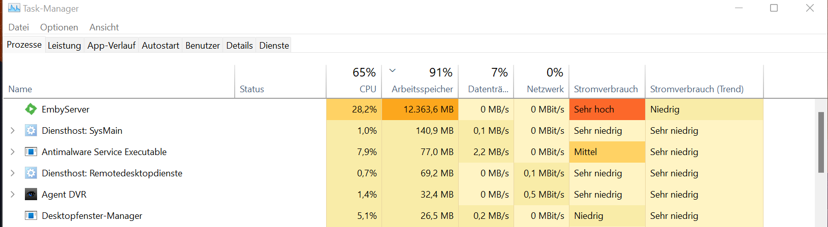

Flieger42 1 Posted November 29, 2022 Posted November 29, 2022 So I´m running 4.7.10 fresh installed yesterday on a win11 (server). Have the same problem of filling the RAM above 90% when scanning Photo-Library. Is it possible to upgrade to a beta to get rid of this issue?
Luke 42289 Posted November 29, 2022 Posted November 29, 2022 45 minutes ago, Flieger42 said: So I´m running 4.7.10 fresh installed yesterday on a win11 (server). Have the same problem of filling the RAM above 90% when scanning Photo-Library. Is it possible to upgrade to a beta to get rid of this issue? Hi, yes, instructions can be found here: https://emby.media/windows-server.html Thanks. 1
Flieger42 1 Posted November 29, 2022 Posted November 29, 2022 Ok. installed 4.8.0.19 Beta and it worked! Thanks. 1
