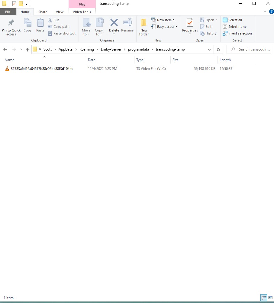

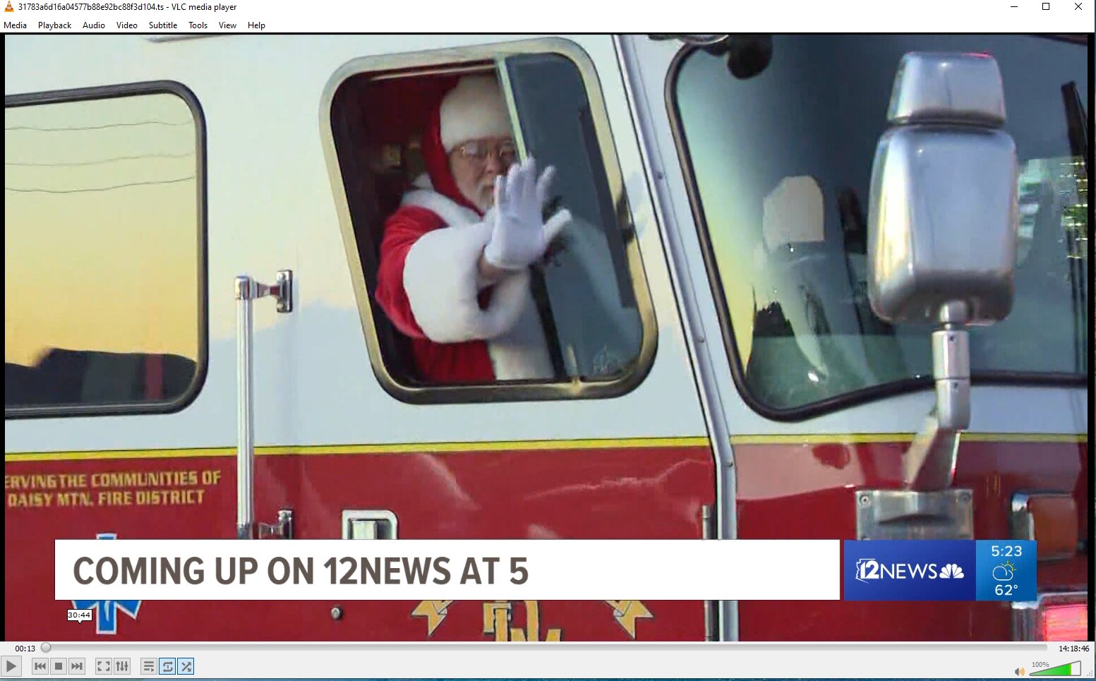

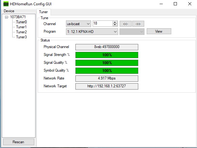

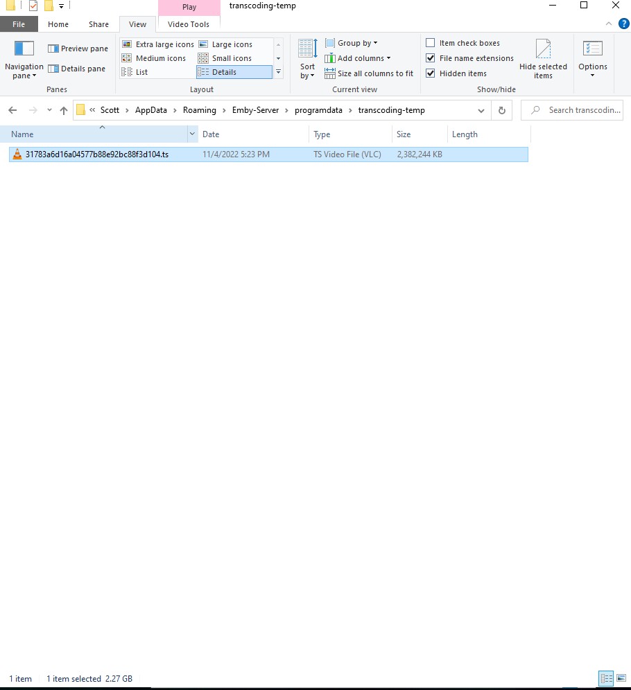

Scott D 69 Posted November 5, 2022 Posted November 5, 2022 5:23 pm 11/4 Brad starts playing KPNX on Roku device 6:00 pm 11/4 Brad stops playing KPNX on Roku device 7:52 am 11/5 During my daily checkin and reboot to clear temp files, I find 2.4 gig temp file. Checked tuner status and find KPNX still open. Opened temp file in VLC and see that it started at 5:23 pm (based on time/temp display in video) Duration of video is in excess of 14 hours. See attached log files. Windows 10 Home ver 22H2 Emby 4.7.8.0 HDHomeRun HDHR5-4US FW: 20221031 Roku 4.0.69 embyserver-63803203200.txt ffmpeg-transcode-6b86c5e7-ed1c-4a03-b60a-fcfc36ccf833_1.txt 1
Scott D 69 Posted November 5, 2022 Author Posted November 5, 2022 CORRECTION - Temp file was in excess of 56 gig once the stream was closed. 1
